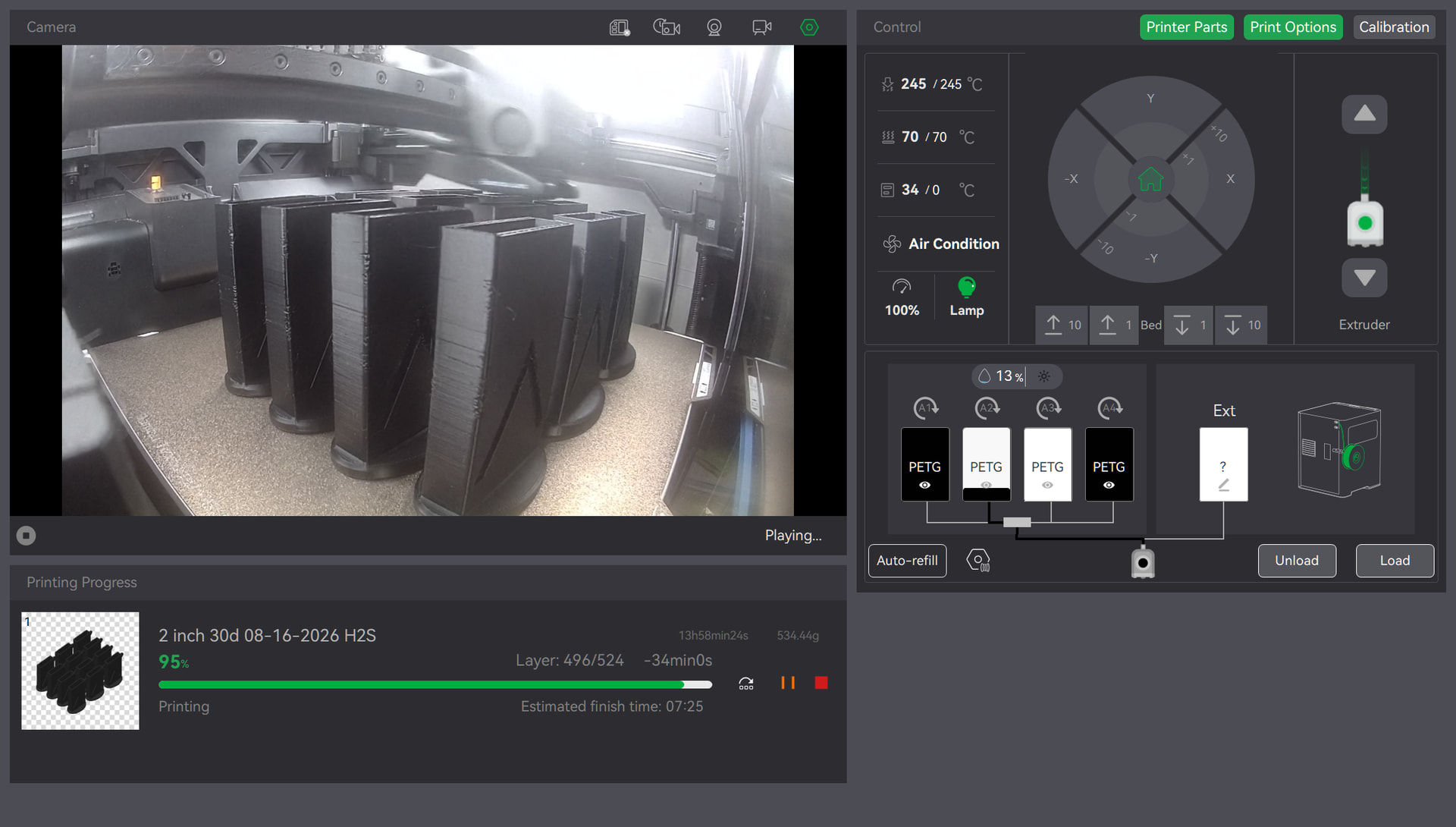

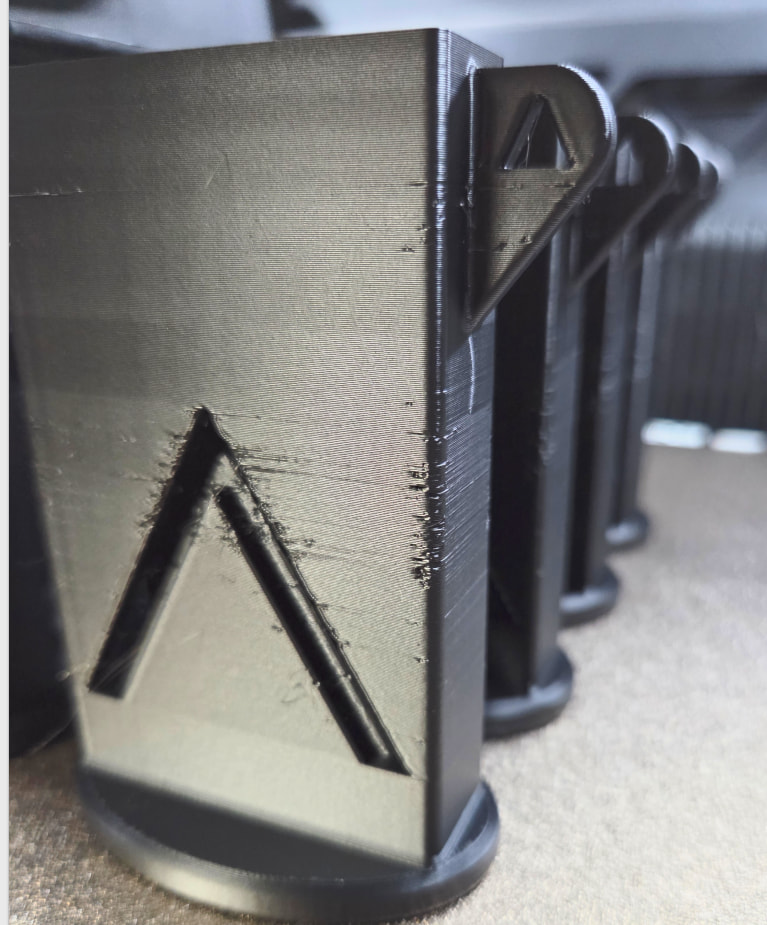

I don't get it, any ideas?
I have been printing these part for almost a year and am just having trouble doing them on my H2S.
If I print just 1, it comes out good. I have printed a few plates and most come out like this.
I figured the nozzle, since I recently printed some PHAT-CF, so I changed to a new nozzle. I am using PETG-HF and have been for a few years. Also, with the filament, I always dry in a Creality SpacePi for at least 8 hours, but typically 24 hours. Also, this it my 3rd for 4th spool, but have also been using this black for a couple years.
Before this last plate, I ran the complete calibration, just to make sure. But the previous plate wasn’t as bad, I don’t get it?
Other than doing a run out of a different color and filament, I’m at a loss, although it does look like a wet filament thing?
Any help from the veteran printers out there would be greatly appreciated.
Thanks,
Paul
I’ve run into this problem before when trying to print multiples and what I found was that the models were cooling more as layer times were much longer and there were more surface defects as the nozzle was entering/exiting between the parts. That said, if the parts were printing in multiples without issues before it would point more to a filament issue? Also, are you reslicing the parts or using already run gcode from previously know good multiple prints?

Good question on the slicing. I was using the same sliced G-code as prevoius good prints. Then I decided to re-slice to see if that would solved it and it didn’t.
My next step is to use a different, known good material and see what happens. But as I mentioned, I went through a few different spools with the same result, although they were all black petg-hf from BL, so maybe a bad batch? IDK :person_shrugging:

I would say wet filament, but you said its dried, I dont know. the background is out of focus but appears like all the prints have defects at similar, if not the same, height. Might here be contaminates on the nozzle, something sticking? I wish I had a better answer for you. Perhaps it may be a bad batch…

I now remember, right before the issue came up on my H2S, I had a extruder feed error on the black and I just fed another color and it fed ok. I’m wondering if I have some filament stuck in the extruder gear that is giving me some periodic trouble?
I have since printed a set of parts with a layer height of 25 twice and they turned out ok???
I think I will take a look inside the extruder and make sure all is clear.
