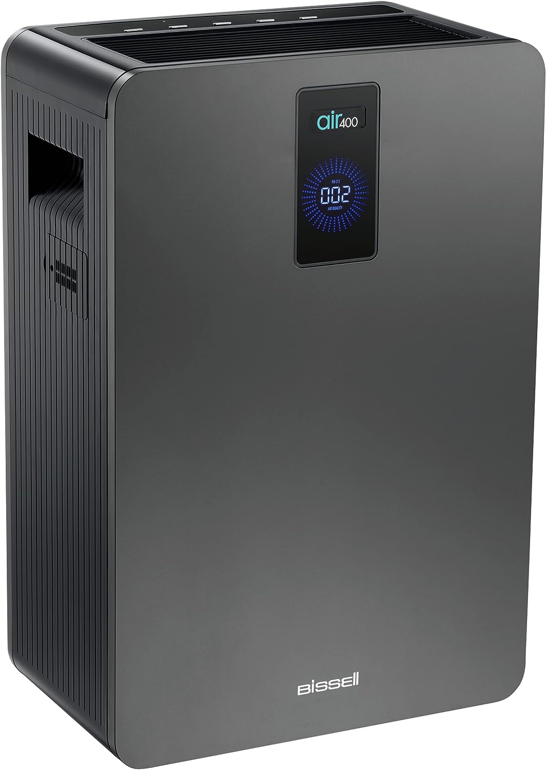

Bought this and changed to polymaker ABS. For me this brand barely smells. But my air purifier runs 24/7.
I also have a PCO for my whole house HVAC system. Together they do a great job. I print 99% ABS.
The ONLY time i see high particles is when my wife fries bacon. :smile:
