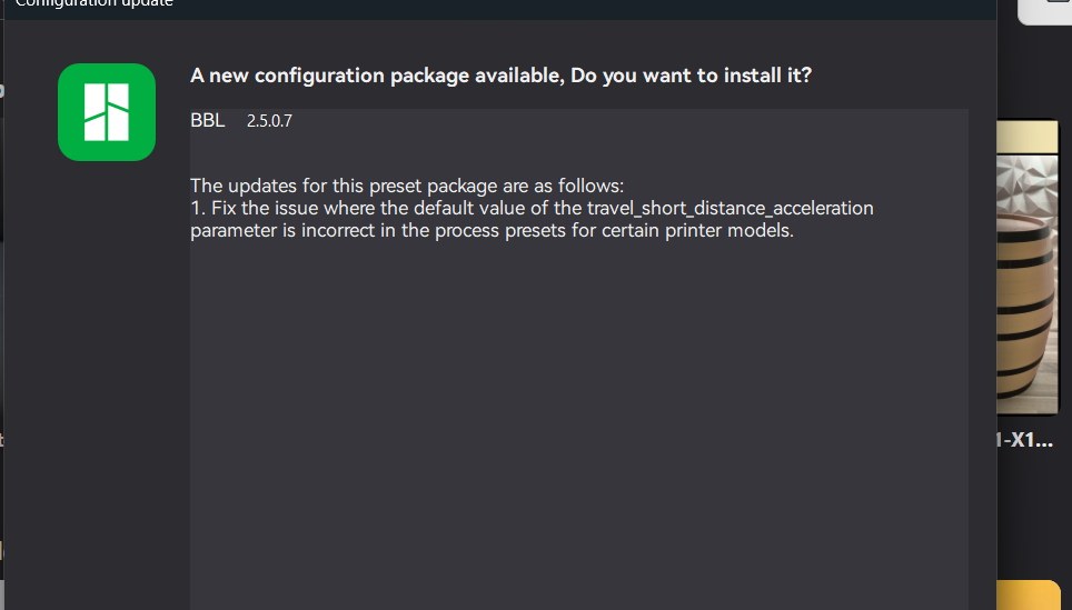

? i keep getting this update , if you havent already installed it, although it might not be directly relevant.
That’s not one of the weird issues I’m seeing, but I do have that applied already. Sadly, it hasn’t done anything to evict the little ghost haunting my profiles.
