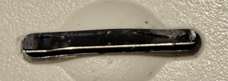

Hey all. I seem to have damaged my Micro SD Card Reader as I can’t insert a Micro SD Card into my A1. I’m not exactly sure what happened as I was building a wardrobe and it must have banged into the printer. Anyway as a result I can’t insert a card.
Is this replaceable or is there anything I can try or my machine toast now as I can’t seem to print anything without one.

Yeah, I know about that, I’ve also tried a different card and the card from my A1 Mini. The card only goes in part of the way, I feel something springy but it goes no further than a quarter of the way
If you take the bottom housing off, the motherboard is located on the other side of that SD card slot. You should be able to see if the port is visually damaged, or inspect it closer as you push a card in and out. The mini’s slot is covered by an aluminum heatsink so you may need to remove that too to get a better look.

I think I’ve probably bent something in the slot, I even lost the SD card that was in it (I probably hoovered it up). I’ll inspect it tomorrow so I might be slow to respond in my next post but really thanks.

Could you have perhaps broken it off and part of the original card is stuck in the slot? Perhaps it’s time for a magnifying glass (or phone camera zoom) to take a close look? SD card holder has red arrow pointed at it.
Looking closely again at my photo I think the memory card has snapped off and is stuck in the slot. Unfortunately I can’t dislodge it, but I’ll try again and if all else fails I’ll take the bottom off and see if I can get it out that way.
Unfortunately I think the slot is probably damaged but I’ll not know until I take the part off and get any remaining card out.

If the only thing wrong is that old sd card snapped off in the slot, easy fix, definitely take off your bottom cover to get access to the motherboard. Using care with a pokey stick of your choosing, you should be able to poke it and push the SD corpse out from the other end. You’ll need a new card :wink:
Well I got the broken card out by opening the cover off and using a needle but the bad news is the slot won’t recognise any new cards. I’ve submitted a ticket and asked about a new Motherboard but I’ll ask around on phone repair shops which should be able to replace things like this.

Support got back to me and it’s £52 for a new motherboard with free delivery so I’m well pleased. Checking prices on a phone repair shop I think a repair would cost £30 - £50 and there’s also a chance further damage was caused so it may not work.
