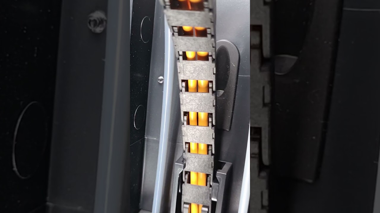

So Bambu labs assured me the sound I was hearing was not from the power supply and is “normal”, it started with a louder bearing noise then evolved to this strange rumble tapping bearing sound the video below is what they told me is normal of their printers.
Had the machine powered off for a night and a day, turned it on to find this sound

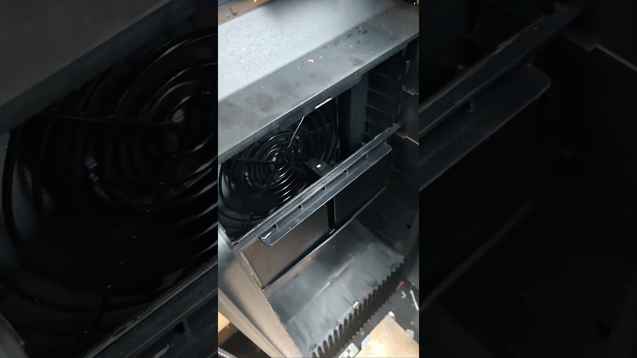

After the first video They told me that they do not think it’s the power supply and pointed the finger at the tool head… now it’s the exhaust fan so I took the rear panel off the machine and I’m pretty certain it’s the power supply fan

Is it possible to unplug the power supply fan for a test? If not, turn the machine off. Stick a plastic straw through power supply fan. Turn the machine on. Is the noise still there? Remove straw. Did the noise resume?
I don’t think I can unplug the fan ? It’s built into the power supply and to be honest I don’t really want to be messing with it. Im a mechanical biased engineer and don’t want the spicy pixies to be angry at me :sweat_smile:
Are they refusing to RMA the PSU after sending in that last video?
Don’t know yet. They refused after the second video I decided to remove the filter to prove the exhaust fan was not moving. The full video I sent them included the QR code and a shot of the settings screen showing no fans are on. But the PSU cooling fans are typically always on from memory
Please keep us updated. I agree something is seriously wrong with the psu fan.

First video didn’t sound to bad to me, second one and something is off. It sounds like the back right corner, so PSU or exhaust fan perhaps? Sounds like a busted/imbalanced fand blade to me.

After 3 weeks of messaging Bambu lab they have finally decided that the psu is actually causing the noise. They are sending a replacement. I wonder why the support email team is so hit and miss…
That’s a bummer! I’ve heard a few of the noises made by bad PSU fans on FB groups and it’s unlike any other fan failure I’ve heard. It’s so unique it should be obvious to them by the sound (you would think).
