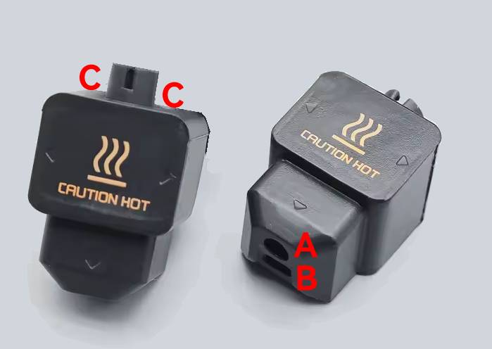

I have had to replace the little nozzle guard twice. Not sure how it keeps getting bent, but it does. The silicon nozzle covers will not stay on. New one, old ones… doesn’t matter. Almost every print now they just pop off and I can not figure out why. I have had 2 nozzle clogs where I have had none with any of my P1S in the 2 years I have had them. Love this thing, but it is so troublesome in the so many small annoying ways.

For the nozzle sock, make sure the nozzle tip is through A and not B and make also sure C goes over the heatsink, it sometimes just fold in front of it during installation.
I will confirm I have it on correctly. Could be it fell off and I never installed it properly to begin with. Thanks for the tips.
Yea tried that too. Tbh for me it seems totally random. some times ill just highshot the sock from across the room, and it will remain on the nozzle until I disturb it again, and some times ill Gordon Ramsay with tonks and a flower gently put it on the nozzle, and itll fall off because I sneezed..
Seems too loose to hold on consistently.

Watching it print, the nozzle covers are coming off during color change when it moves across the nozzle cleaner when removing the purge. it just hits it and it forces it off every time.
I had multiple Brocken socks, but I never had a sock going off mid print. I print multi color/material more often as single color/material.
Maybe there is something going on with your purge wiper?
thats what it, during the purge wipe it knocks it off.

When you push on the orange lever at the back, the one with 2 screws, it lifts the wiper but when you release it, does the wiper comes down. Mine would sometimes stick inside the purge container back wall and the wiper would only release during the actual wipe due to vibrations.
I added some grease between the lever at its angle inside and the purge container back wall, it now releases easily, no more wiper sticking upwards
