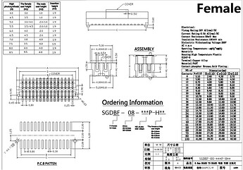

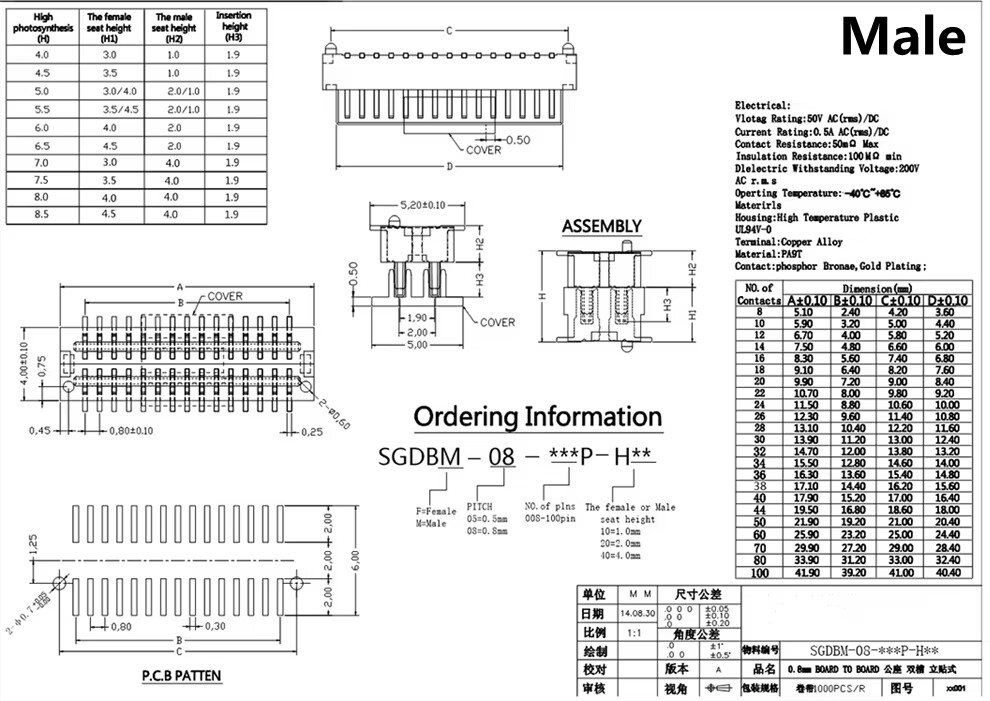

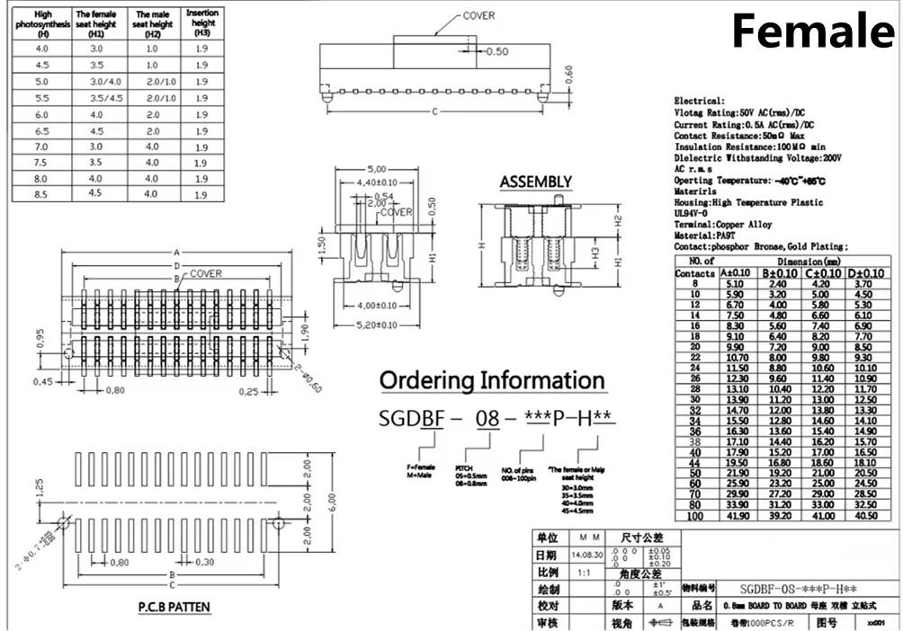

The connector is not proprietary as believed. I found this a while ago but I didn’t really need to get one at the time. I couldn’t find manufacturer or a PDF datasheet of this connector. It’s understandable since this is “Made in China”.
For thermistor and ceramic heater, the part number should be: SGDBF-08-020P-H70 and SGDBM-08-020P-H70 (for female and male)
For part cooling fan or hotend fan, the part number should be: SGDBF-08-016P-H70 and SGDBM-08-016P-H70

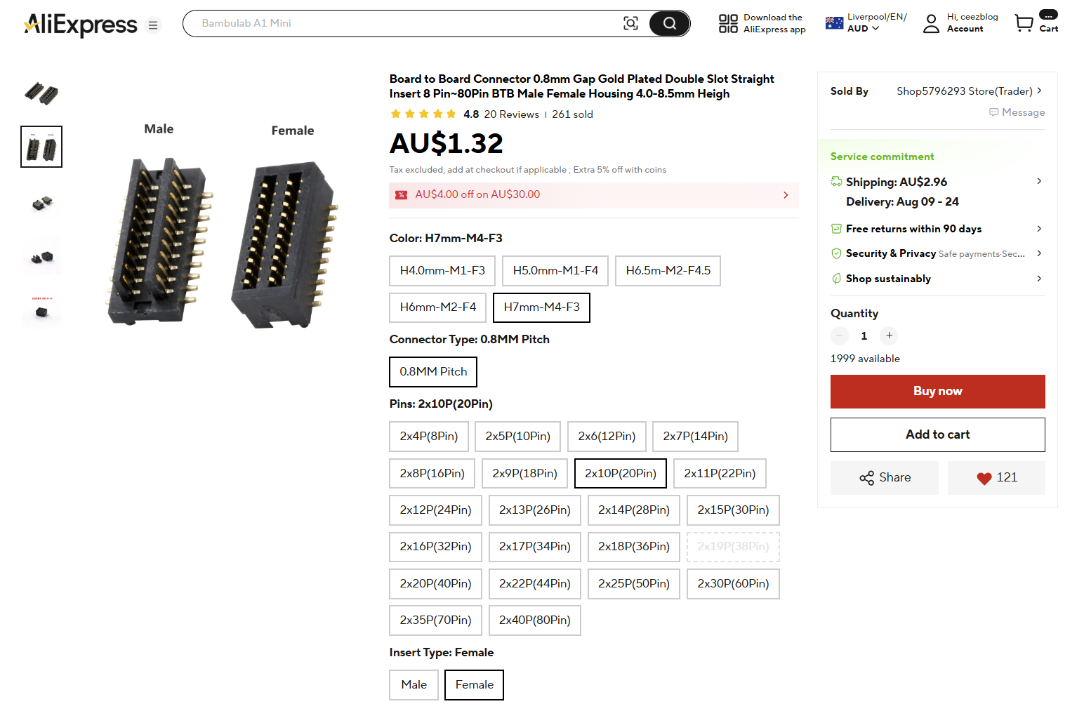

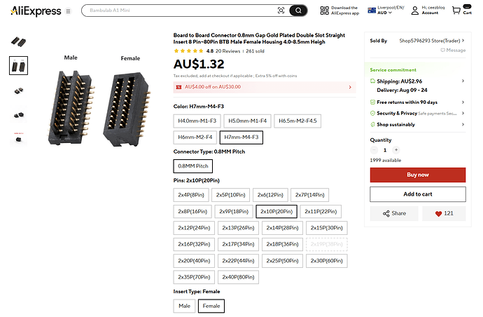

Aliexpress link https://www.aliexpress.com/item/1005008305436254.htm
which listed as:
Board to Board Connector 0.8mm Gap Gold Plated Double Slot Straight Insert 8 Pin~80Pin BTB Male Female Housing 4.0-8.5mm Heigh
(Keep screenshot for record in case of this aliexpress listing gone dark)
There we have 2 screenshots from the datasheet that clearly show the part number

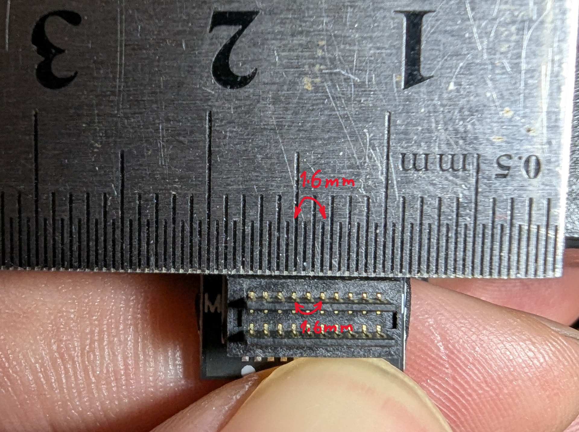

The pitch is verified as 0.8mm
