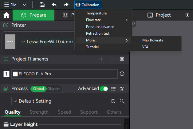

Sorry for the newbie question, but I’m just now moving away from BL filament and am trying out others (including Elegoo Rapid PLA+, Kingroon HIgh Speed PETG, and others). When you started with the Generic PLA setting and began to tweak, how did you determine what to use for Max Volumetric Speed? I’m trying to learn what process to use to determine which settings to tweak and what to set them to (outside the obvious stuff that’s stated on that package like bed temp, nozzle temp, etc.). Thanks!
Hey there.
Quick way: calculate it based on the linear rate of the filament. E.g., a 300mm/s filament at .2 layer heigh and .42 line width should give you ~ 21mm3/s. You can use this site to calculate for your particupar needs Printing Speed to Flow Rate Calculator - Vector 3D
Best way: Run a Max Vol speed print. You can download one or tweak Bambu Studio to show it directly.
I always do the quick way and only do the Best way if I’m going to print many rolls of that particular filament
