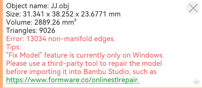

I’m trying to import a .obj file from Roblox Studio into Bambu Labs studio.
I get this error (attached screen grab)
How can I ‘Fix’ the model so I can print it on my A1 Mini? I tried the suggested link but was incompatible.

As it says there, click the link. Then upload your model. Wait a few minutes, and download it. Free online stl repair tool
Thanks but the site wants an .stl file and I have a .obj file.
Okay, then convert it to an STL. Convert OBJ files to STL files | makexyz.com
Meshmixer does the repair and it’s available on mac.
Or…
Install windows on a vm and run it there. Easy.
Fwiw that error does not necessarily mean it won’t print well. I have plenty of models with errors like that but they slice and print with no issues.
