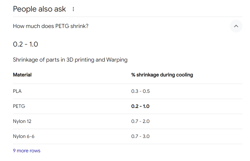

I don’t agree on this. Your statement sounds like shrinking is all over the place. It is a very well known property of most materials and does not depend on the printer. Only on the print temperature and that is also part of the profile.
In my experience, shrinkage is very consistent between different spools, different colors and even between many manufacturers.
For their own filament, BambuLab has all it needs in their hand.
And even if it is not perfect, it would bring a vast improvement in dimensional accuracy, if Bambu would make use of the shrinkage compensation in their profiles.
So I too don’t understand, while they give us the tools to optimise the motion system to within 50 microns, but they leave the elephant in the room untouched and the users have to take care of it.

Of course it would not be perfect, but I strongly believe and my experience so far confirms it, that shrinking is very consistent. Much more than e.g. flow. It doesn’t depend much on the manufacturing process but solely on the chemistry. Even chamber temperature doesn’t have an effect, because it will finally shrink the same amount as my print with cold chamber when it cools down to room temperature.
And why not provide the profiles with an averaged compensation value? It certainly would improve accuracy by an order of magnitude. If you need that last step to almost perfect dimensions, you would have to calibrate yourself but for most users, an average compensation value per material type would be a huge benefit.

Ahh, I see. Actually, holes being to small is not the same as material shrinking. Small holes are a result of shrinking but its not the same. Similarly to warping which also comes from shrinking. For both, shrinking compensation is no big help
Shrinkage compensation refers to the parameter “X-Y shrinkage compensation” in the material profiles, which comes into effect especially in bigger parts.
