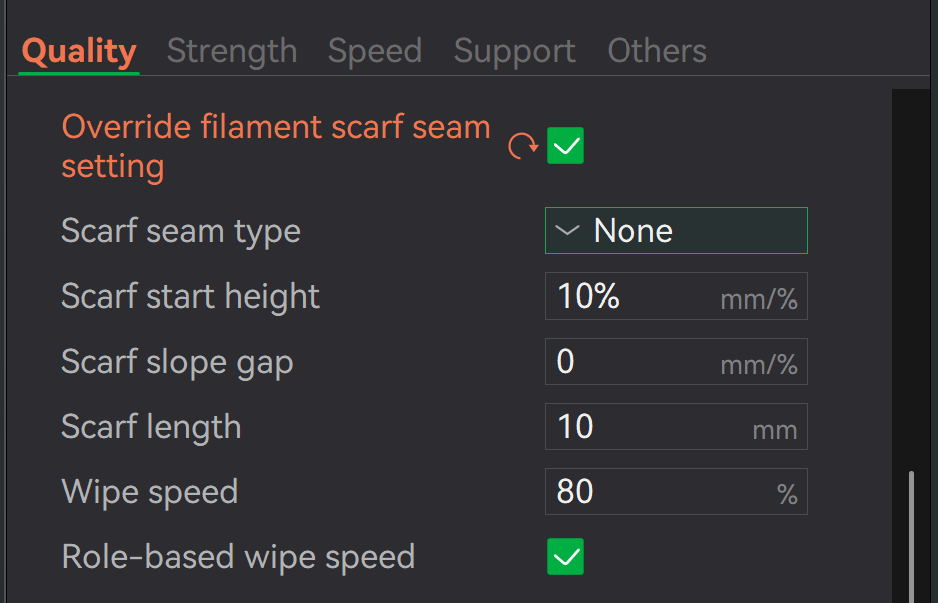

In Bambu Studio:how to find and set "Outer Wall Seam: None "
I am trying to get “invisible seams” on the outer wall of my Tubular print. Co-Pilot suggests the following (as well as other settings) but I CANNOT FIND "Outer Wall Seam: None "
My printer is X2D with a MicroSwusss HF nozzle, using Bambu ASA filament
See CoPilot advice points below:

There’s no such setting in Bambu Studio, your AI is hallucinating, sorry, or perhaps referring to the wrong slicer (I don’t know which, if any, have those settings). There’s no “seam type” setting either, “Aligned” and “Back” are both in the “seam position” choices. There’s a scarf seam type, but that’s a different animal altogether.
-Max
If your part doesn’t have sharp corners to hide the seam in, then the Scarf Seam is the best alternative.
In this wiki section you wil find more information about seams including the Scarf seam: Seam settings | Bambu Lab Wiki
Forget your AI responses. In this case it’s garbage.

Strength wise on a cylinder, setting the seam to “random” might be better. You will have little seam dots on the surface but never a straight seam along the part.

I recreated your scenario, and in that case, you would have come across the exact source of the “none” reference: The AI messed that up in my case too, but clicking next to the text on “source” takes you to this image: This makes it clear that “none” is valid for another function.
So always - and I mean always - click on source!
