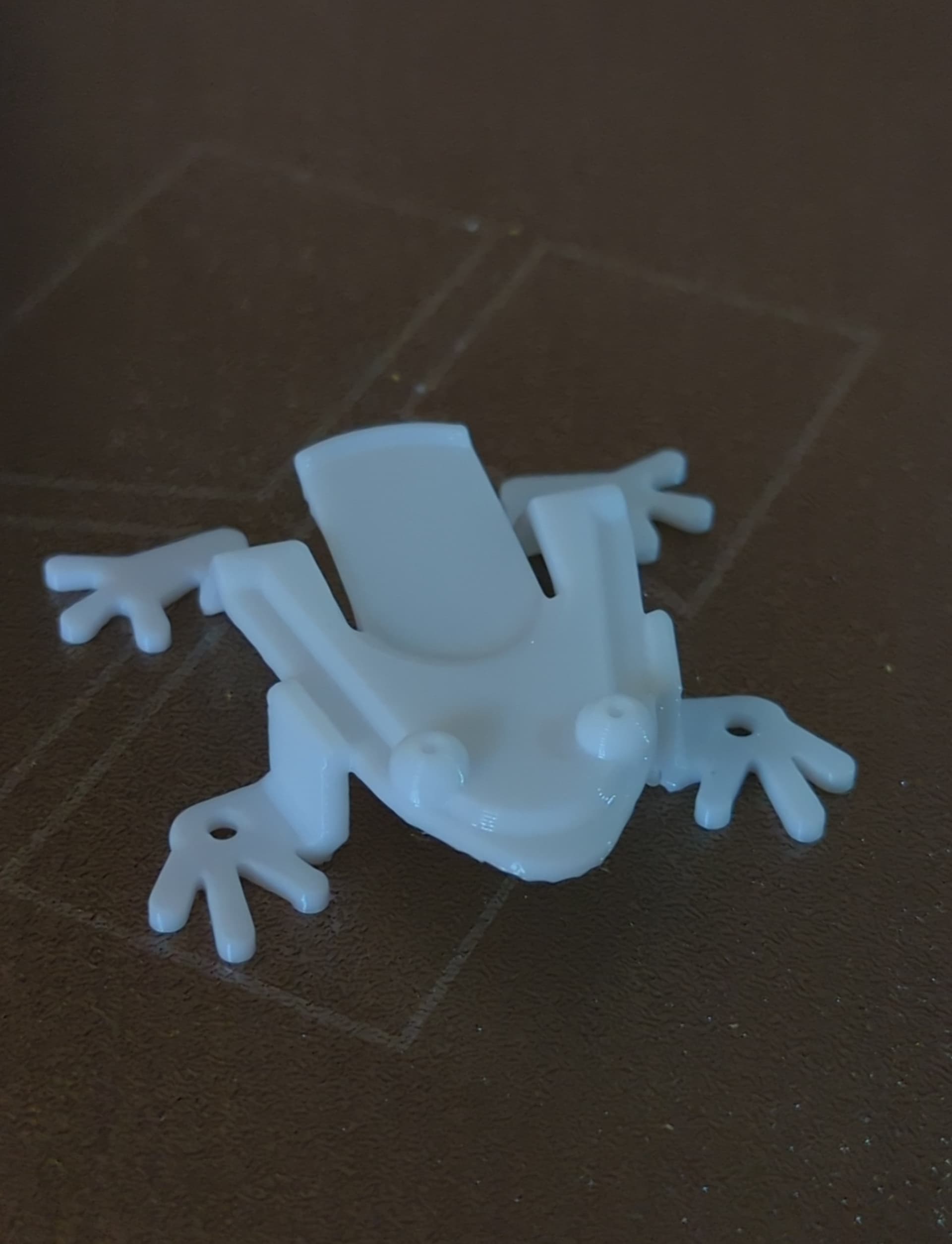

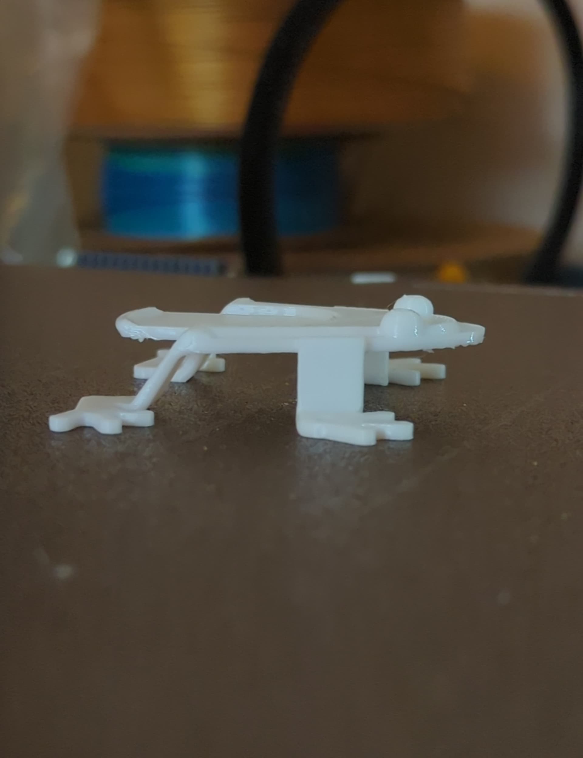

for those like myself desperate for any type of petg I can tell you that even without drying (i decided to be naughty and not dry it–) the Jayo stuff prints perfectly.
Ignore the build plate crumbs; just leftover bits of the supports.
(Print credit: Battle Frog Leapster 3-in-1 by Tommy 3D Lab MakerWorld: Download Free 3D Models )

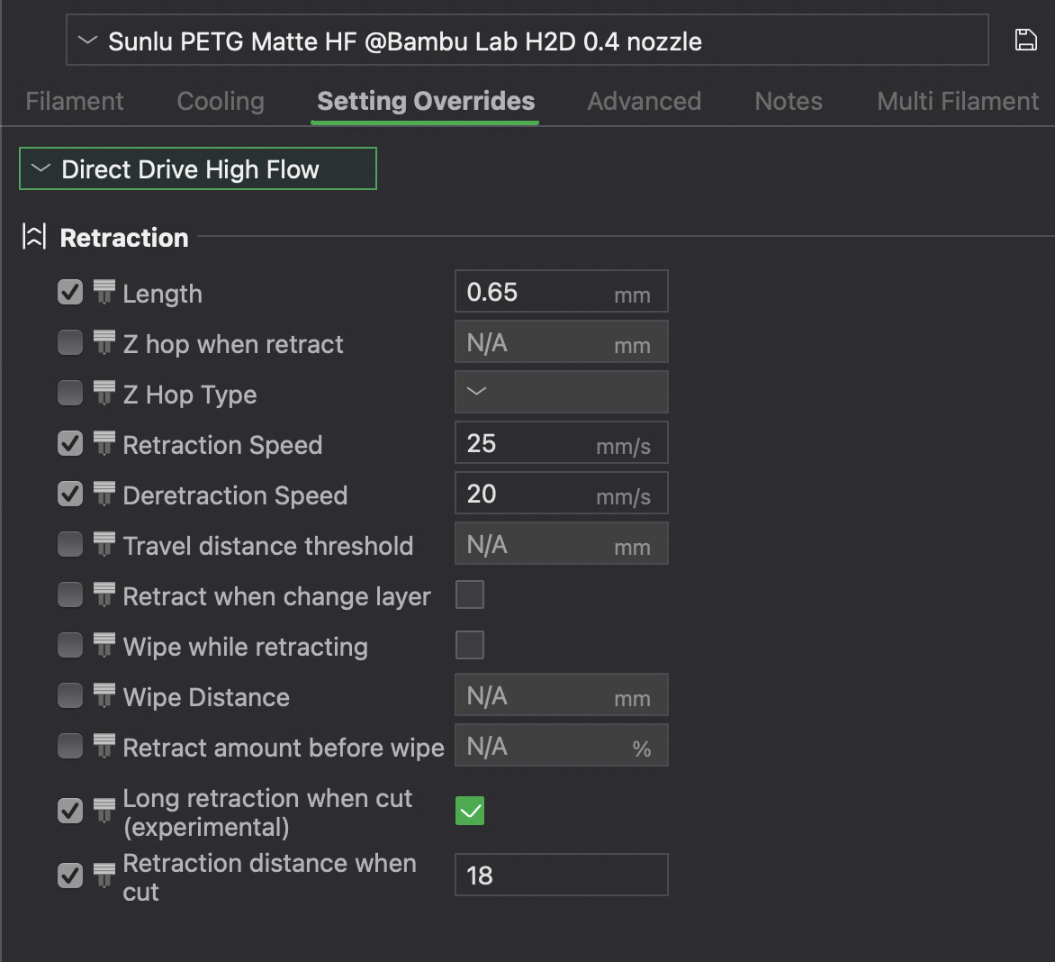

Without modification a single item printed great, but printing a build plate full of items with travel between them was leaving gaps at the seams where they started.
I had to do some adjustment on retraction and deretraction as well as wipe on retraction but my Sunlu High Speed Matte PETG is printing like a dream now.
The rest of the profile is the stock Bambu PETG HF profile. I only made changes on the ‘Setting Overrides’ page.

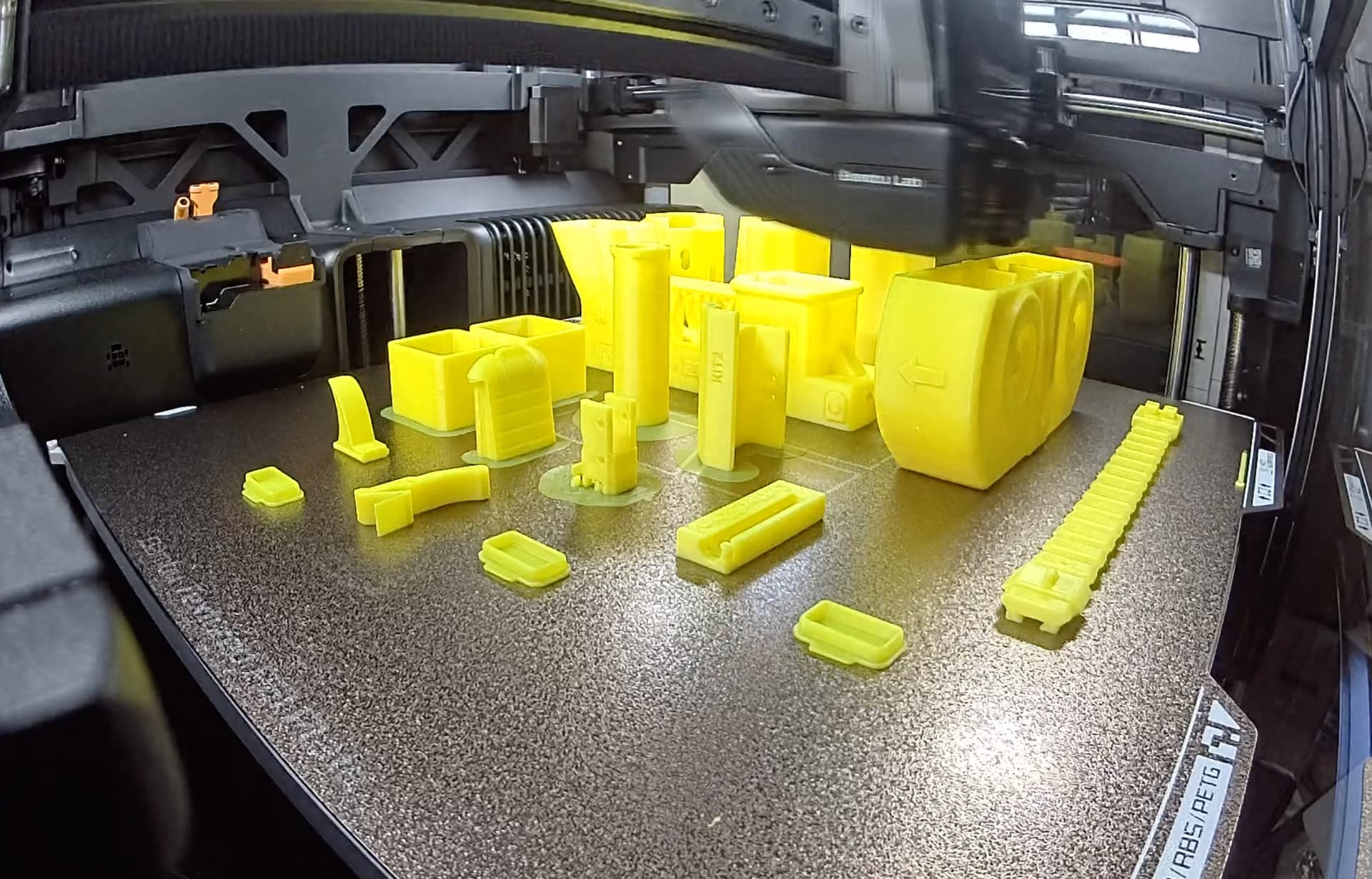

Sunlu Matte PETG High Speed with the above profile.
The internal camera doesn’t do this justice. It looks great.
That is really interesting. I too had the gaps at the seams. Worst was Elegoo HS PETG, second worst IEMAI HS PETG, then came Sunlu and best was BAMBU HF.
I will retest Sunlu with your settings. Thank you for the hint!
