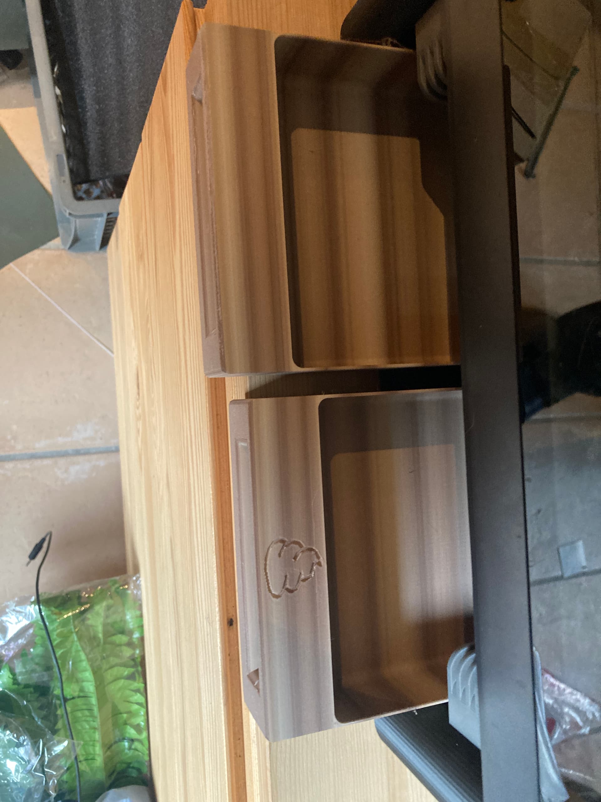

the last days until yesterday I printed this very nice poop tray with
drawers (1st pic).
No problems, everything was fine.

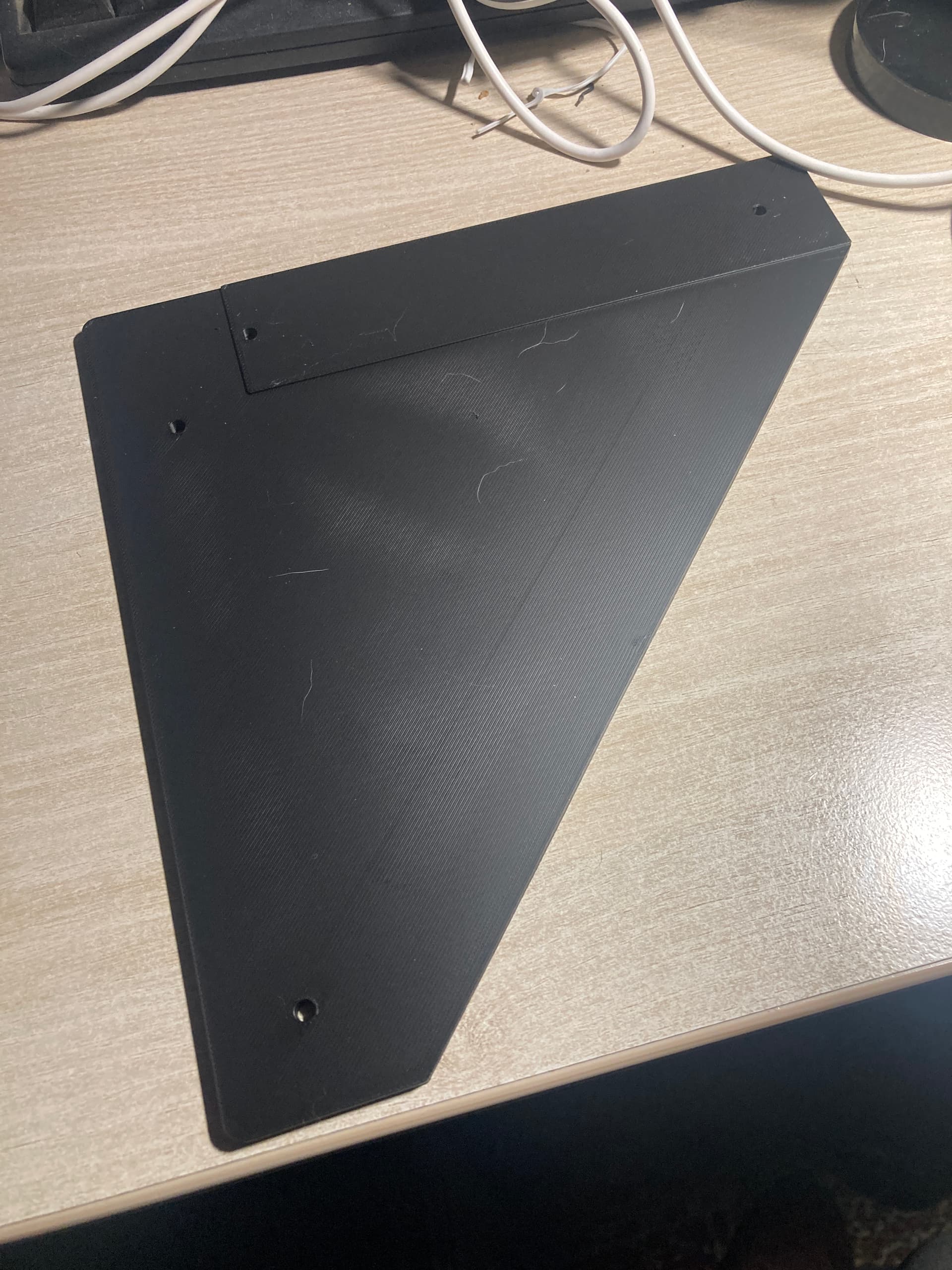

The I wanted to make those triangular reinforcements for an Ikea Kallax.
The 1st one done yesterday was perfect.

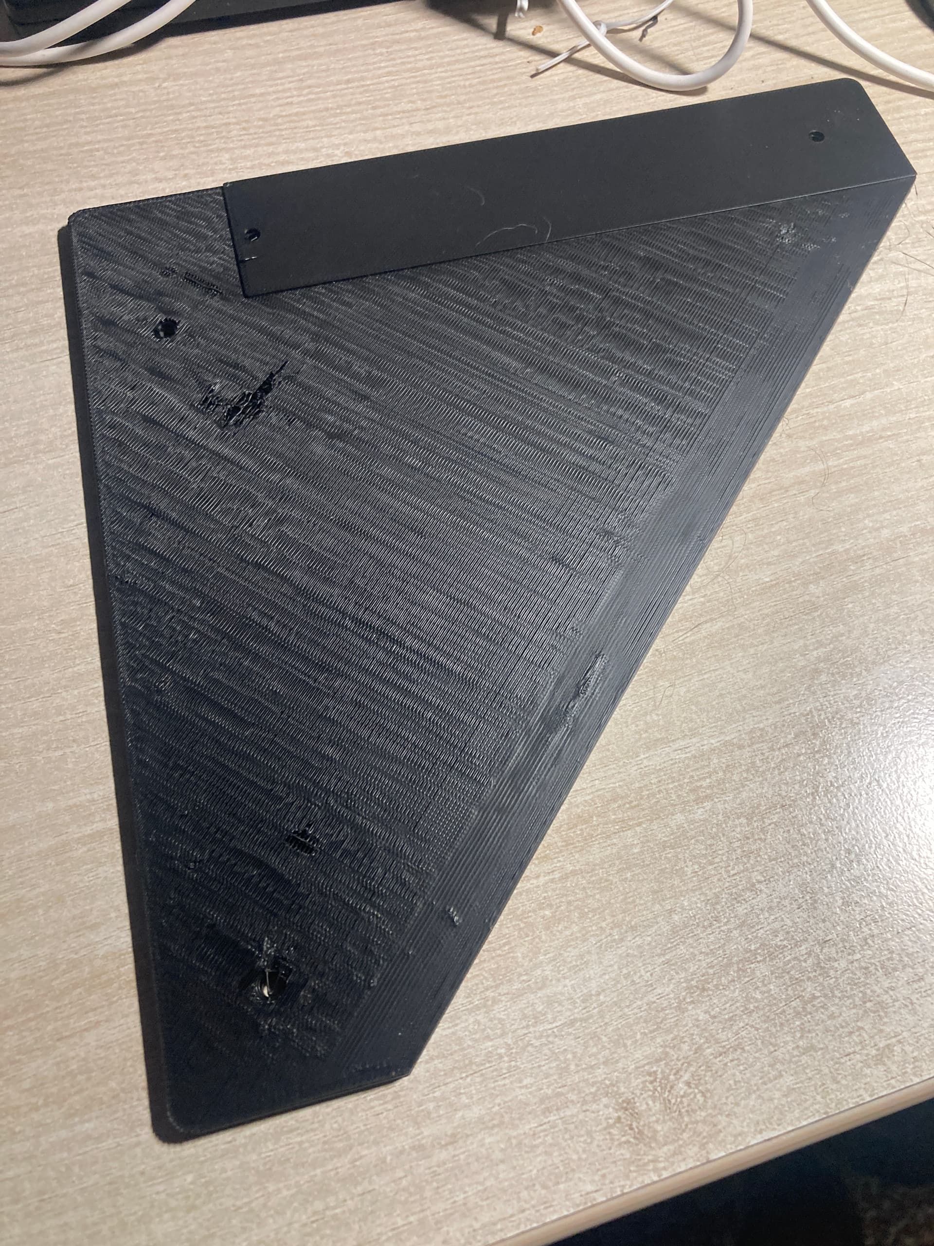

On the 2nd one, printed during the night, the last layer was missing (or
maybe the last two or three)
As it is mounted on the back I thought I maybe could use it anyways and
started printing the 1st part for the opposite side… it said it would
take 2 hours (as both of the other two parts), so meanwhile I took the
potty walk with my dog. On return the Bambu Studio said that printing
was finished.
But look at the last pic, it just stopped after some layers even it took the predicted 2 hours and said finished.
All Prints were done with 100% speed and the same filament. I have printed this very item before for some other shelves w/o problems.
At this time I try to print the last item again after calibrating the printer.
And again starts ok but it doesn’t print the upper layers, the head is moving and there is no filament coming out the nozzle.
Any ideas what went wrong?
