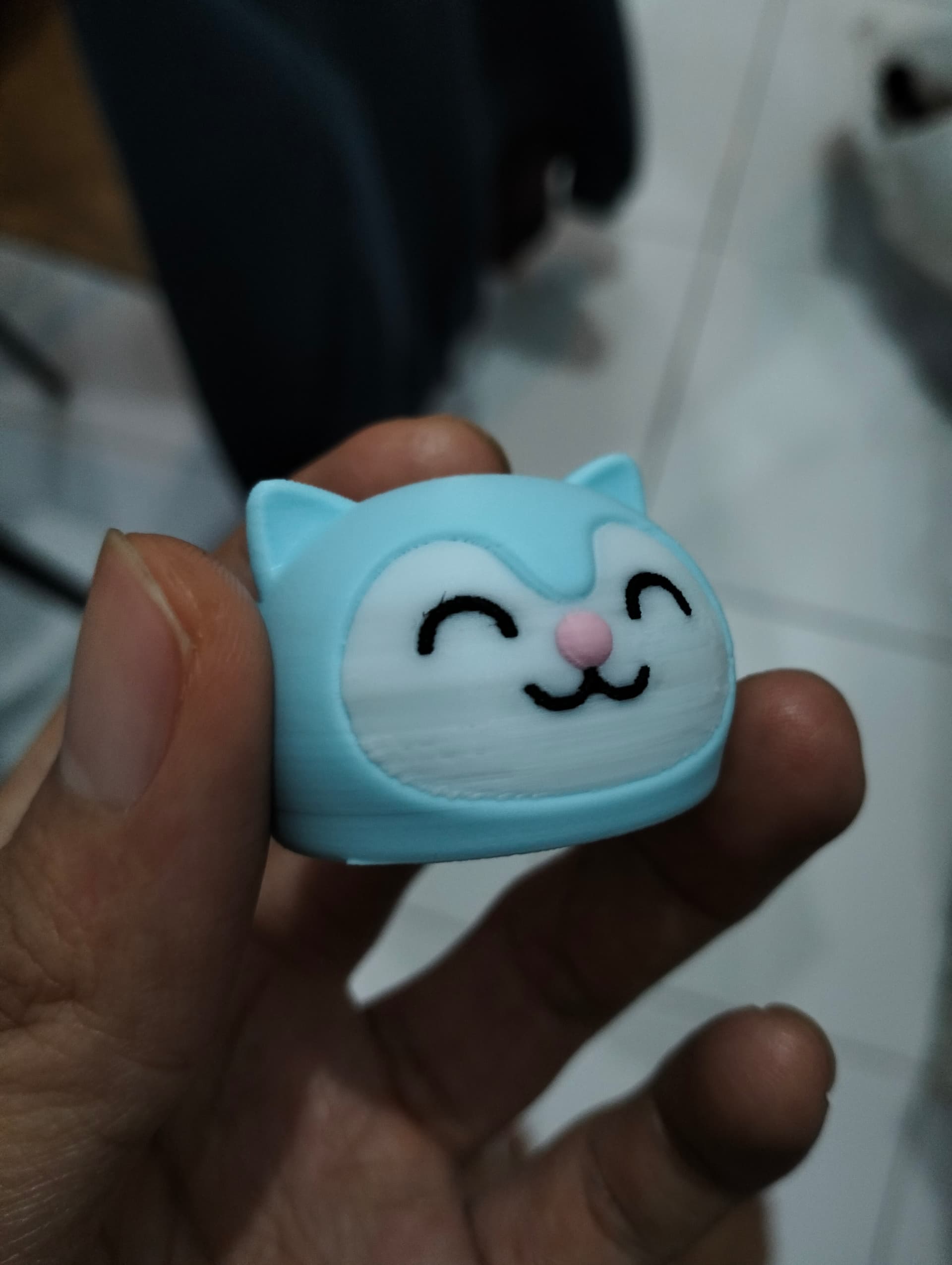

hello, i get a hard line here, how to make it smooth?
Hi @Jovianwirja
Are you referring to the layer near the Polgar?
Please provide more information, such as nozzle diameter, and print settings (e.g. using default profile X with these changes: Y, Z, …)
Also, are the filaments calibrated, especially flow rate and pressure advance? Dry?
If want to simplify, share the .3mf file.
It isn’t obvious what you mean.
Do you mean the colour bleeding from the black parts into the white parts?
If so, two things can improve it.
  1. Most likely: Change the filament sequence of the first and subsequent layers, so white is printed before black in any layers.
  2. Increase the flushing between the white and black transition.
Do you mean the overhang line that appears in the left of the photo near your hand that goes to the bottom of the white face portion?
If so, this is likely part of the model design and is simply a tough angle.

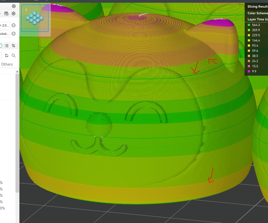

I have cooked it better with variable height but there are lines appearing in other places how do I get rid of lines like this?

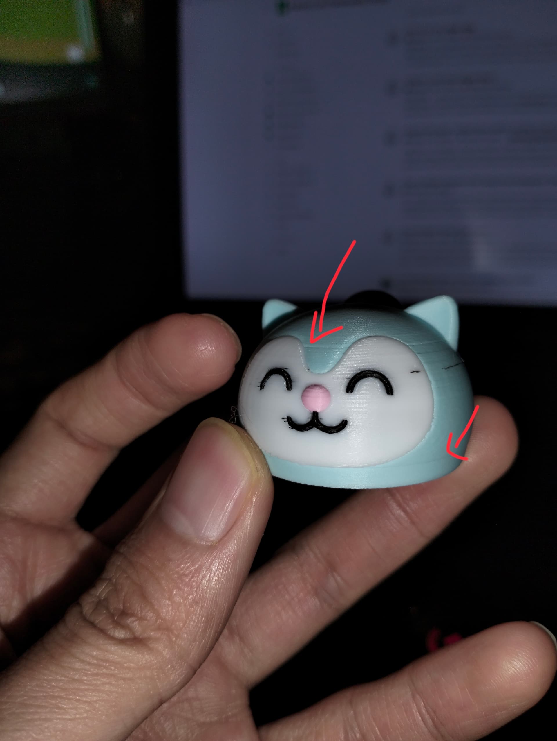

Hi, I get a solid line here. Is this line from layertime? How do I set it so my object can be smooth?

hi i have a solid line here and i see it quite clearly in layertime and the print result. is there any solution to smooth it? i have used variable height but it still has a solid line. and i also get melting from the black filament is there any solution for that too?
