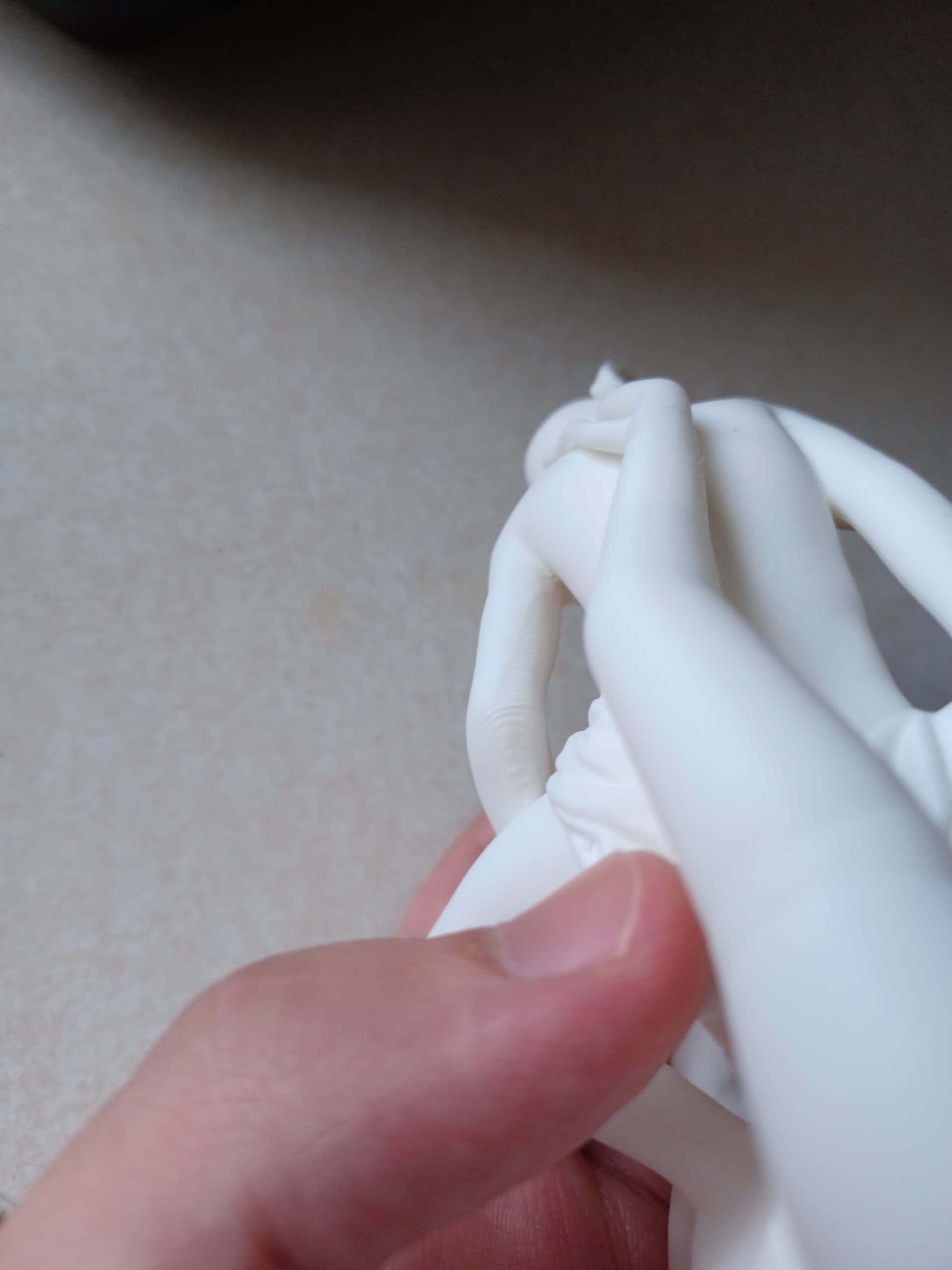

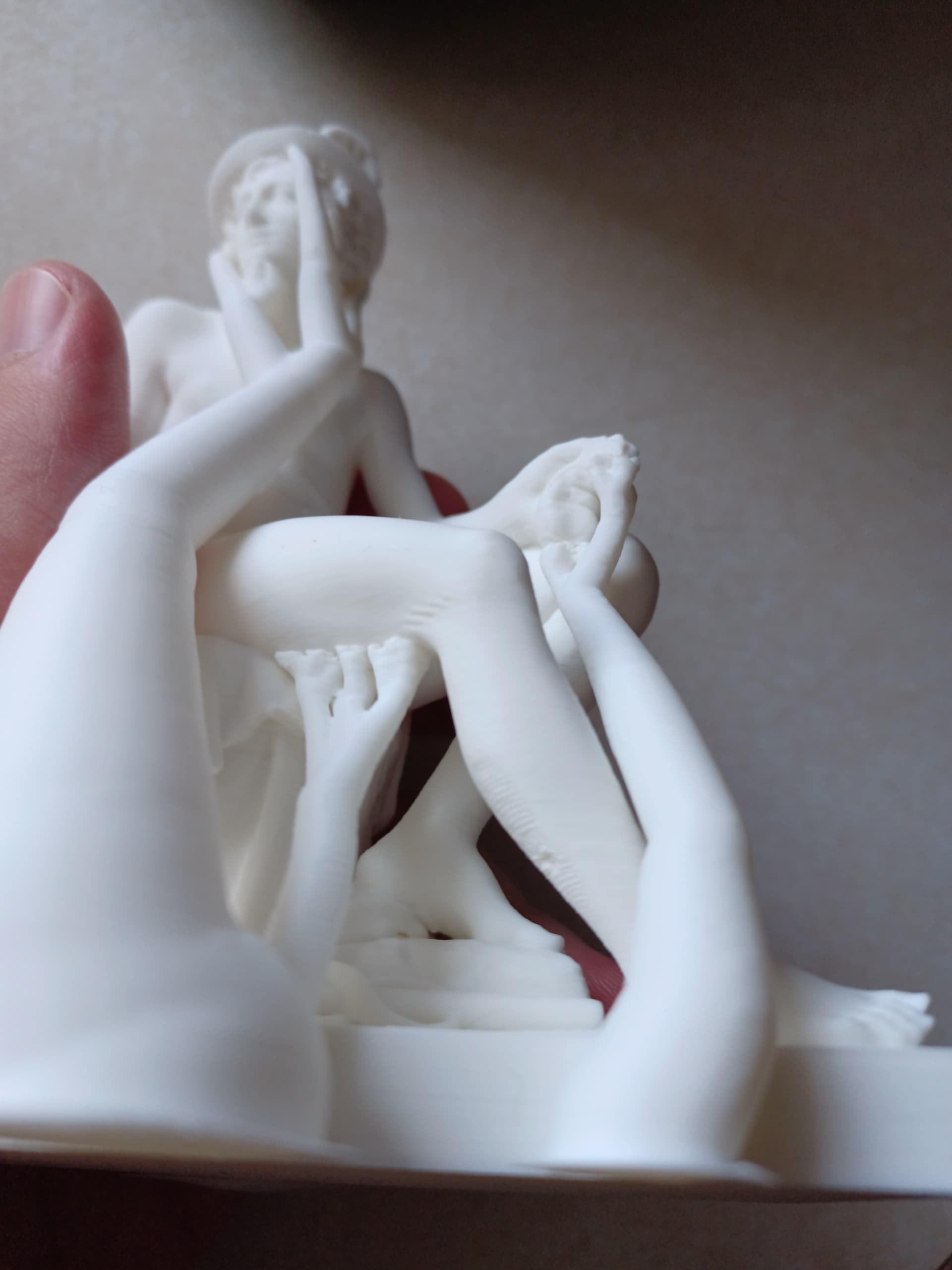

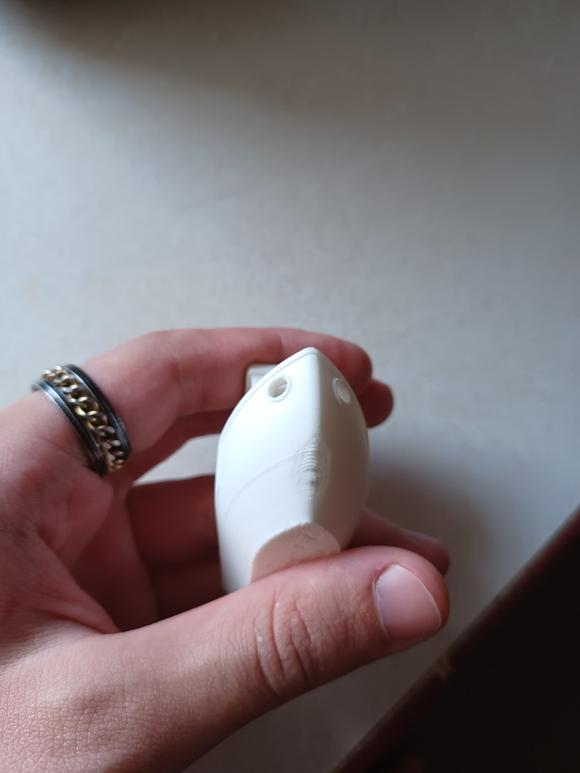

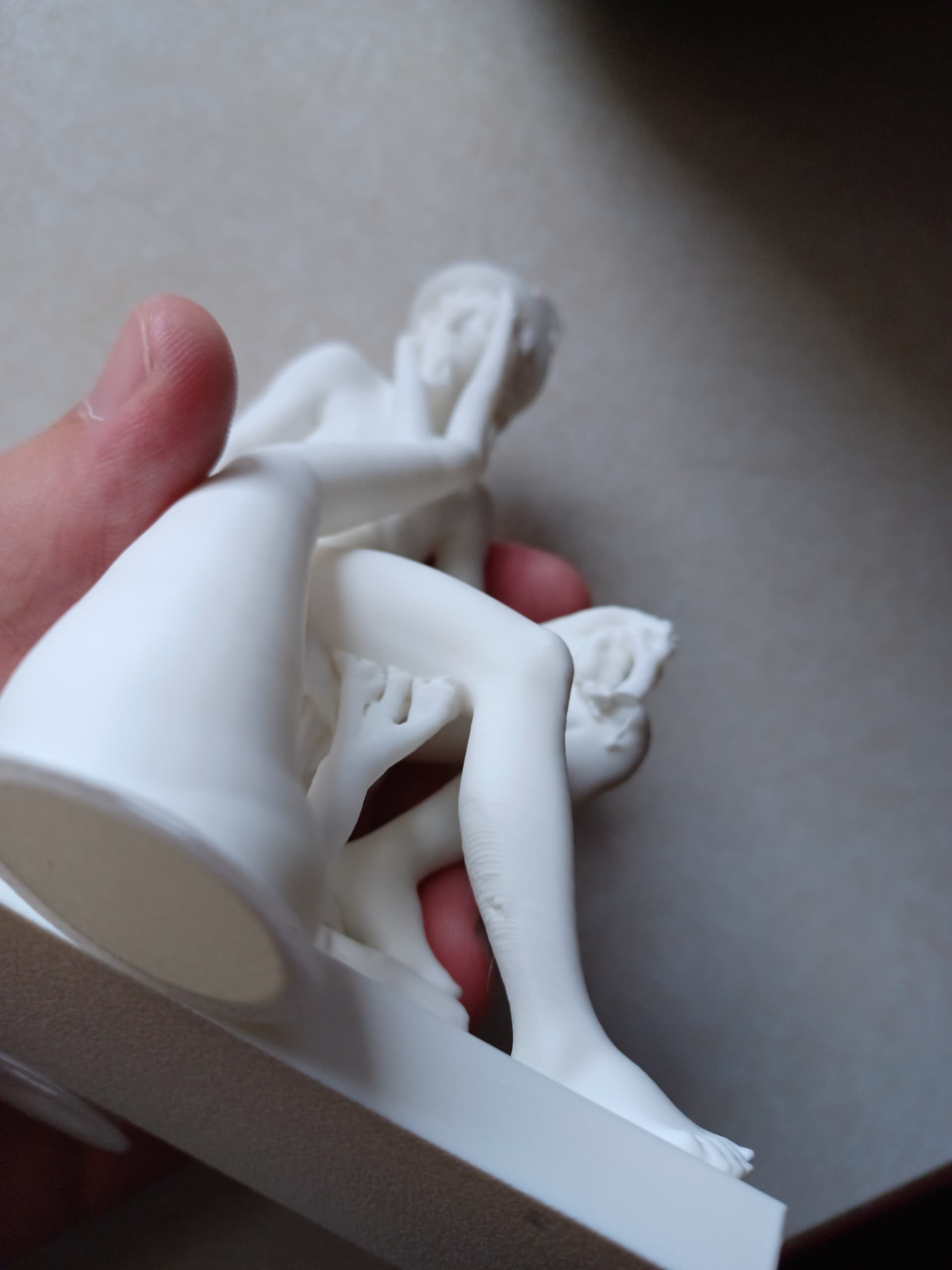

Hello everyone! We’ve been having a very complicated issue with BOTH of our printers recently that I honestly can’t put into words. It only started recently, and was never an issue before that. I’ve attached a few images below. The artifact is hard to see in some of them, but the best description that I can give is that it looks like a slightly recessed “ulcer”, with what looks like overextruded layers inside. It’s not on every overhang, in fact it’s only on overhangs that are between a certain minimum and maximum. Too much overhang and it prints fine, too little and it prints fine. Importantly, this issue also only arises at lower layer heights. I haven’t tested exactly where it starts, but I know that it happens at least at 0.16mm, and not at 0.20mm. So far we’ve tried the following fixes with absolutely no effect:

Suspicions we have that we have not been able to test yet include:
- The fan being messed up. We sometimes get warnings about it, but it always resolves itself, and we haven’t wanted to replace it only to find out that it’s not a problem.
- We have not messed with the cooling settings of the prints yet.
- We have not messed with the extruder gears yet.
