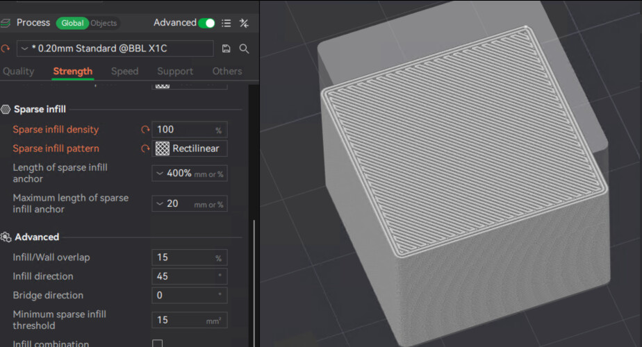

Sounds like you are looking for 100% infill?
If that’s what you are looking for you can do 100% rectilinear infill to make it into a “solid” object.
or an infill like cubic where only one section will be penetrated
