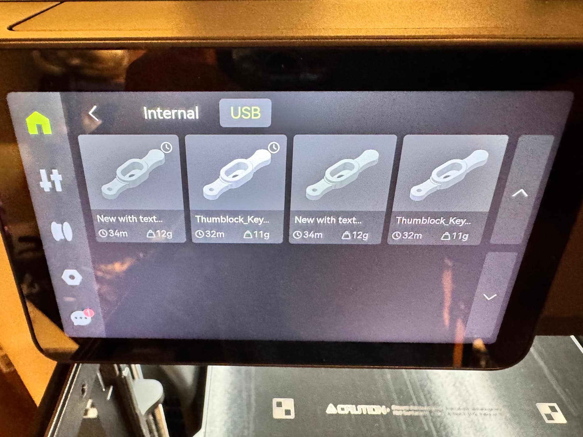

Yes the one stored locally is overwritten - but mine seems to store two files for each model on the USB as well?
So when I switch to the connected USB, I see one file correctly, an dteh second is a duplicate with a small timer icon in the top corner.
Have uploaded a pic, where you see 2 files. Both have been duplicated with a small timer icon - what does this icon mean?
Thank you
The latest firmware (or may be even before) does that, it seems to store the file in the cache folder (the ones with the small clock) and a duplicate at the root of the USB stick. I think the cache folder is limited to 8 files so those with the small clock will eventually be overwritten but the ones at the root of the USB stick will stay as long as you have enough capacity then they will also be overwritten one by one to make room.
I don’t know why it’s like that, must be a limitation of the current firmware until bambu changes the coding to allow more than 8 files in the cache. It sounds to me like just a quick fix for now to allow more files in memory without changing the 8 file cache limit.
Why have the cache at all?
From my understanding, the active file is sent to internal storage for printing anyways - I just wanted a copy to be saved to the USB. I don’t want cached files and duplicates on the Usb at all.
Hopefully a bug Bambu will fix at some point…
I wonder if it’s something to do with power loss recovery or if it’s updated when you do things like skipping objects. Pure speculation but maybe
