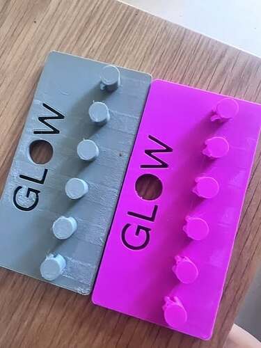

Hi everyone! :slightly_smiling_face:
I’m having an issue with ironing. Everything used to work perfectly, but now I just can’t get a smooth finish anymore.
Here’s what I’ve already tried:
  • Updated Bambu Studio and the printer firmware
  • Replaced the nozzle
  • Fully recalibrated the printer
  • Recalibrated the filament flow rate
  • Adjusted the ironing settings
  • Performed maintenance on the printer
  • Tested two different filaments PLA
The problem is still the same, although it’s a little less noticeable with the pink filament.
I created the model myself in Blender.
I’m running out of ideas… If anyone has any suggestions or settings I could try, I’d really appreciate your help!

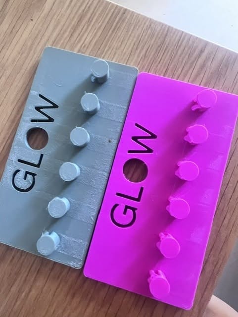

I don’t think the issue is related to the 3MF file, as I’m experiencing the same problem with all my models whenever I enable ironing.
I’ve already performed an Ironing Calibration and applied the speed and flow rate settings that gave the best results for my printer.
When I run a test on a simple square, the result is fairly good, although the surface looks dull. However, as soon as I print a slightly more complex model, like the one shown in the photo, the ironing result is a complete disaster.
The problem started after I hadn’t used my printer for about two months. When I turned it back on, I updated both the printer firmware and Bambu Studio. That’s when the ironing issues began.
I then tried rolling back to the previous versions of both the firmware and Bambu Studio, but unfortunately, the problem persisted.
What I find most confusing is that ironing used to work perfectly before, without any issues at all.
I really don’t understand what could have changed, and I’m running out of ideas on what to try to get back to the print quality I had before.
