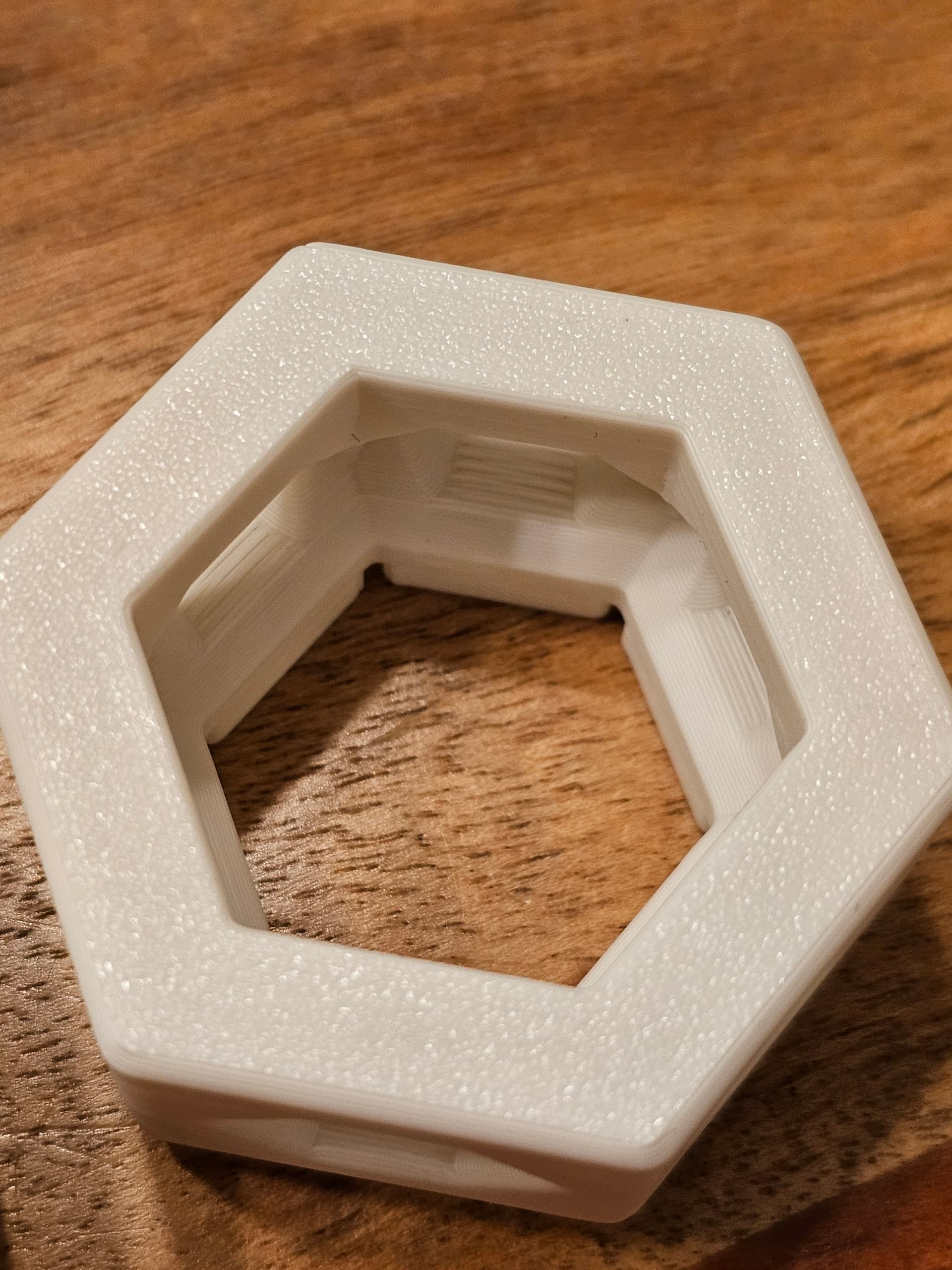

Iām so glad I found your postā¦ has the same issue, cleaned and changed everythingā¦ and just one reset and all sorted. Thank you!
I soooo hope this will also solve it for me! Iāve wasted so much material lately because of underextrusion and tried everthing even exchangde the extruder and hotend for new.
If it works I must say why Bambu support didnāt suggest this. They had me jump through so many hoops with no result.
I am having a very similat experience, been in touch with bambu support since the very beginning of september and everything except a factory reset is mentioned at this point. I have improved my print quality a bit by changing all the PTFE tubes, hot end and cleaning the extruder but still the reliability does not feel like the old days.
Can you please share your results?

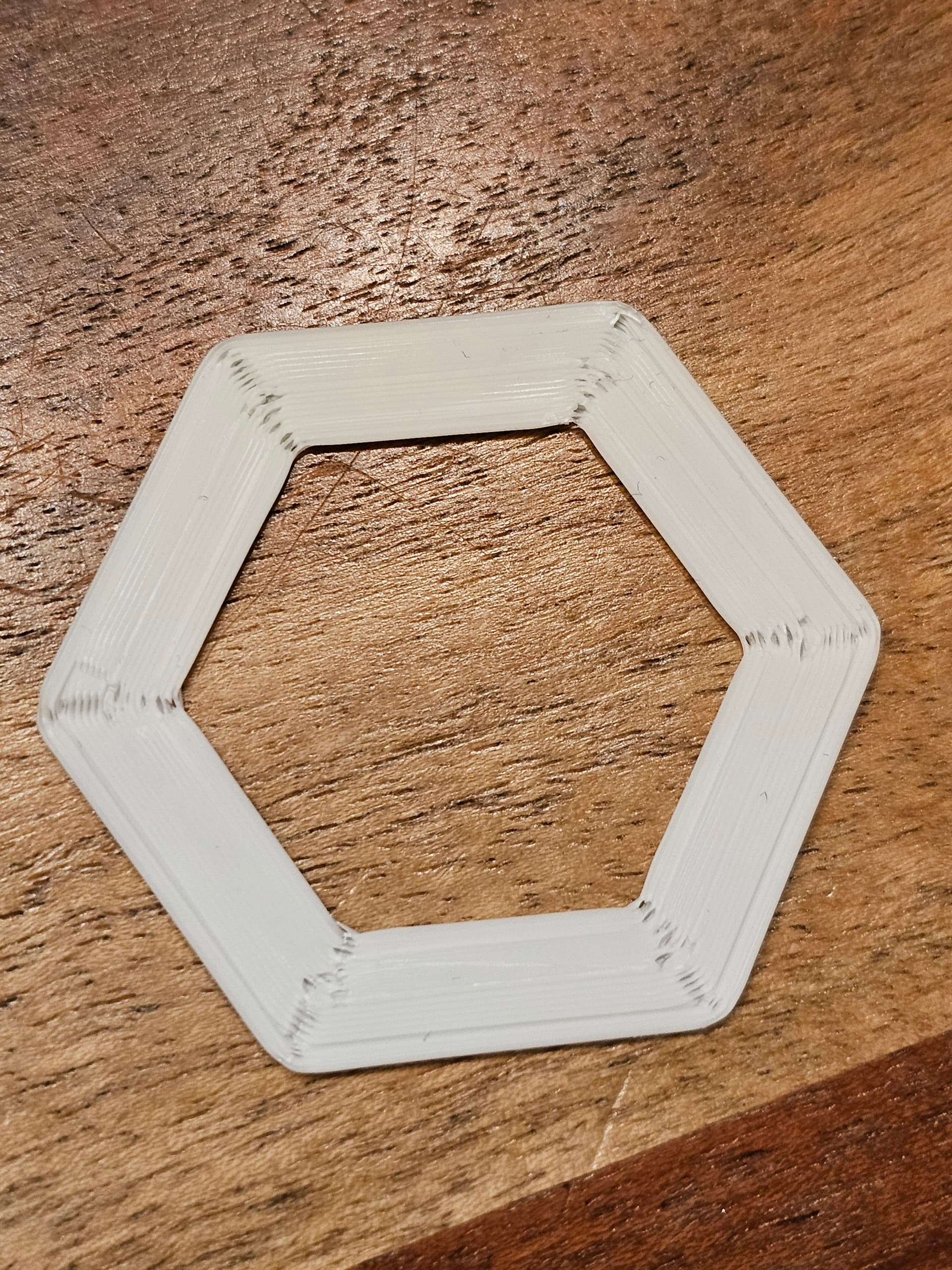

I too have encountered under-extrusion problems recently, at the beginning I printed a perfect piece then the first dots/holes started to appear on the external walls, obviously I hadnāt touched anything on the slicer. I attach photos and hope a factory reset will fix everything
WOW
Thanks x 1 Million.
Fixed what I had been chasing for 2 months!
a huge thank you for the tip with the reset to factory settings after the update !!!

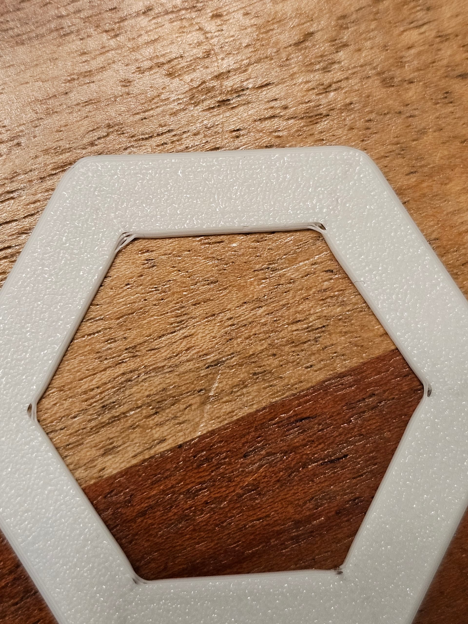

Without reset to factory settings, it looked like this after the update:

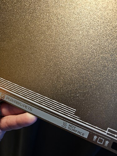

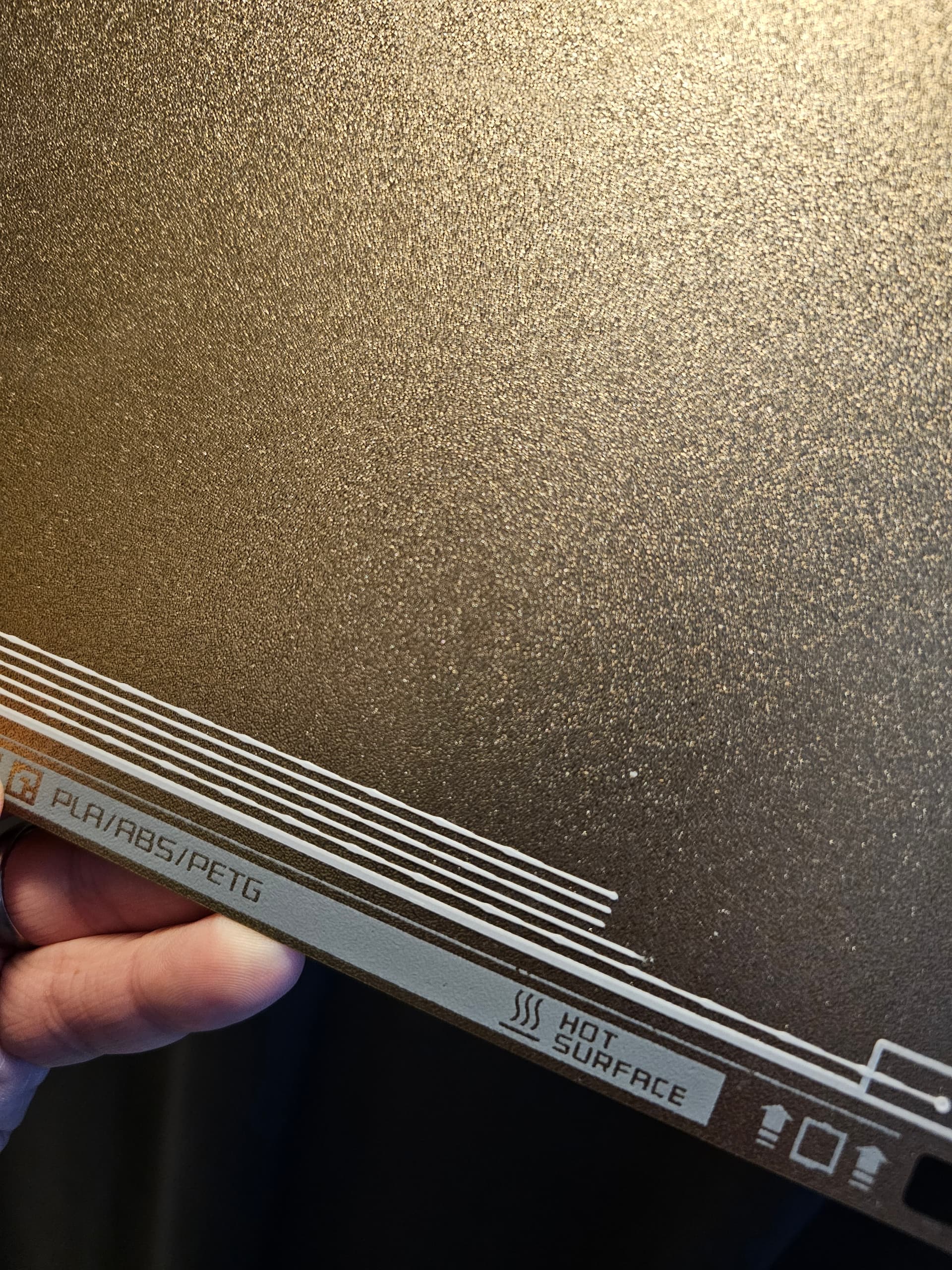

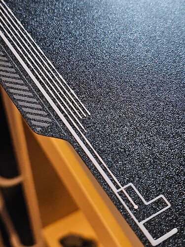

After resetting to factory settings and a full calibration, the result looked good again (better), but now the automatic flow calibration no longer works with the textured plates.
This has always worked well for me and otherwise a clean line always came out of the automatic flow calibration. Immediately after the update, no clean line came out of it, neither on the gold nor on the black plate.

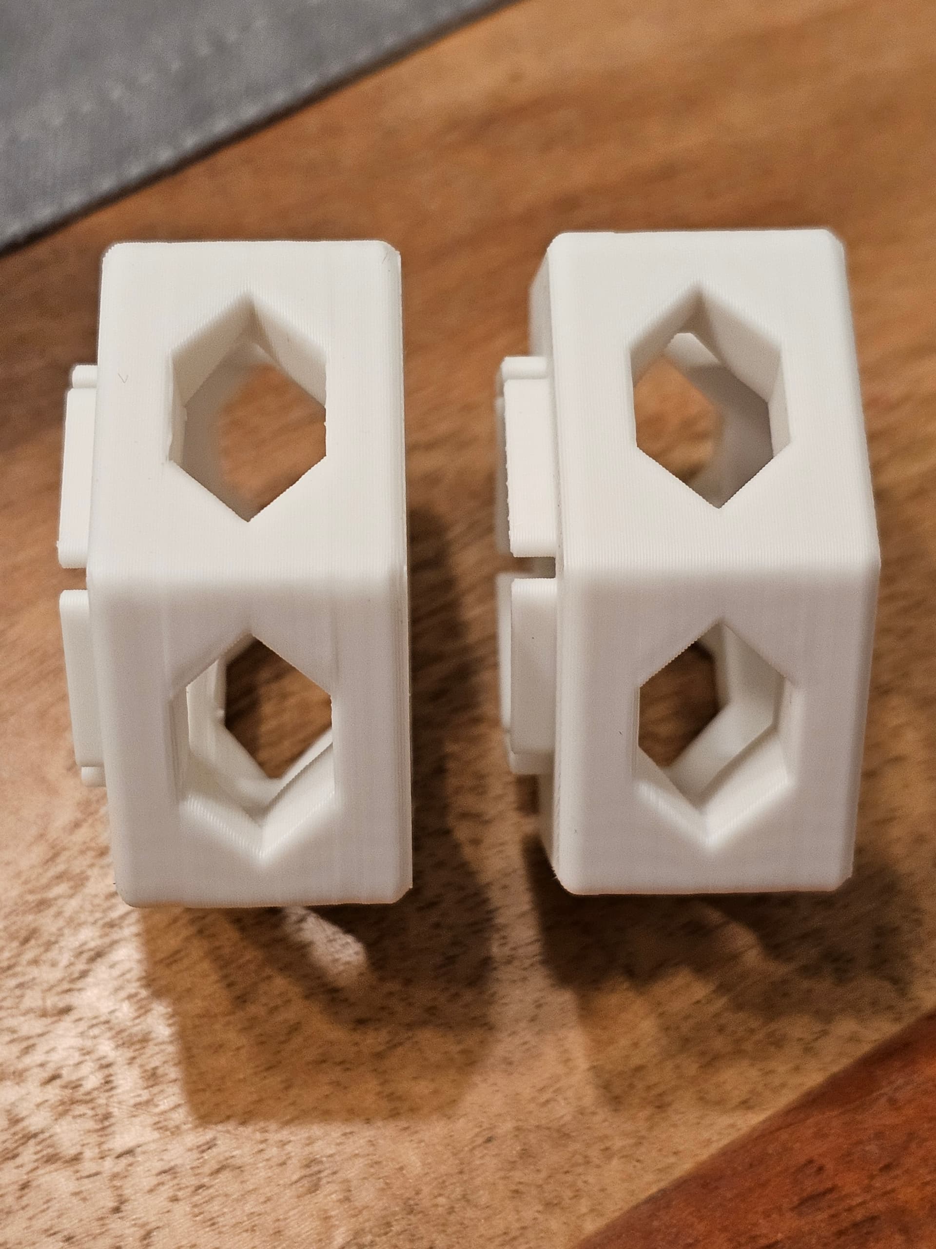

the result is that the result got worse
the same day before update (good/ok for me)
And after the update 1.7 and factory reset
Right before the update, left (all) after the update (e. g. large seam and other problems)
