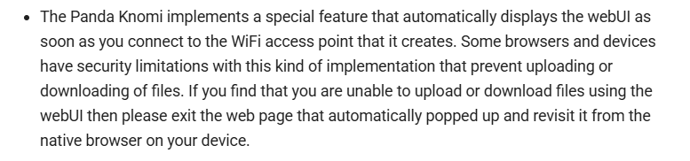

So the Knomi is one of the few Panda products I didn’t buy… but I just looked at the wiki and it sounds like when you connected to it with your phone a webpage should automatically open and show the webui. I also don’t have an iPhone but on Android sometimes it will block these popups and just put a notification at the top of the screen asking if you want to approve it.
Here’s where I found that:
https://bttwiki.com/PandaKnomi.html#important-notes
More info here:
Yes, I did read all that but when I scan the QR Code it is supposed to pop up the UI but it doesn’t. More great software that doesn’t always work…. So I finally decided to just connect.local to the bloody thing and I connected. It constantly tells me the communication reset and to reopen the browser page. Honestly, idiots wrote this.
