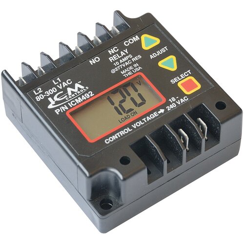

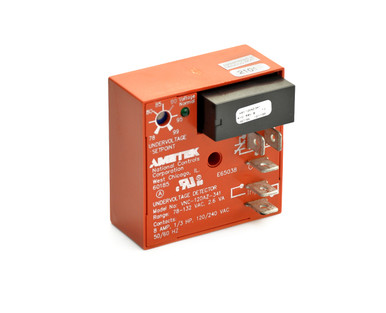

@designrama By chance I happened to run across this:
which is maybe a step closer to what you want, because it has a trimpot that would allow you to dial-in how much of a voltage drop you’re willing to tolerate before it takes the circuit offline.
I can’t say whether or not it would react fast enough to meet your purpose or not, but if not, probably someone makes a similar thing that would, using SSR’s or similar.
Also, an entire category of line voltage monitors that could be set for detecting the error condition you want and then reacting accordingly:
while avoiding short-cycling.
