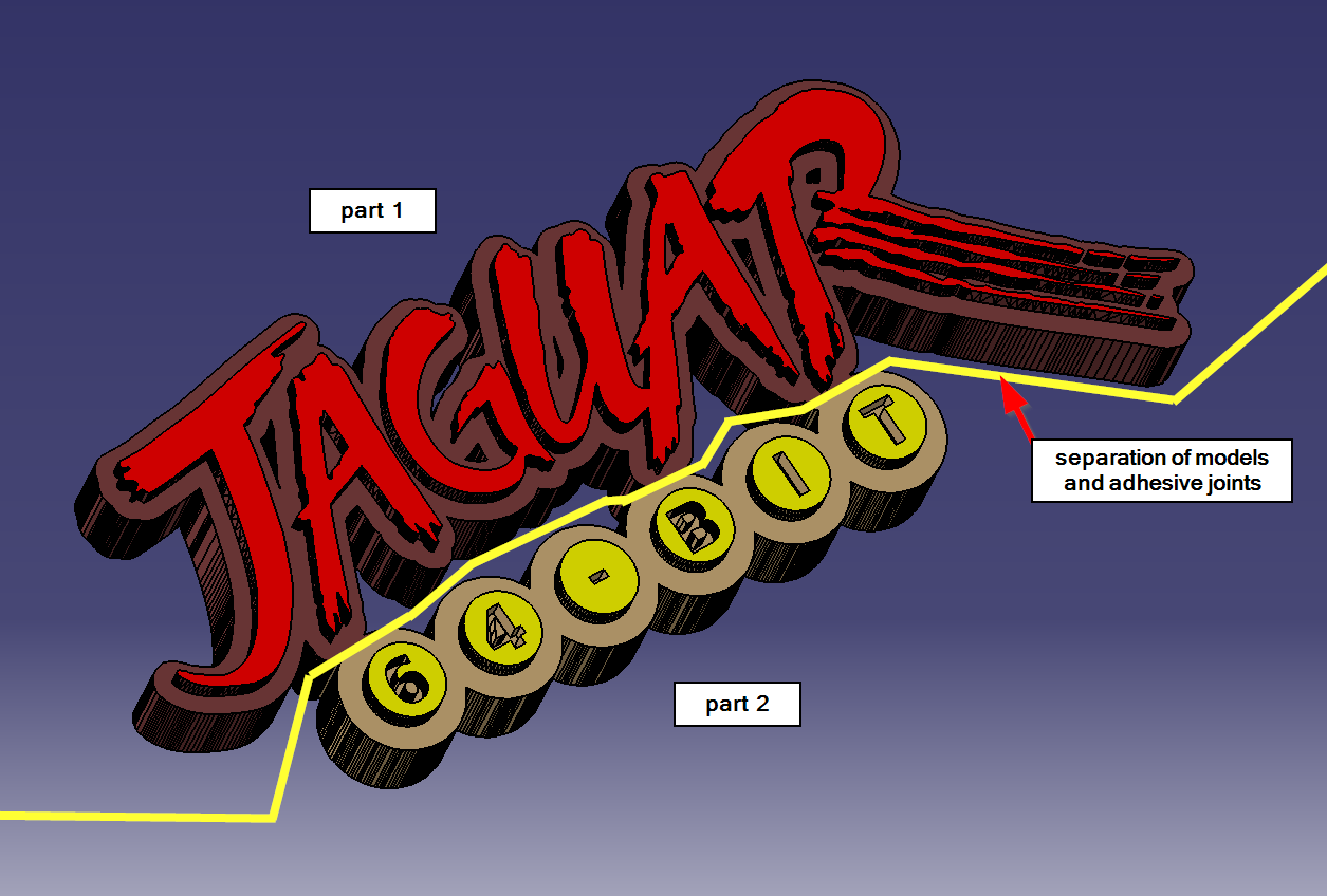

Print the red or yellow text separately and stick it onto the black background. But I’m worried that it won’t look good once it’s stuck together, as the individual parts are quite small.
I was thinking you could lay the print on its back in the slicer but then I realized that red and yellow would be on the same axis. How about only black & red then glue yellow? I guess it would be a snap with an H2D.

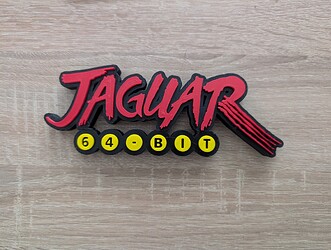

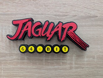

You now have a model with the black and yellow.

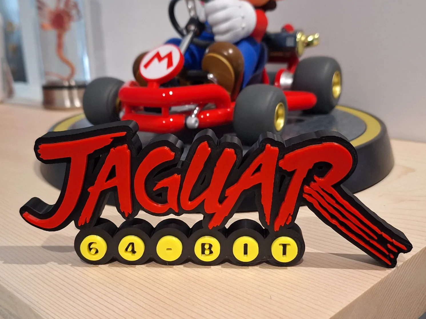

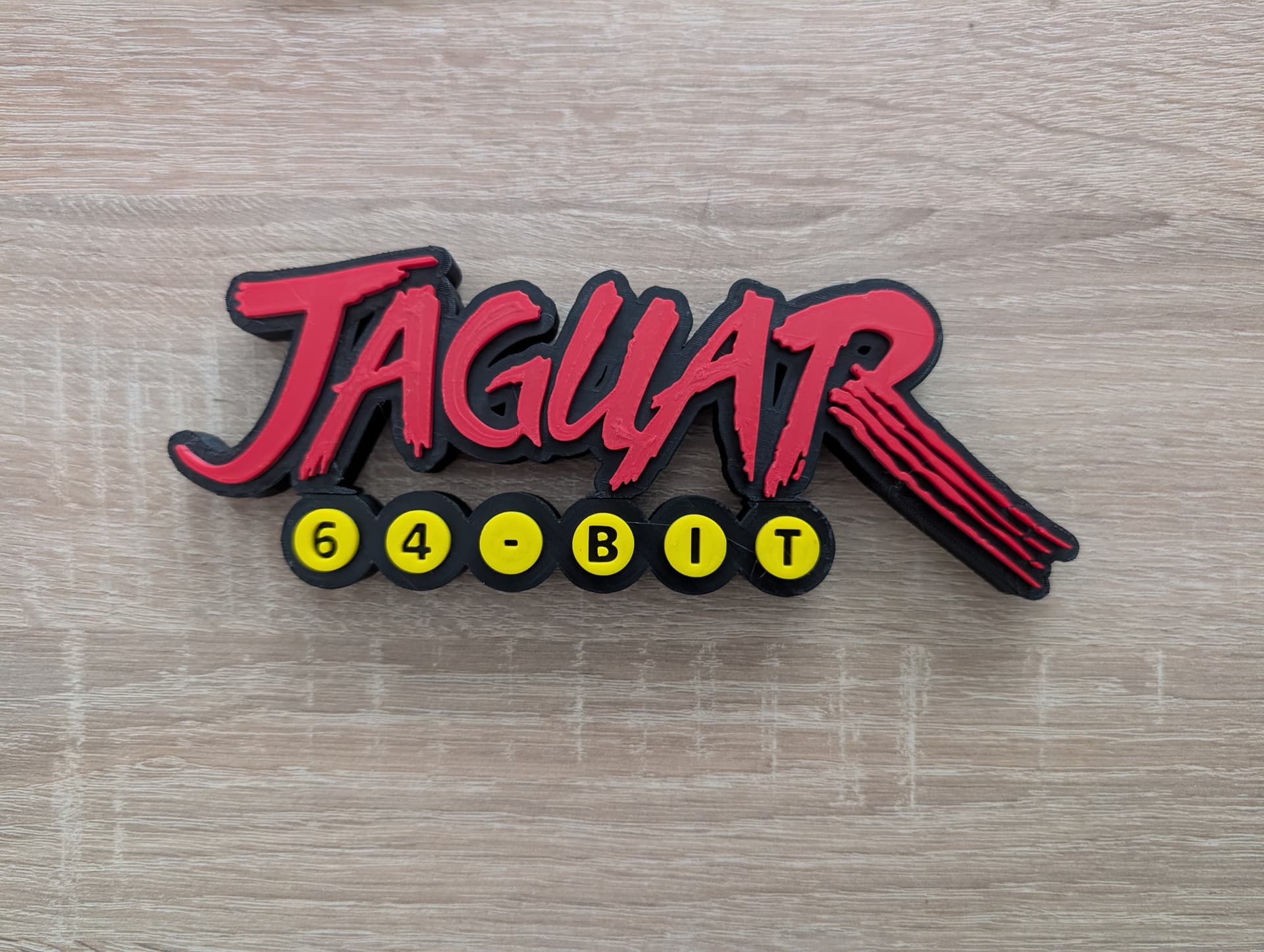

Glue the red letters to the black and yellow model.
