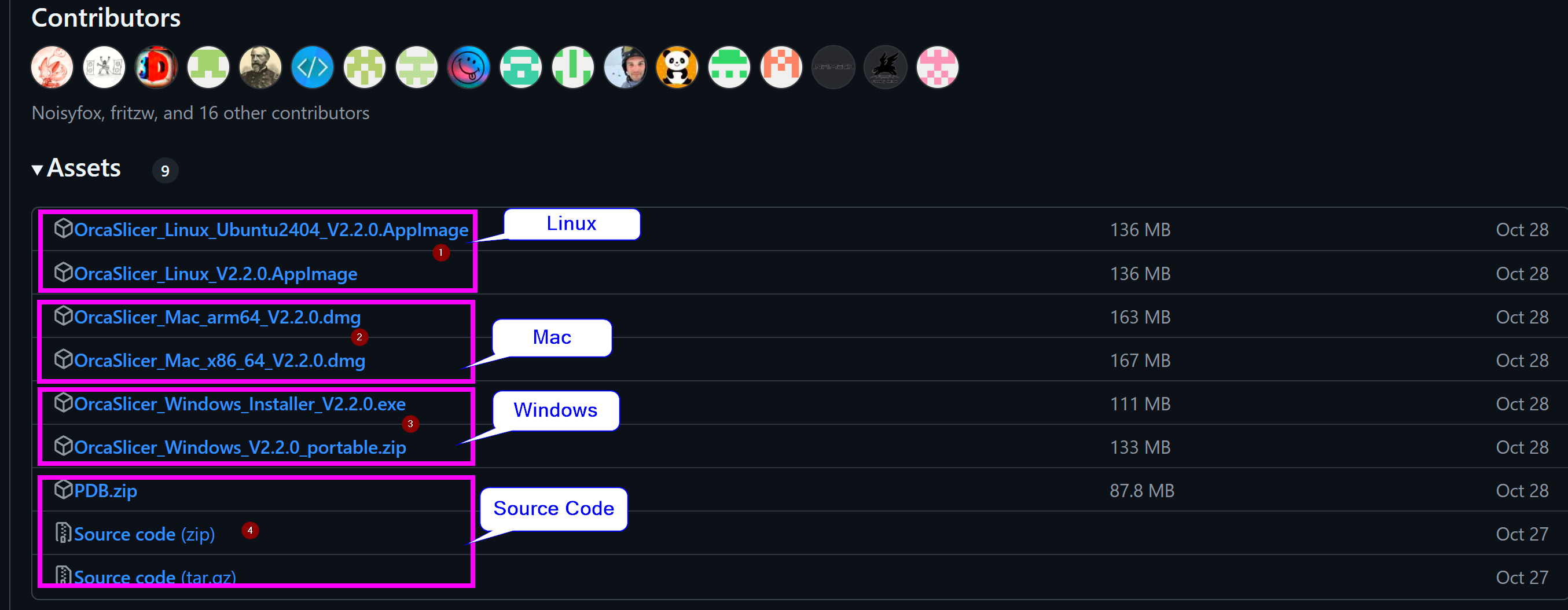

Orca Slicer is a fantastic example of how GitHub helps distribute software. Take a look at the image below—it shows the different versions of Orca Slicer available for download. Here’s the breakdown:
  1. Linux: Options for both Ubuntu and AppImage (a more universal format for Linux).
  2. Mac: Versions for both the newer M1/M2 Macs (ARM) and older Intel-based ones (x86), all neatly packed in Apple’s DMG files.
  3. Windows: You can grab an installer or a portable version (runs straight from a USB drive—no messy installs).
  4. Source Code: If you’re feeling adventurous, you can grab the source code and tweak it. Don’t like something? Change it yourself and share your version with the world!

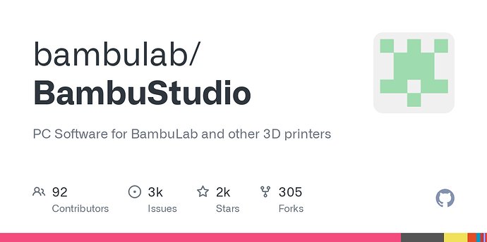

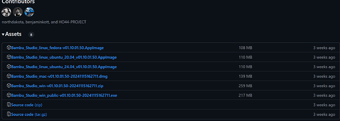

BTW: Here is the Github link to the Bambu distribution of Bambu Slicer if anyone cares to see what the product looks like from a developer distribution viewpoint.
You’ll notice that their are far fewer contributors since this Github page is supported by a commercial entity and has not invited anyone else to their club. :grin:

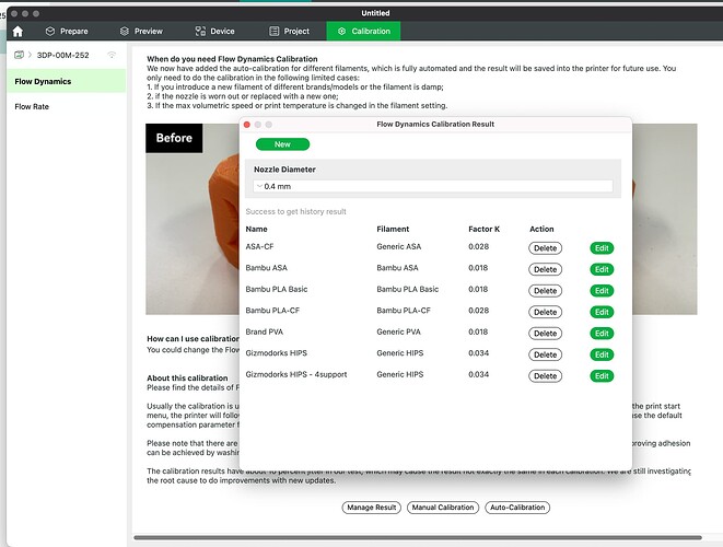

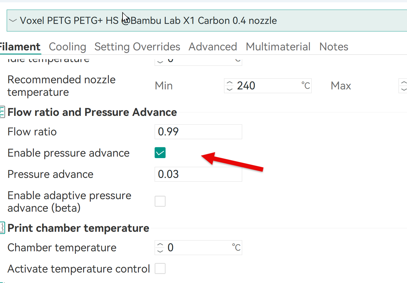

I profiled some Voxel PETG+ HS using Orca from the videos @Olias posted. It all went well, and I manually changed the settings in Orca and saved them in a new profile.
I then imported it into BS, and there is no option to enable pressure advance, so I don’t know if the option is activated.
Interesting, maybe another reason one might consider using Orca if you need to adjust PA. Thanks for sharing that.
I know this isn’t the question you asked - but why not just stay in Orca? It is fully compatible with BS, all your BS projects, and does all the BS stuff. It is a fork of BS with extra features.
Putting that idea aside - to answer your question:
I think that if you want to use the Orca PA number in BS…it is best to go to the ‘Calibration’ tab in BS, click ‘Flow Dynamics’ on the left. Click the ‘Manage Results’ button on the bottom, find your filament in the list and change the K value. I’ve not gone this route though, I just stayed in Orca.

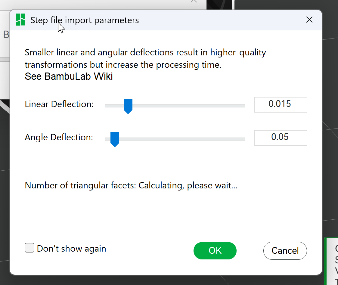

I would stay in Orca, but when I import step files, I do not get the Step Import parameters as I do with BS.
