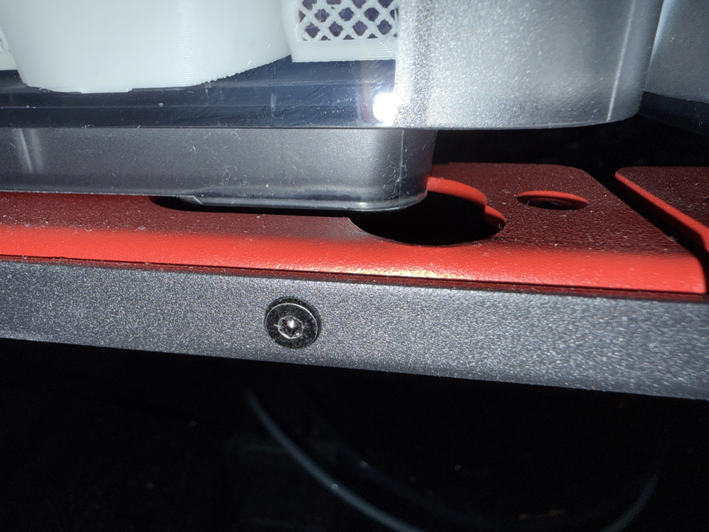

On mine the feet for my AMS 2 Pros just barley go into the holes on the Perch. They slide around a lot. How do your feet fit? Did you need to do anything fancy? Thanks
