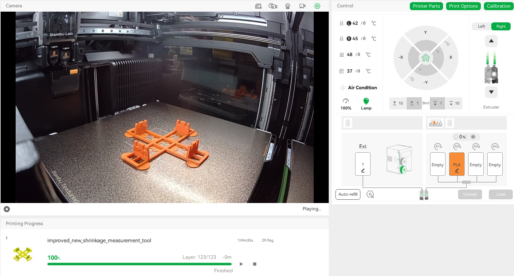

The reason I ask is that I have so far been running my AMS2 without any heating at all, and the HS-PLA I have in there got wet enough in just a few days that I’ll have to re-dry it. And I had thoroughly dried it before putting it in to begin with. The itty-bitty desiccant packs that came with the AMS2 are evidently insufficient by themselves at keeping the PLA dry. I thought it would be more air-tight than it evidently is. Therefore, I replaced the wet spools with freshly dried ones and added something like eight 100g silica gel desiccant sachets, and so far that’s doing a good job of keeping the interior RH at around 8%. So far, so good.
Screenshot 2025-04-16 222453
[As you can see from this picture, the RH evidently dropped out even more, for, as you can see in the screen scrape, the AMS2 is reporting the interior chamber humidity at 0%RH!
Why am I telling this? Well, I found enough space inside the AMS2 by currently having only two spools in there. The AMS2 HT isn’t going to have all that free space for stuffing in extra desiccant to keep everything nice and dry inside if its heater can’t be run while printing. Also, AMS2 HT can’t do an auto-switchover to a backup spool if the one spool inside it runs out. So, worst case, what net benefit remains? Like @maximit said, what’s left is the extreme convenience of adding new spools and easy removal of spools that are no longer needed. AFAIK, that’s something that only a Bambu AMS, of one stripe or another, can offer.
