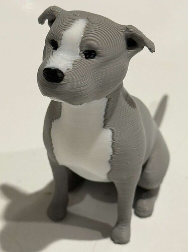

I’m happy to say that my results are improving. I factory reset the printer and re-ran all calibrations (including the heated bed leveling) and printed this little guy as a test of running three colors and he looks much better than the first time I printed him. I’m experimenting now with “new support for PLA”. I’ve had a couple of print failures when the support structure came apart as new material was being added. I need to investigate the parameters and set up Bambu Studio to be more robust because I think it’s just a matter of the software trying to save too much material at default settings.

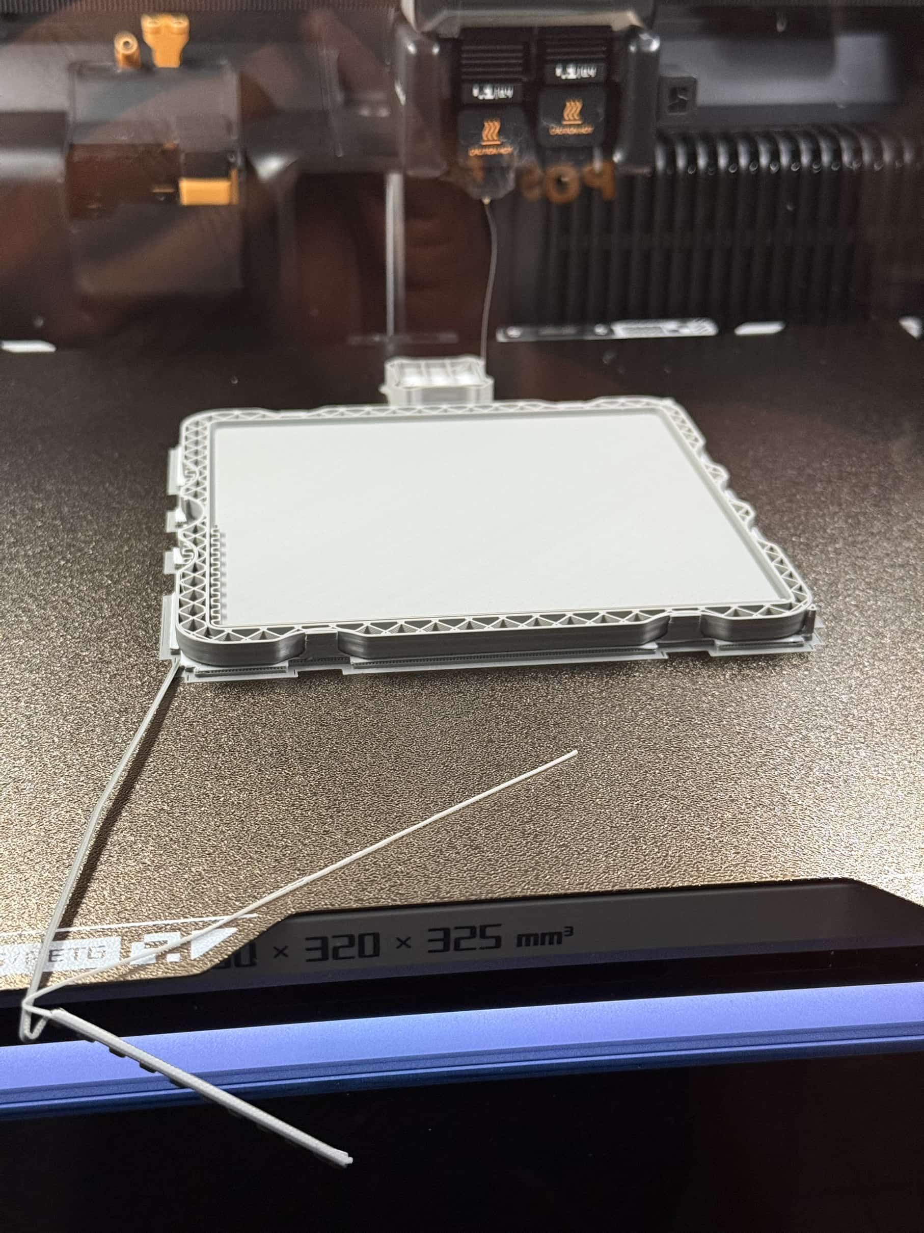

Here is what the support structure failure looks like. Laying more PLA down broke a thin support wall away from the layer of support material. I’ll sort it out.

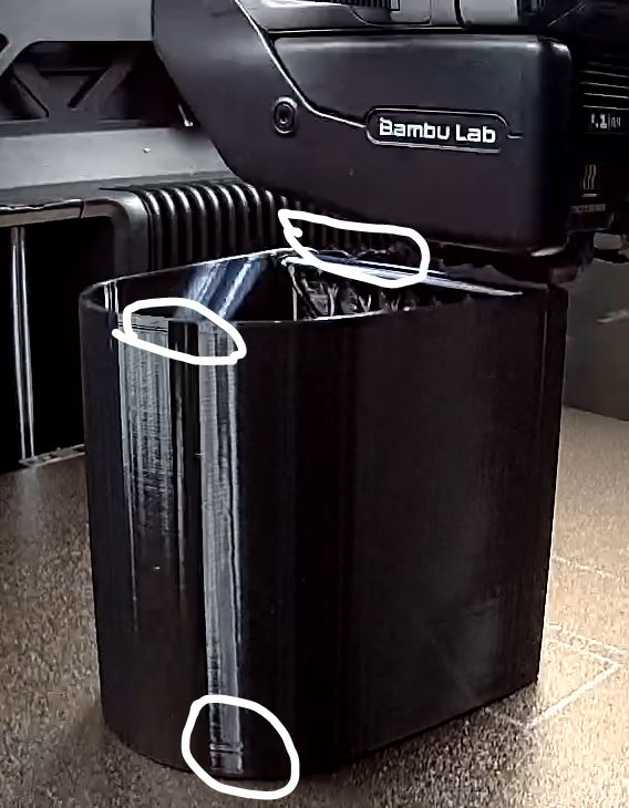

Check how the part cooling fan is performing on your print this has caused issues in some of my previous prints. The cooling controls really need to be more like what Orca Slicer offers. I’m getting too much cooling on the top layers, especially when printing over the interface layer, and then the outer walls are being over-cooled. If I disable cooling for overhangs, they don’t get enough airflow but it stops the problem. I’m hoping this gets fixed soon I’ve already submitted a support ticket in the hopes of a slicer solution soon.
I dont know if your part is getting over cooled check out the fan speed in the slicing result and see what it doing.
This was one of my 0.24 layer PETG parts that got over cooled.The walls cooled too much, and the PETG didn’t adhere properly to the interface layer.
Luckily, the part still turned out okay I had to have overhang fan on do to transition to a round tube.
EXACTLY!
Cooling on the internal bridging layer (interface layer) on H2D is REALLY TOO MUCH.
