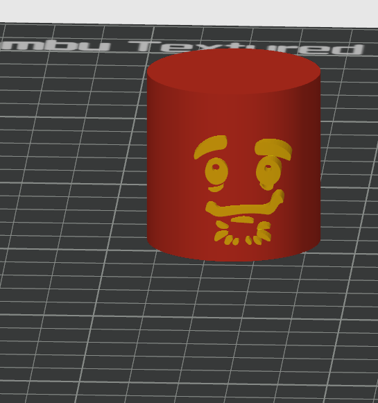

So I am still learning how to create stuff in Bambu Studio. One thing im trying to do is add an image flush to the surface. Here is an example:
I have a basic cylinder. I add a face model that i found using a modifier since i want it flush with the print.
So when i slice it it looks like this:
So everything looks good, but the modifier is a single color. I want parts of the modifier to be different colors. Is that possible without splitting the modifier to multiple modifiers? If not, I think that would be a cool feature to add. Either that or if you add a part, you can have a cut option to make it flush with the main object.

You are correct about it not being made for curved surface. This was just a test one. More like a concept of what I wanted to ask. I figured out how to do in all through Bambu Studio. You just have to split the file to objects then just export the different colors as different stls. That way when you import as a modifier, you can just change the color. While this method is “okay” with simple designs(as in each peice is mono color), it would be a nightmare with more complex ones. I wish Bambu studio was more of a all in one program since most printers nowadays are plug and play. You get a lot of people without design backgrounds (like blender and fusion). I think it is getting there, just not yet.
As a little fun fact: you can overlay multiple modifiers to do color printing. An example i did using the model above was adding cylinders in the eyes as a modifier to make the pupils white instead of the background color, since coloring the print does not take in account modifiers

Yeah that’s true. I guess i mean more of a simple version of a cad program. Like for example microsoft standard photo app. It can do a lot of the basic stuff, but you need to use an actual editing software to get perfect editing. I think something like wraping an image on an object and be able to paint it would be simple. I do agree with you. Degining insane stuff in bambu studios is not the way to go and never will be. Just wish they have more stuff for basic things so you dont have to hop into a different program for something so small.
So I was doing some experimenting and if you set it to a negative part, you are able to combine it together. So it gets rid of the negative part item and merges it into the object. Something like that would be cool. That way you can apply the change of the modifier, then paint it afterwards.
