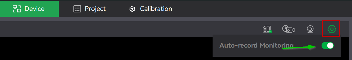

Is there any way to record normal (NOT timelapse) video?
I was about 8 hours into a 12 hour print, when my X1C notified me of spaghetti errors. Well, it wasn’t JUST spaghetti; one of the parts had come loose. I suppose next time I’ll use a brim. Regardless, even looking back at the timelapse, I have no way of knowing what ACTUALLY happened. Did it collide with the nozzle? Was my adhesion just that bad? Who can say?
Anyway, if anyone can tell me a way to record normal, full-length videos, I’d be really appreciative, because I can’t seem to find anything.

Yes there is. It’s been a long time since I tried this so it may have changed. However, you have to enable video recording via the device menu.
Then there is a folder on the SD card card called “CAM” where the full length AVI’s reside. Note that these are reduced frames depending on your printer model. So at 5frames/sec for a P1 as an example, the video will appear to be hyper-speed. However, it is the full camera capture feed absent time-lapse frame capture.
All videos in that folder start with the letters “CAM” and are unindexed AVI files, so you will have to index them yourself and save them. If you have experience with time lapse then I’m sure you already know this.

So I just finished the 2nd attempt at the print; fortunately there were no issues this time around. I had checked the “auto-record monitoring” before, I just didn’t know about the non-indexed files. When I popped the SD card into my computer, there they were in all their glory:
Thank you!
So, if I’m understanding correctly, turning on timelapse doesn’t prevent it from doing full video recording. It just does timelapse along with standard video, so long as the “Auto-Record Monitoring” is toggled on.
Total file size of the videos for my 12 hour print: 18 GB. Worth it to have something I can look back at if there are issues.
That is correct. The two function independently from one another.
