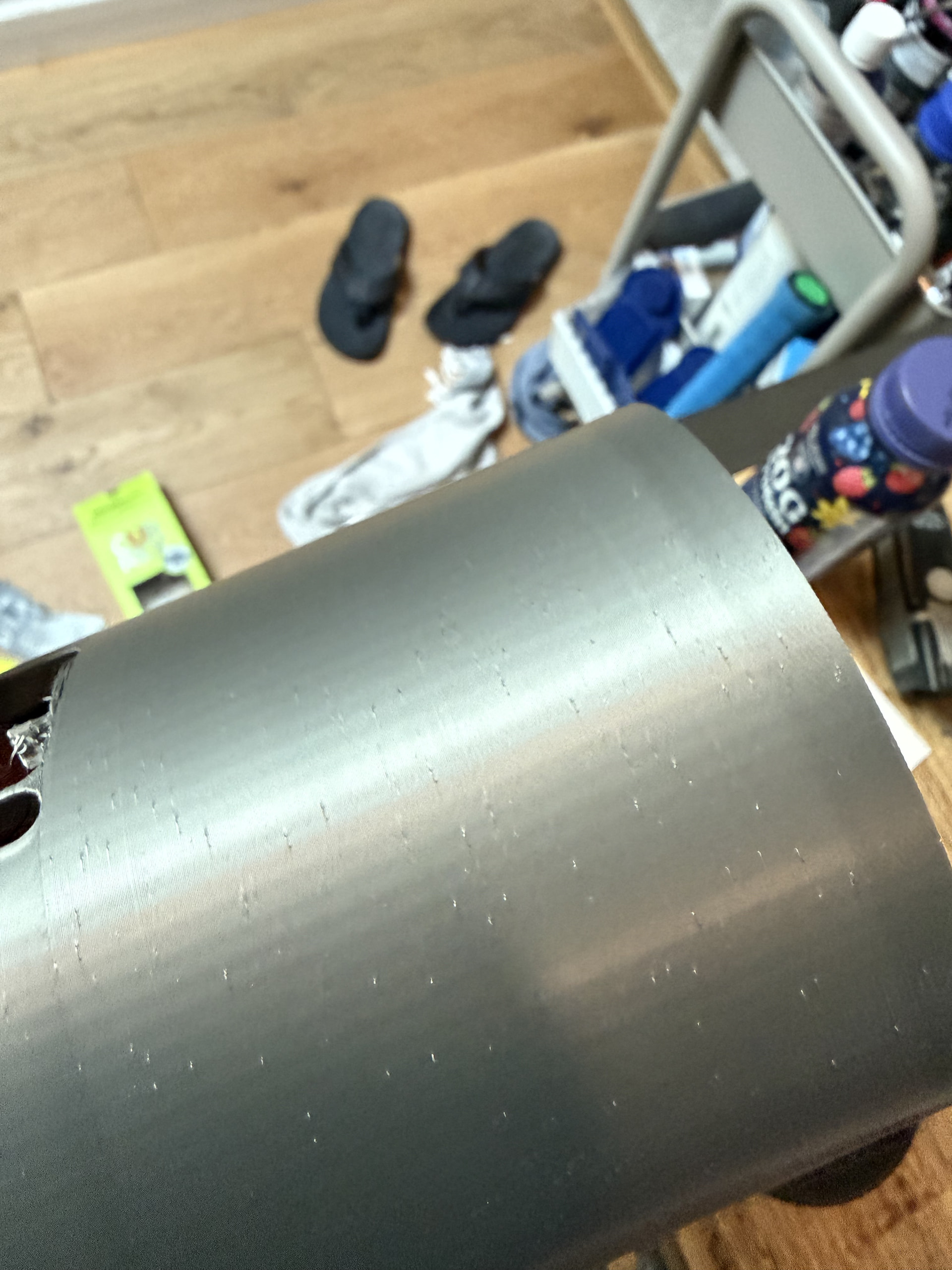

Is this moisture in filament?
Started getting artifacts in my print
Probably not, it looks like your outer wall speed is faster than the recommendation for your filament.
Moisture or seam is set to random.
This is a seam set to random.
I did set the seam to random, didnt know it does this effect.
Also i lowered the inside wall and outer wall speeds for this print .
Will try to mess around with both.
