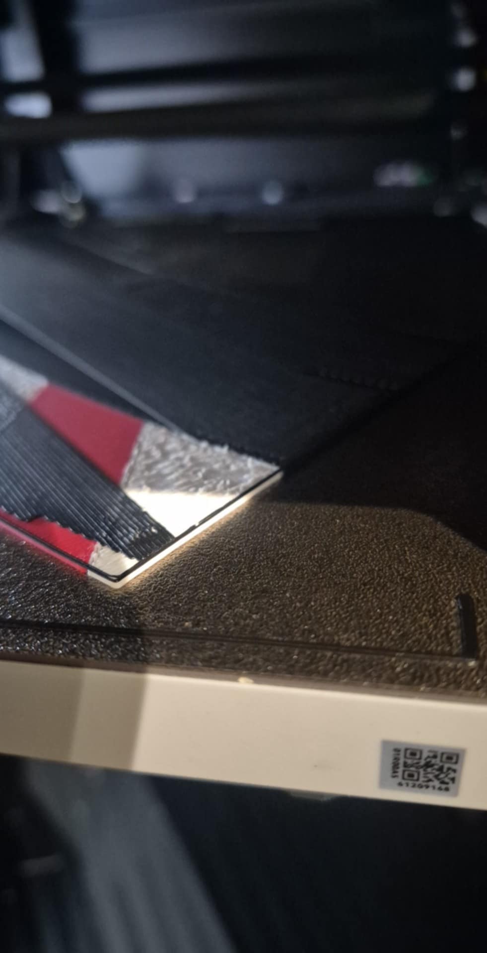

here you can see a pic of the part printing

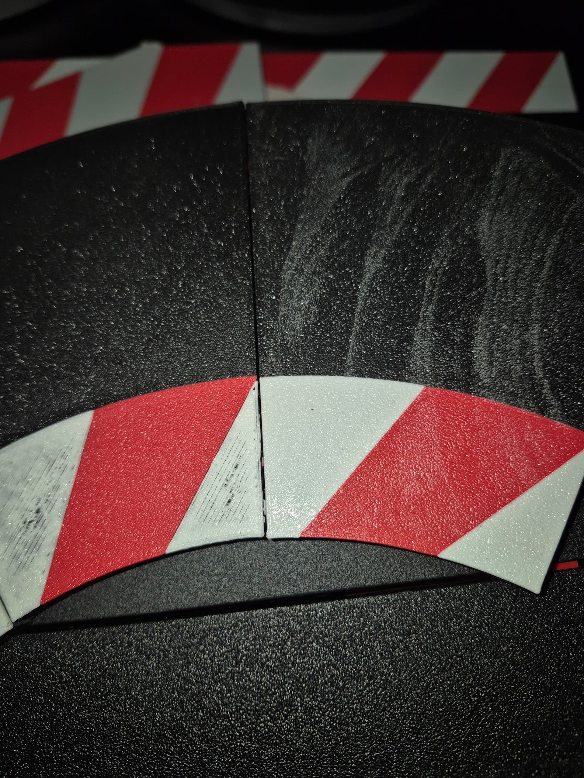

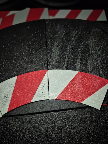

here is 2 of the final parts
1 is on a textured PEI plate the other is a smooth
can see what looks like colour bleeding through the white, yet the red is unaffected

Not 100% certain but I don’t think the white is dry. Matte filament can be a pita when it comes to moisture. Being new is no guarantee that the spool is dry.
Bump the drying temp to 55 and set it for around 12 hours. The current way the AMS displays moisture is far less accurate than it should be. The old way was much better, don’t know why they changed it.

It looks like you might want to make the white a little more thick, or your filament is wet. Make sure you have a filament dryer, or manually dry your filament
not sure how i make the white thicker… the previous prints from a different spool are perfect , i have it drying over night around 50-55deg will try again later see if it helps, im in AUS and quite wintery currently , soi can get that it has absorbed some moisture, i just dont get why its only the white
White is very see through, so it’s probably causing your white to become more translucent.

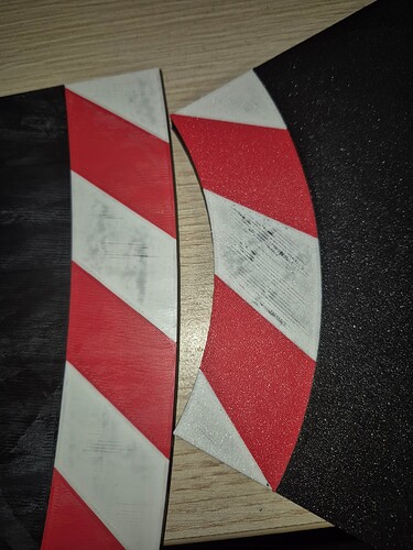

this is 2 of the same model printed a few days apart with the only change in the white filament
you can see the difference

PLA isnt that hygroscopic as people might think, unless there are additives involved ( e.g Silk) What i would do, if youre not using BBL filament, would be to calibrate the flowrate ( maybe calibrate that specific white one) second, i would set the print with more layers of white before switching to black.

its definalty better after drying, but not quite there yet , not sure i dried it long enough… or my creality drier sucks!

The first pic looks like it could be the plate. However the red is sticking well as does the black. Would be weird if only the spots where white is put down have adhesion issues. You can test this by using a different color. If it has problems then clean with the usual, but don’t dry with a cloth. Use paper towels. Washed items usually have fabric softener or detergent still on them, which can transfer to the bed. I’ve had great luck just using paper towels to dry, sometimes clean.

Investigating a bit more, try bumping the temp on that filament by 5. Print a test square of only 1 - 2 layers and see if that improves the problem. I wouldn’t bump it more than 10. Even filaments from the same vendor can be a bit different. If that doesn’t work then stop listening to me. Plenty of people will tell you I don’t know anything, ask my wife.

hahah thanks for the answer! im a bit with you actually, i dont dry the plate with anything, i either stick it on the bed and heat it , or put in front of the fire, im having issues with some PLA CF a mate said it could be due to the cold ( its quite cold here in AUS atm , so your idea of increasing the temp is one to try , as well as dropping the fan speed to slow the cooling down
