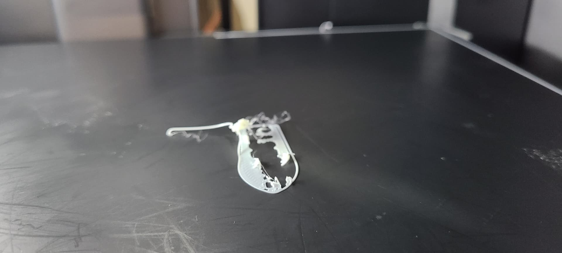

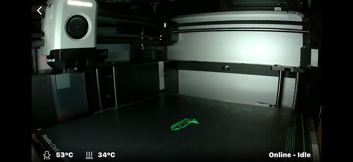

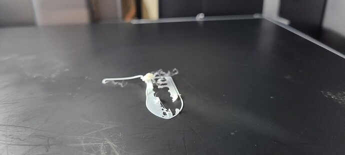

Hi All,
I am guessing this is fairly common and when searching for first layer problems done the basic generic troubleshooting.
Printer was originally on the same stand as my old Anycubic Mega S, to the floor, in case the table was causing a wobble.
Washed the PLA build plate with dish soap and cleaned with a microfiber cloth.
run recalibration multiple times, check out the wiki links for maintenance on the lead screws and bed leveling.
This are the images of the it failing on the first layer.
As I finish writing this and go to test with a different generic filament, I have iht an error with unloading the bambu PLA filament, when doing this the roll seems to be bouncing up and down and struggling to retract…

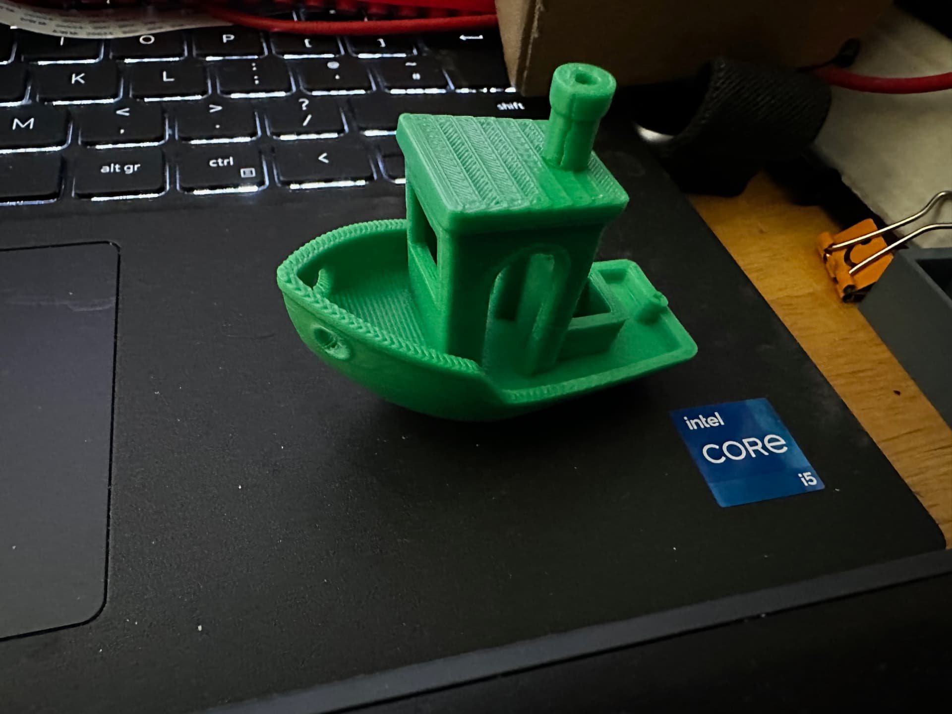

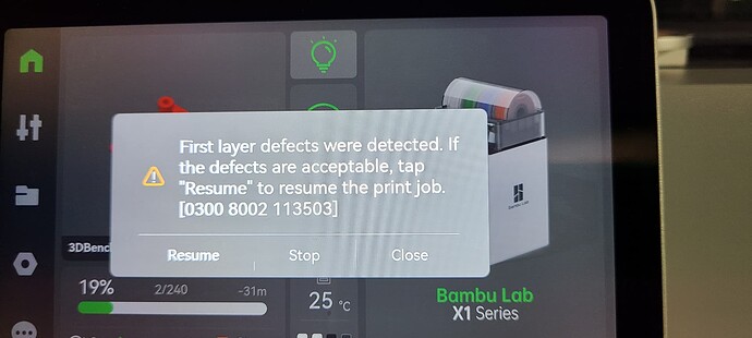

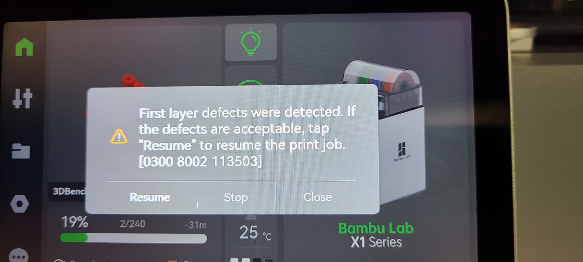

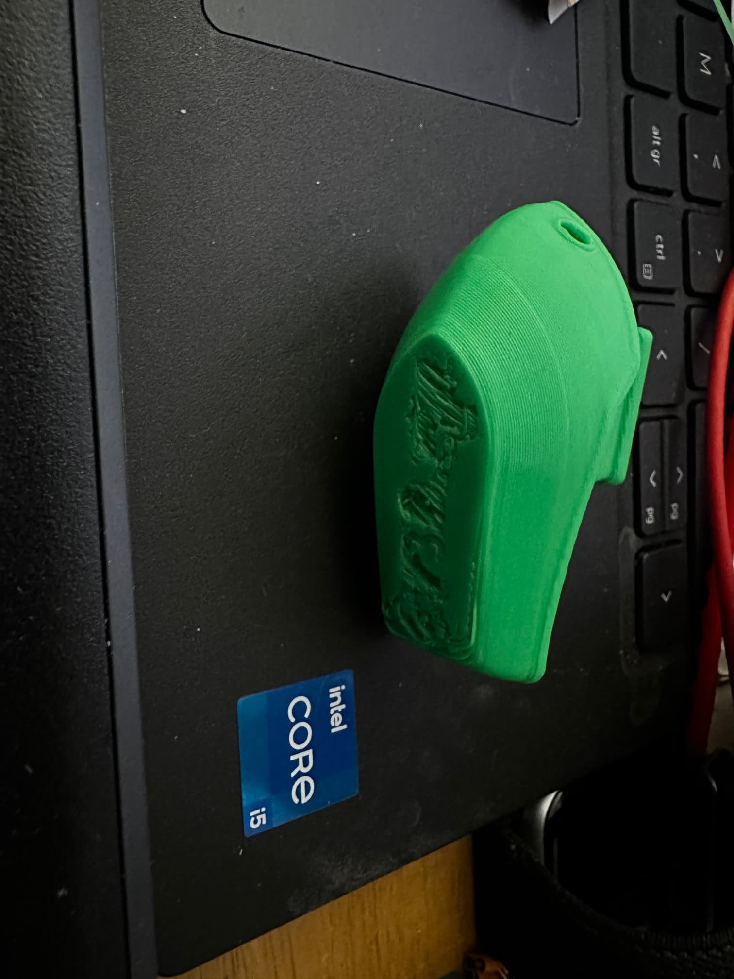

[Edit2] so it still looked like a fairly poor first layer but it hasn’t triggered the AI first level error.
and has completed.
So first layer was fairly poor, but it continued anyway and the rest looks pretty good from my brief experience with the Anycubic i3

There are know bugs in the default models stored on the machine in firmware 1.06.01. I highly recommend only printing from Bambu Studio or Orca Slicer and/or updating to the new 1.06.03 version.
I also found that the original cool plate that came with my X1C was totally unusable for some reason and I never got a print to stick. After replacing the surface with one of the included sticker surfaces it worked fine after that.
I Confirm !
Don’t use the defaut models stored on the machin, particularly the Benchy. In the folder C:\Program Files\Bambu Studio\resources\model you have the stl file of a 3D model of Benchy. SIice it with Bambu Studio and after print it. You should have a correct print.
This look terrible , did you calibrate the printer
Did you dry the filament
And as others suggested use the benchy from the Studio
But such a bad adhesion have not seen, since i used bad Isopropyl initially
I just clean with soap and water and let it dry, after almost drops dry the bed heating is perfect to speed up the drying no cloths as never sure if no some oils
I had issues with one cheap PLA filament and end up in the bin , even after drying was not extruding properly and terrible adhesion and was breaking all the time.

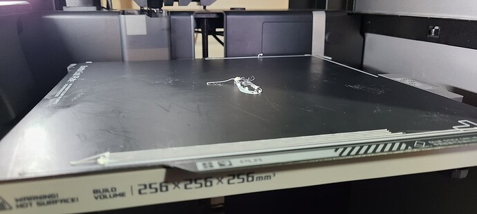

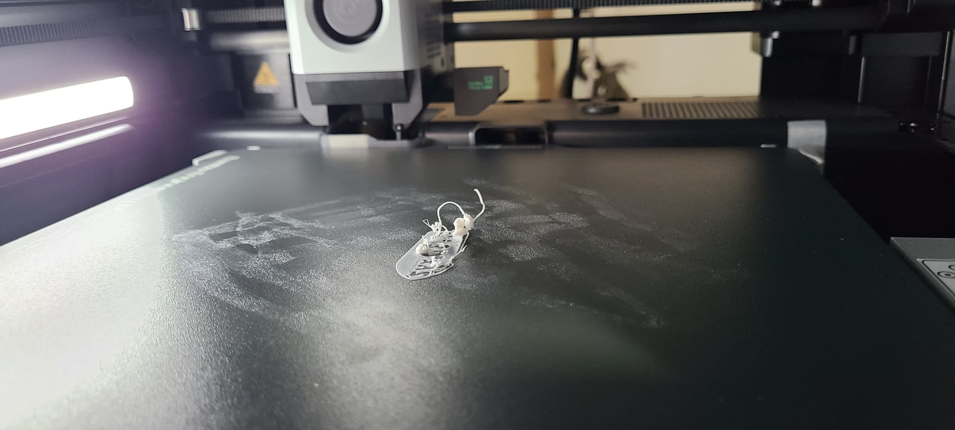

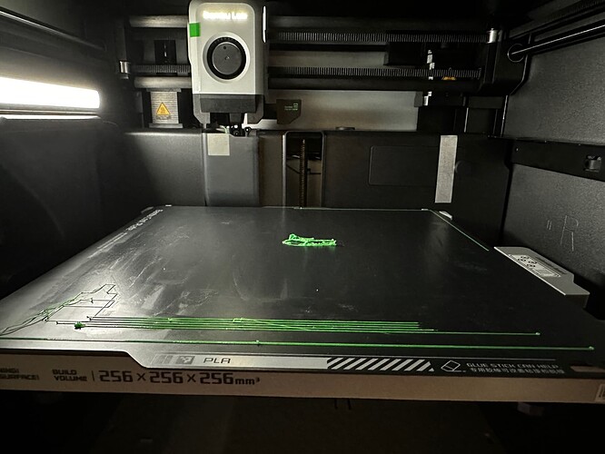

I am having the exact same issue. When I 1st got the printer it printed, oh, maybe 50 prints more or less perfectly right out of the box. Now, after a bed crash into the bottom during manual moves, I have had many, many issues. Failed Calibration, failed homing, failed self test. Self test and homing issues fixed by replacing a WARPED WASTE CHUTE with a new one from the factory. After that, did a factory reset, passed self test and calibration, and getting this…
Original Cool Plate, all default settings on 0.20mm Standard @BBLX1C, Version 01.07.02.00, Overture PLA Professional, using Bambu Glue Stick on Plate. WTF??
Tried the Engineering
Plate…
Check to see that your nozzle isn’t bent.
Wash your bed with soap and hot water. Pat dry with a clean paper towel and don’t touch the build surface. From what I’m seeing you have adhesion issues. The oils from your hands will wreak havoc on bed adhesion.
