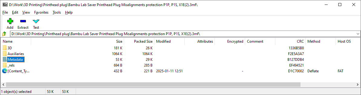

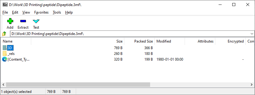

Not really any experience troubleshooting 3mf files but your file shows content of:
While another 3mf file shows:
Seems like things like metadata are usually important, but I am just guessing.
