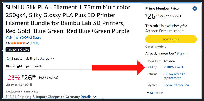

Just to rule that out: Check to see if it was really an official Sunlu store or if some seller snuck in and you accidentally ordered from there. Unfortunately, a lot of counterfeit products are now being sold on Amazon - including in the 3D printing sector.

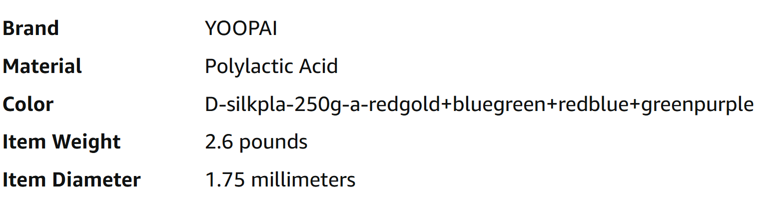

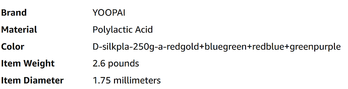

Here’s an example from Amazon US: Sunlu filament - but not from the official Sunlu store.
Suddenly, the brand listed below is no longer Sunlu, but: YOOPAI
I’m not saying this store sells counterfeit goods; I’m just demonstrating a point here.
