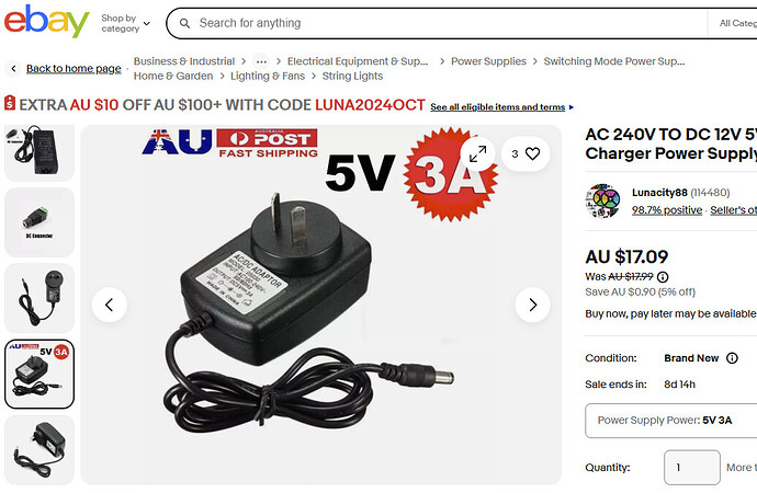

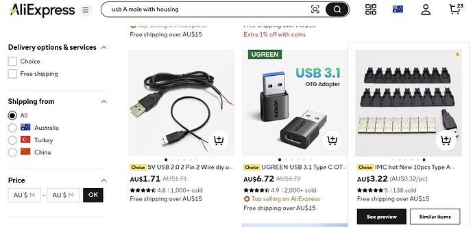

It’s quite straight forward actually. That LED strip was designed for 5V fortunately. You just need to use a 2-3A 5V phone charger for that LED strip.
So, just throw away the thin cable come with the LED strip and solder thicker cable like AWG20 or 0.5mm² (cross section of copper core) which can do 3-4A continuously. You can buy the USB A plug easy from aliexpress or amazon.
Please note, unspoken agreement for current consumption of standard USB port is 500mA or under. Thus, the pre-made USB A cable from aliexpress is usually sastify that but not good enough for your LED strip. The copper core of those cable is quite thin, probably AWG22, AWG24 or 0.3mm².
That is ‘USB compliant’ route.

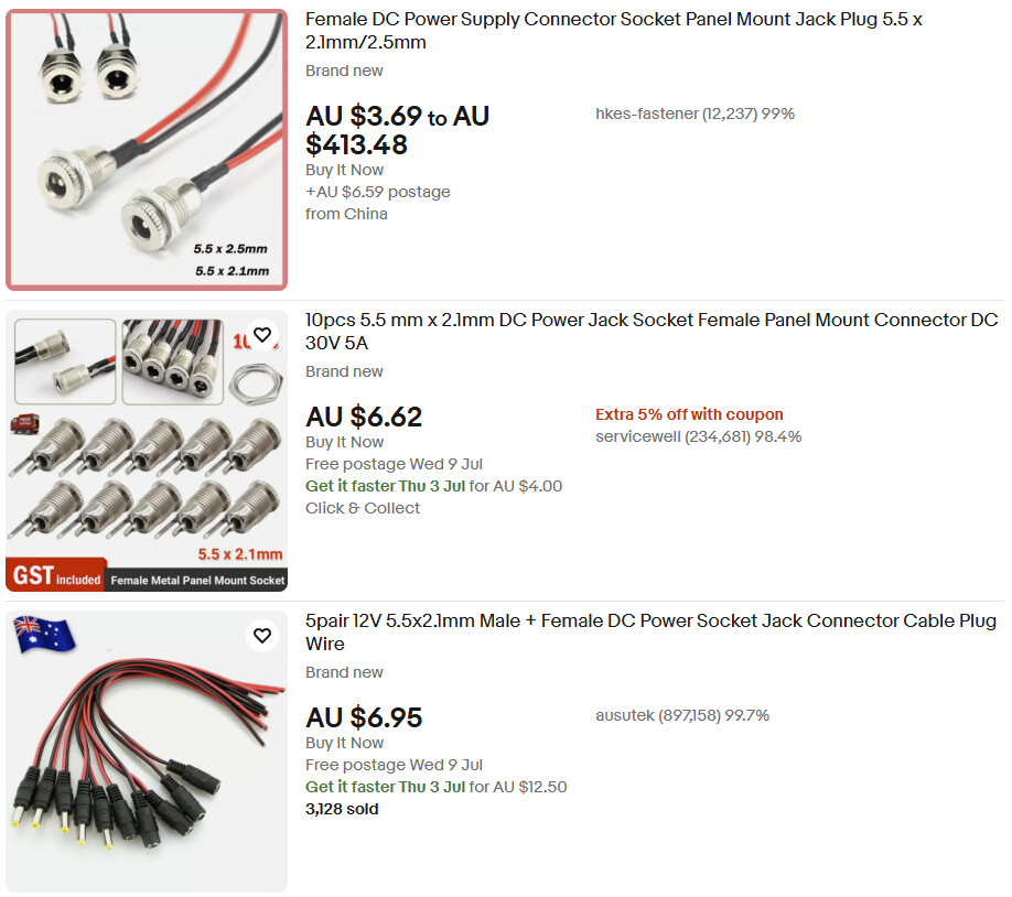

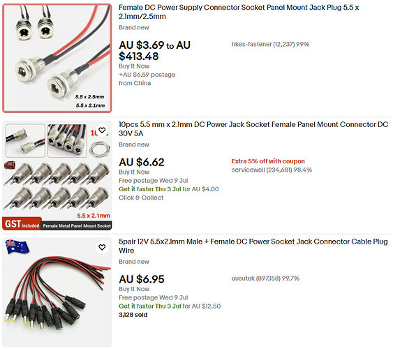

But If you don’t have a 2A-5V charger (not PD or QC3.0 stuff) and you have to buy one, then just buy a 3A-5V wall adaptor with DC barrel jack. DC barrel jack is more reliable than USB plug/socket.
And buy female DC jack (with or without cable).
