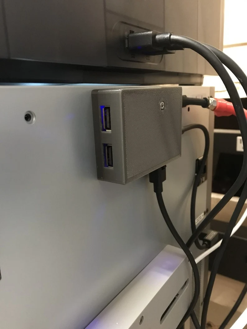

On my project list is to run a real multiport USB station and bring the power supply barrel plug through the hole on the top front right corner of printer.
As an aside, I would not be surprised if Bambu uses that USB-A to program or download data to/from the printer and since people are going to find it, they tell you it is there but the power flowing out of that socket is quite low. Saves them having to keep answering questions about it.
Im getting near to getting some sensors wired and programed to mount in case and that USB port will not provide what I need. Picture is of what I am talking about conceptually but will be with ports side by side, NOT stacked like picture
