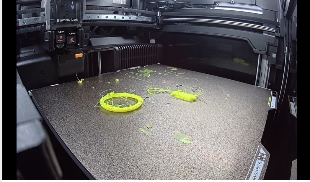

My spaghetti detection is till working. Matter of fact, it triggered today on this print, which may well eventually have turned into a blob of death if it had failed at the detection:
