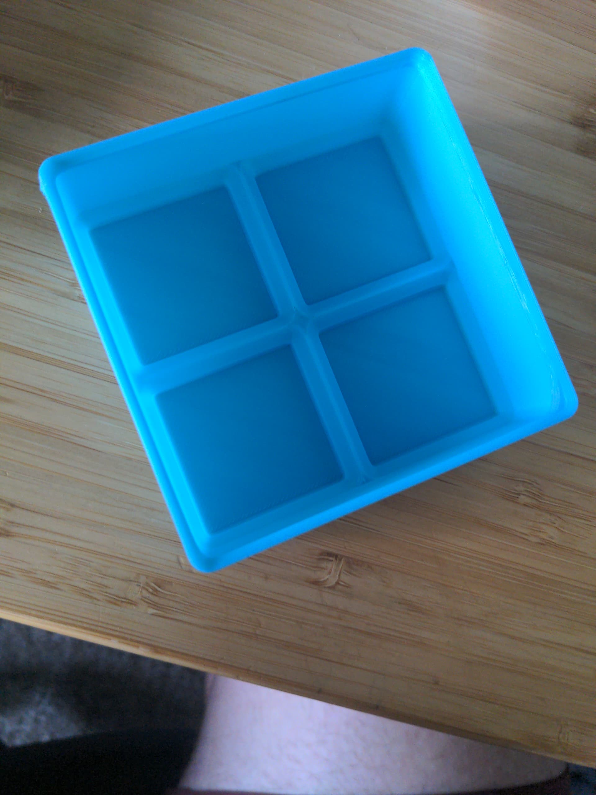

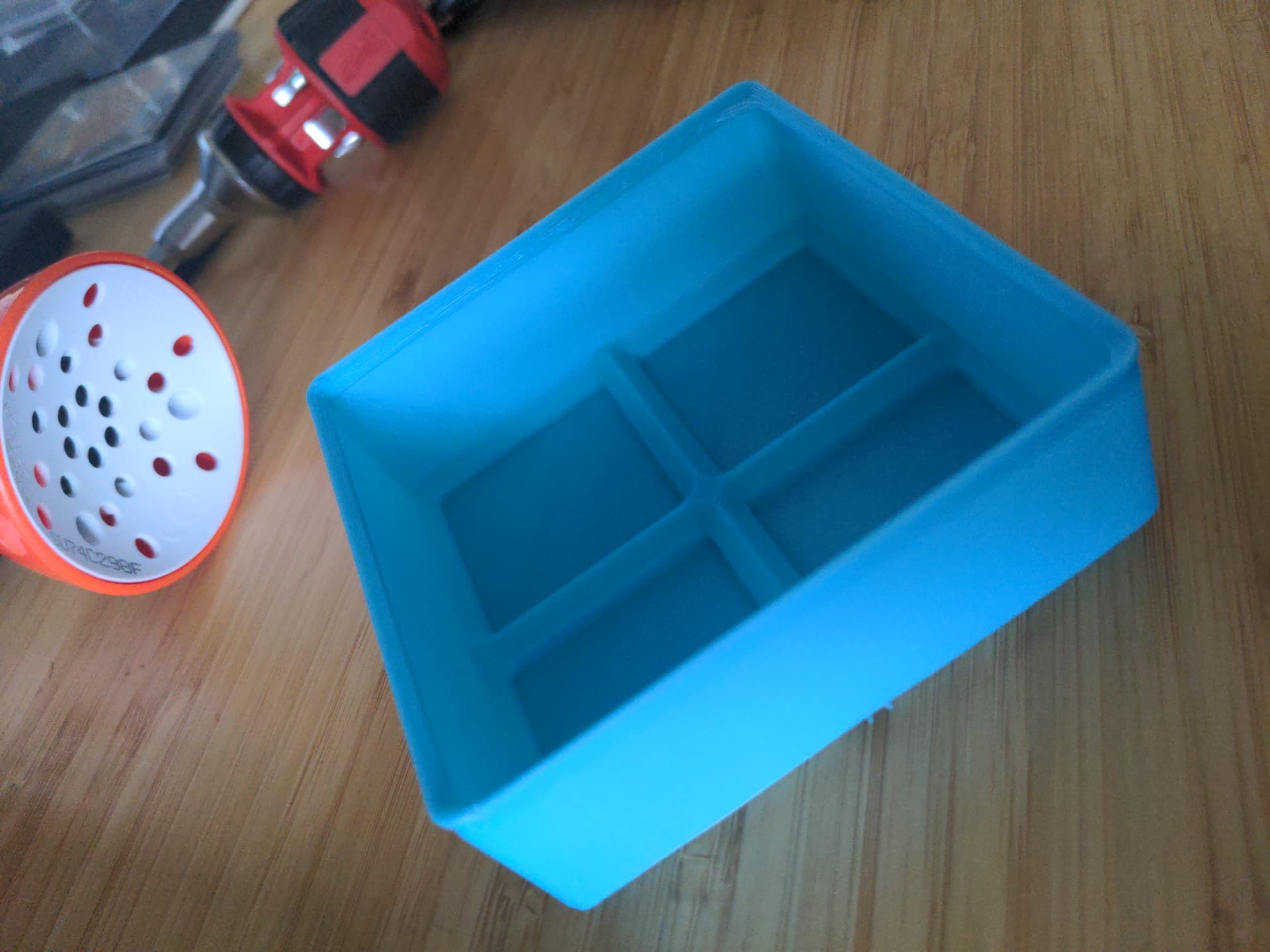

Hi, I have been fine-tuning my settings for Jayo PLA META, for my P1S with AMS in Bambu Studio V1.9.3.50.
Initially I was getting hopeless warping and / or very brittle layers.
I enlisted the help of all the deepseek AI that I could find and the result, I must say, is pretty awesome thus far. These are my settings for churning out the prints at super high speed; so there is some fine pretty neglegible hairs on overhangs but I am tinkering to get that out. I am still tinkering,but these are good results for draft prints.
So here goes, as a small note, I have NOT activated supports since I only had small holes in my prints so that’s open. Also, there is one difference in the gcode if you want to tune for more even more speed but that is only noticable if you have a very large draft. Else, the stronger setting is preferable.
I may update once I get the minimal hairs out, but that is really neglegible at this point. Stuff comes out really well.
Other notes:
KEEP DOOR AND GLASS CLOSED and do NOT open it even for a moment, you will get insta-warp, this stuff is highly temperature shock sensitive. There should be a warning if cabin temps rise too much (in the gcode), so at that point you could consider to leave 2-3 cm of the door open.
THIS IS ON A SMOOTH PEI PLATE - cleaned with alcohol and hair spray applied, in between 2-3 prints. I may experiment with taking that out as well.
Any input much appreciated, I am still tinkering!

for the Sunlu PLA meta, you are running the temps too high!
the filament has a rated min 190 to max 220!
I run this filament very successfully at high speeds with bed temp of 55C, nozzle first layer 205 and other layers 195. with the aux fan turned off. top glass lifted open, door open ( 30Degrees) on a PEI ( structured or smooth) without glue or hairspray. just a good clean degreased plate.
I do slow down the print on overhangs considerably, with higher speeds you will get into trouble…On average printing at 200-320mm/s volumetric limit with standard hotend 21 mm3/s, havent tested a high flow one yet.
my speed settings are still quite default for PLA on the P1S
first layer : 50mm/s
initial layer infill : 105 mm/s
outer wall: 200
inner wall: 300
no stringing at all, no warping, small and large prints alike.
The idea is that since it has such a low melting point, you can increase the hotend temperature and up the flow rate. It’ll only actually be in the hotend long enough to get somewhere in its normal operating temp.
I tried the settings from @geluid with some small changes and was able to print a 45 min 2x2 Gridfinity draft box in 27 min including bed leveling.
Overall pretty sweet, especially for draft. Strength feels the same as the original. I may also spend time trying to tweak the settings to get rid of the couple problems there seem to be (in this case primarily around the top lip/corners). I’ve got photos but have too low of a trust level to upload them right now.
Here are the photos.
