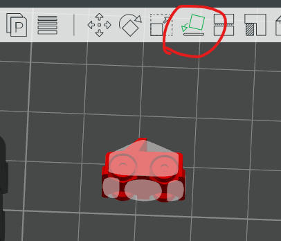

Just installed 1.5.0.61: Lay on face doesn't work
Auto Lay on Face seems to work, but when I click on the item, I don’t have any of the normal shadings that allow me to pick a face.
You might see it better when zooming in to the object

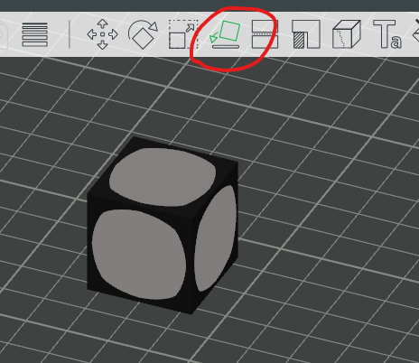

Works for me.

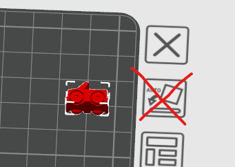

Make sure you are picking from the top menu, not the plate menu
Here’s a screen capture: face doesn't work - YouTube
I verified I am on the same version and it worked fine for me on everything I loaded.
Saw the video. Hmmm… Does it do that with all models, or just that one? Maybe try it with a cube primitive? If not working, bug it on Github.
