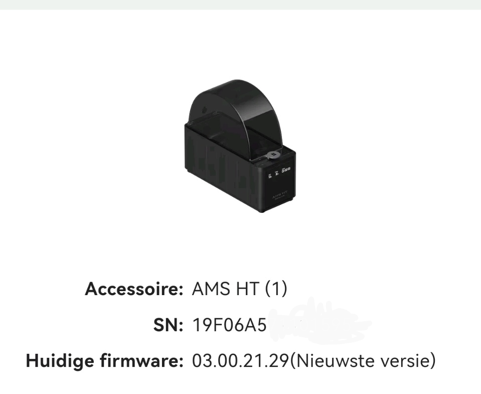

I received my HT today and connected it, it says there is a firmware update for it, but it looks like the “latest” is older than the one on it already.
Current Firmware: 02.04.18.86
Latest Firmware: 02.00.19.67
I am going to ignore it, just not sure why it wants me to “update” it.

I would update it, the current version is 03.xx something.
Even though the “latest” is showing as 2.00.xx.xx and the current installed version is 2.04.xx.xx?
Yes, sometime updates are a multistep process. It might be showing you the only update available from your current firmware level.
The current version is 3.00.21.29
Oh, how come it is not offering that version, or do I need to follow the bouncing ball and step up to it?

It’s a common thing in firmware when they don’t want some new version to need to include NVRAM parsers or bootloader configs for every possible past version. So you need to do it in steps.
