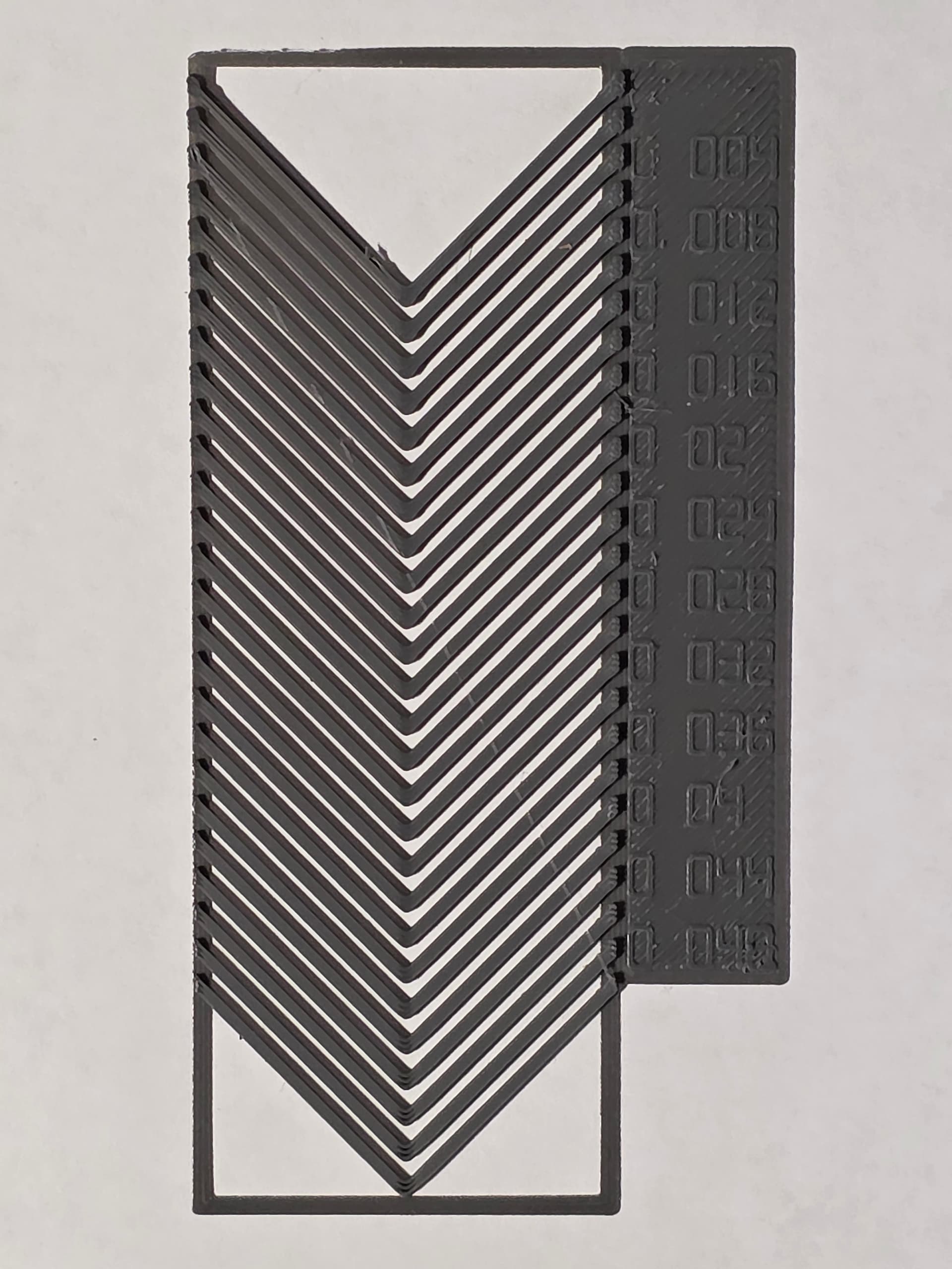

Yes, you can choose to do it or not, but I find it interesting that when you calibrate a material manually, you get a value close to 0.020, whereas with automatic calibration, it ends up closer to 0.040

No, that’s only applicable for Lidar. This time with the eddy current sensor it’s quite different. And actually you get a huge lot different result from it, e.g., manual K value result is 0.02 and automatic might be 0.033
I got the same result as OP, interesting. My manual pattern based eyeball result is 0.02s, while the automatic calibration constantly gives me 0.033s. This is a quite large variance. But the result is consistent in both left and right nozzles. I’m using HF 0.4 nozzle.

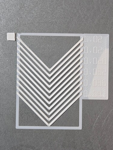

here is my result using bambu pla basic. 0.02-0.024 is pretty good to me (the angle looks quite straight). The automatic value of 0.033 would have under extrusion.

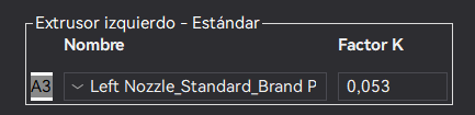

Smart Material Recycled - PLA (Gray Color)
Automatic - Value
Manual - Value

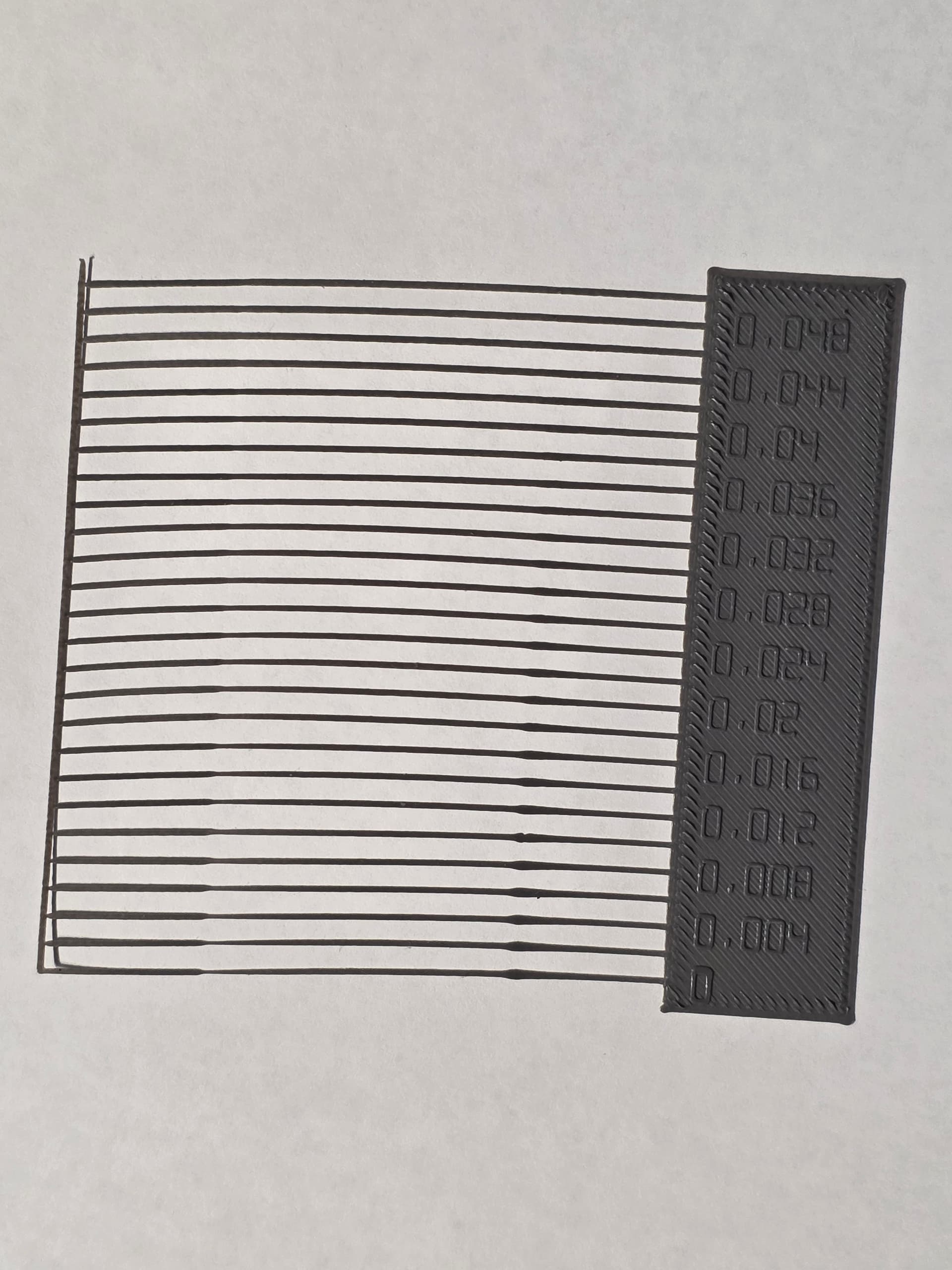

Pattern
Lineal
