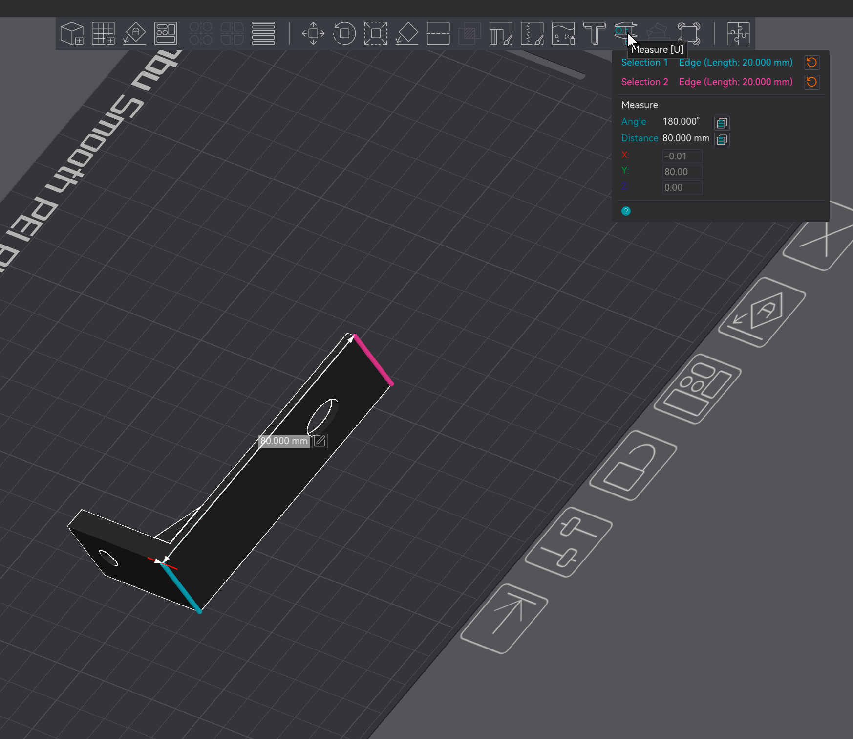

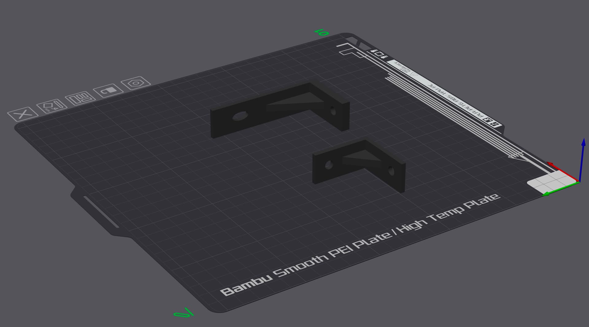

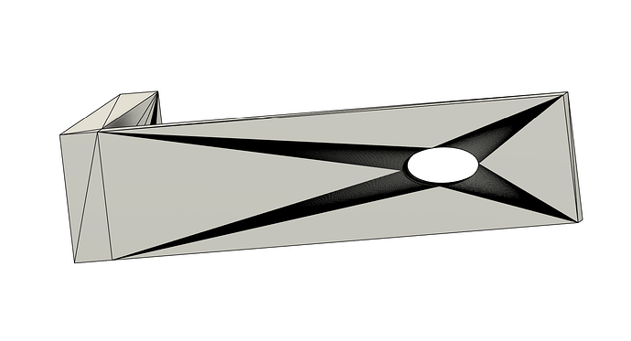

  1. I have been trying to simply lengthen one side of an existing small L-Bracket file that has predefined holes at each leg. When I lengthen one side, it changes the existing hole size into a stretched oval hole. Can you advise how I should be doing this to keep existing hole size?
  2. Also, is there a way in the above example to change the hole size (say if I wanted to have a larger or smaller hole than the predefined one in the file)?
Thank you very very much everyone, my first post and have been learning a bunch from the experts here.
Gary
Alpine Racing
Bambu Labs X1 Carbon

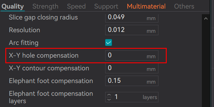

The TL;DR answer is: NO.

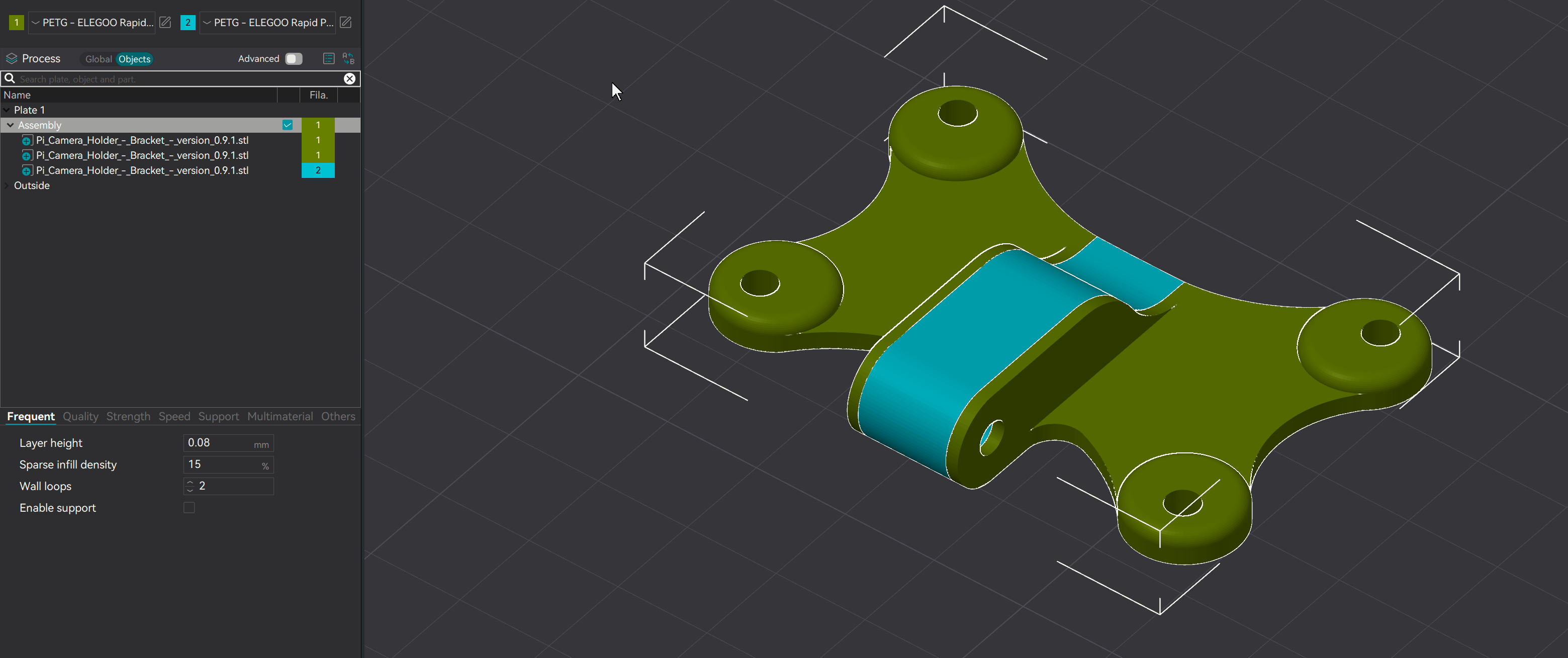

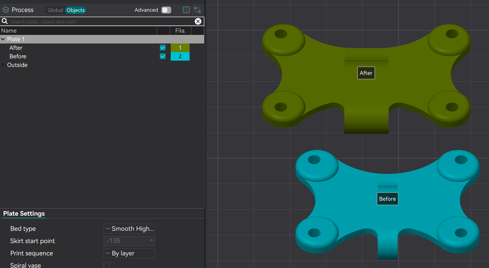

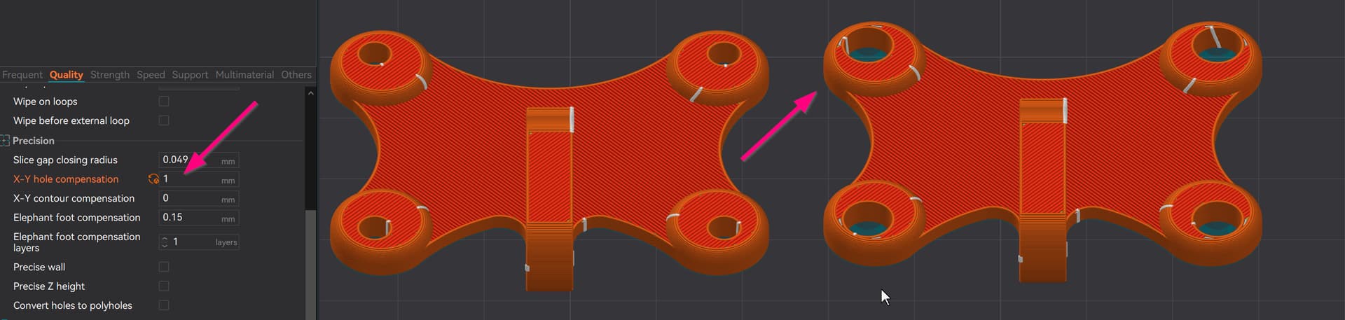

You could try to use the X-Y hole compensation to increase the hole size. That would only get you halfway.
In this example, the hole in one object was increased by 1mm
______________________________

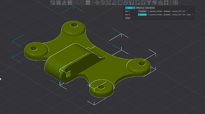

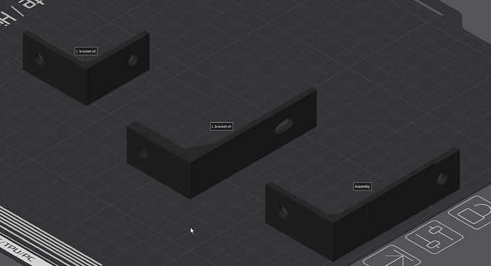

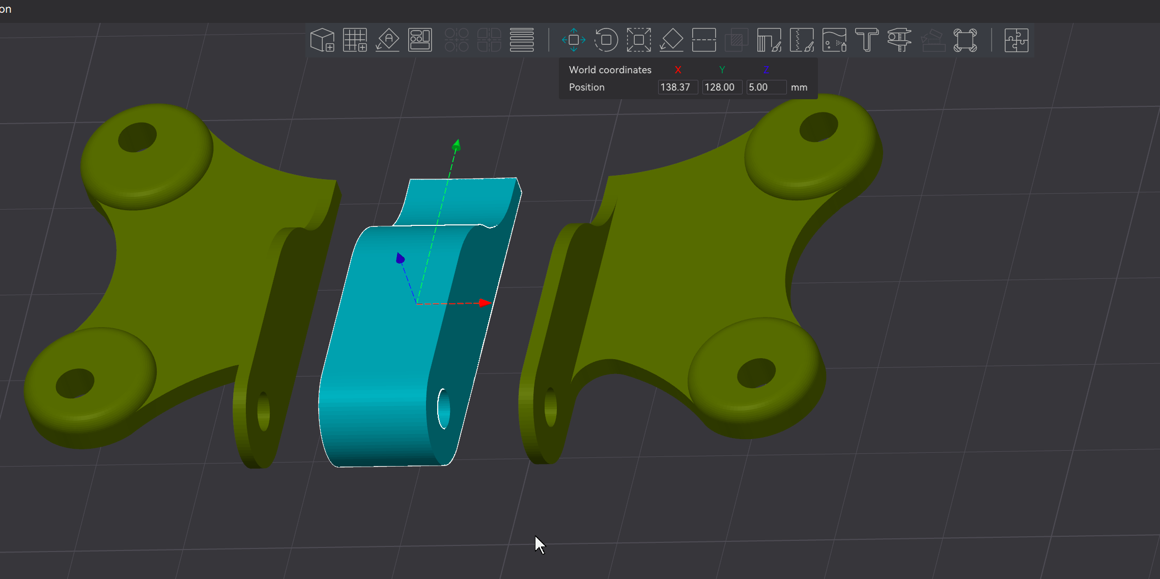

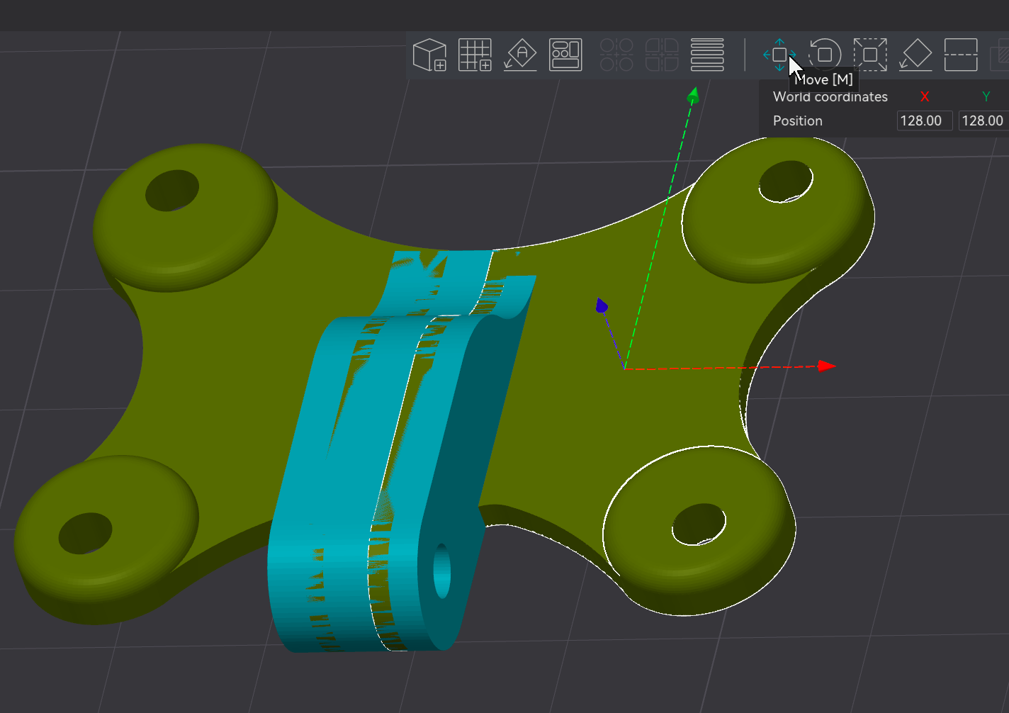

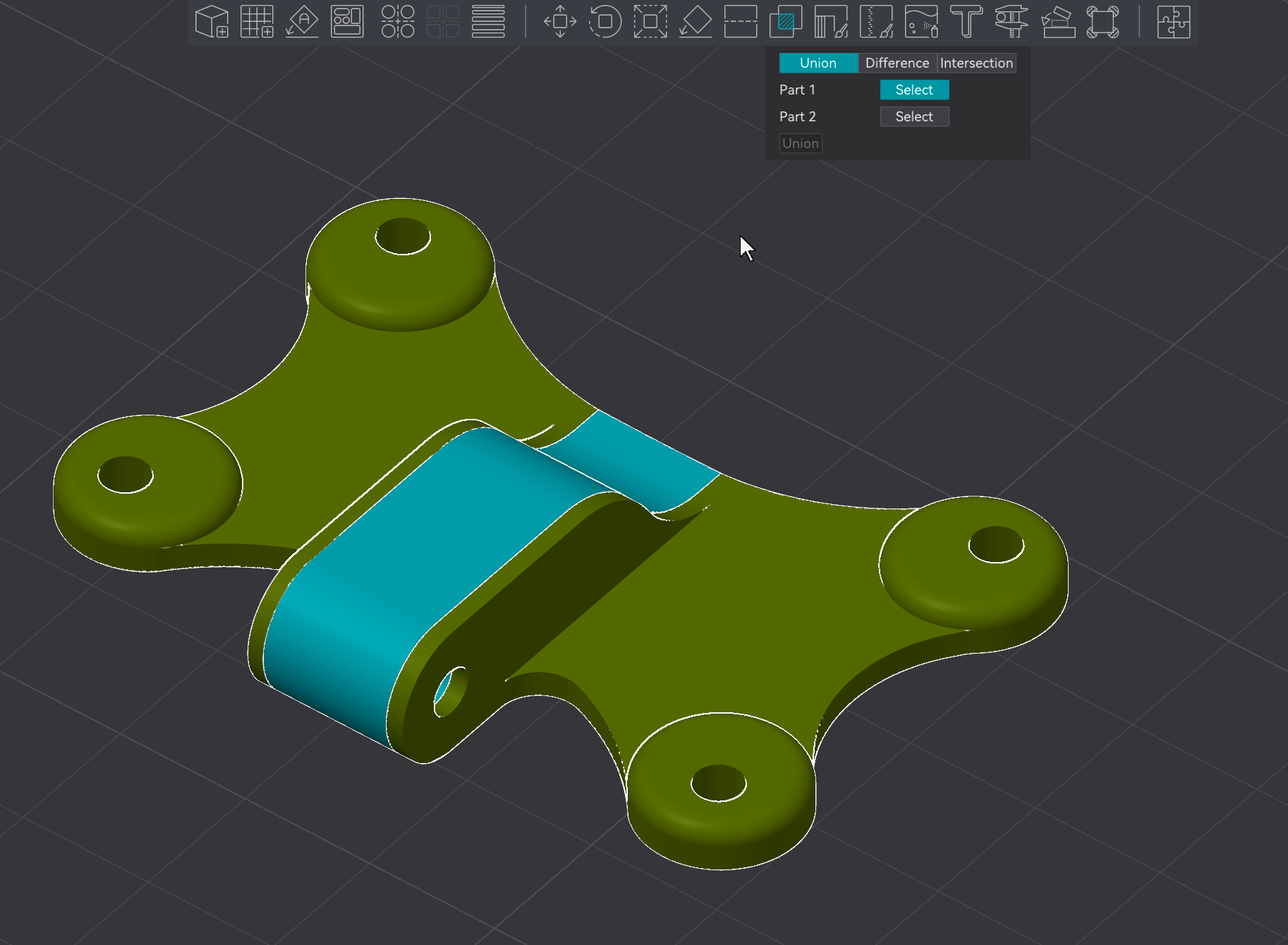

I can only guess what your attempting since you didn’t post an screen grab but it sounds like you’re trying to use the scale feature by scaling one axis. The correct tool is to use a Parametric CAD tool to modify the hole by mathematically changing only the hole diameter. Slicers are not that tool. When you scale you scale the hole model. The slicer doesn’t know the difference between the hole or the surrounding material.
There are many free CAD programs out there so money is not the issue. However, if you have a model that you wish to modify using the Slicer and all you want to do is change the dimension in one area, you could cut the model, then stretch a piece of it then reattach the center piece and then merge the pieces into one model again.
Here’s an example. Please note that this is a very time consuming process that would otherwise be done in seconds in CAD. There are probably other ways to do this but this is the way I used to do it, wasting hours, before I started using CAD.

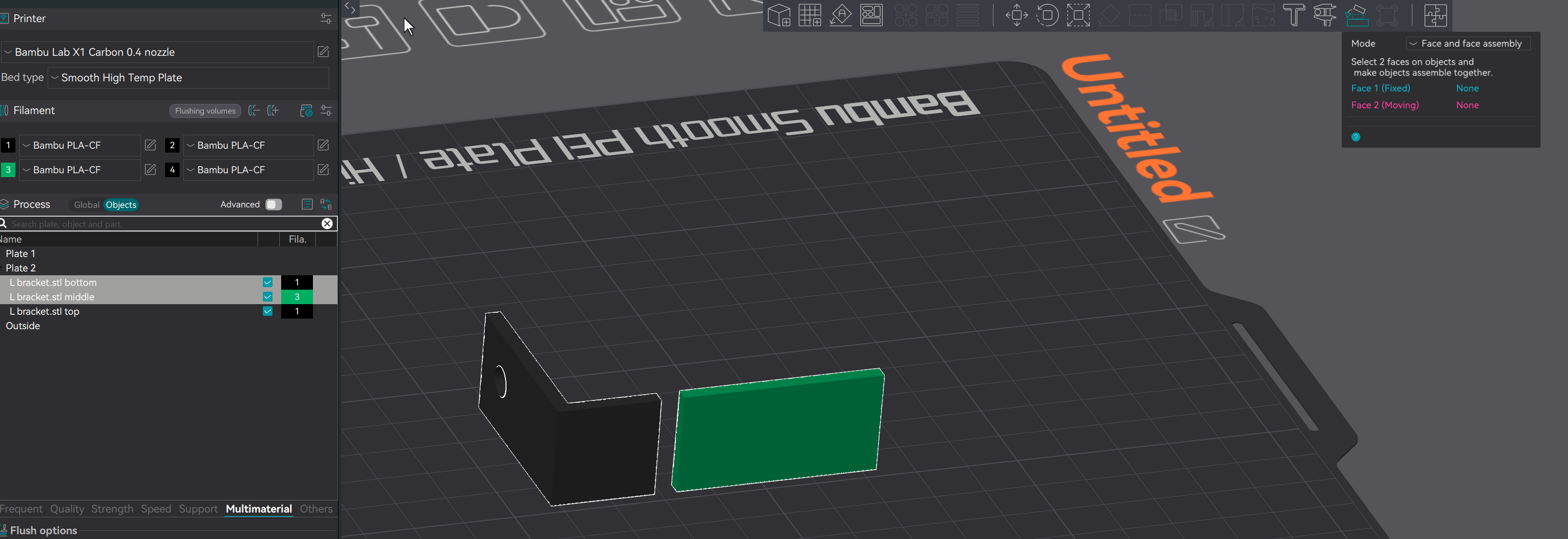

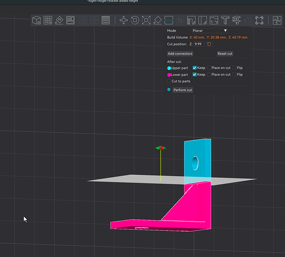

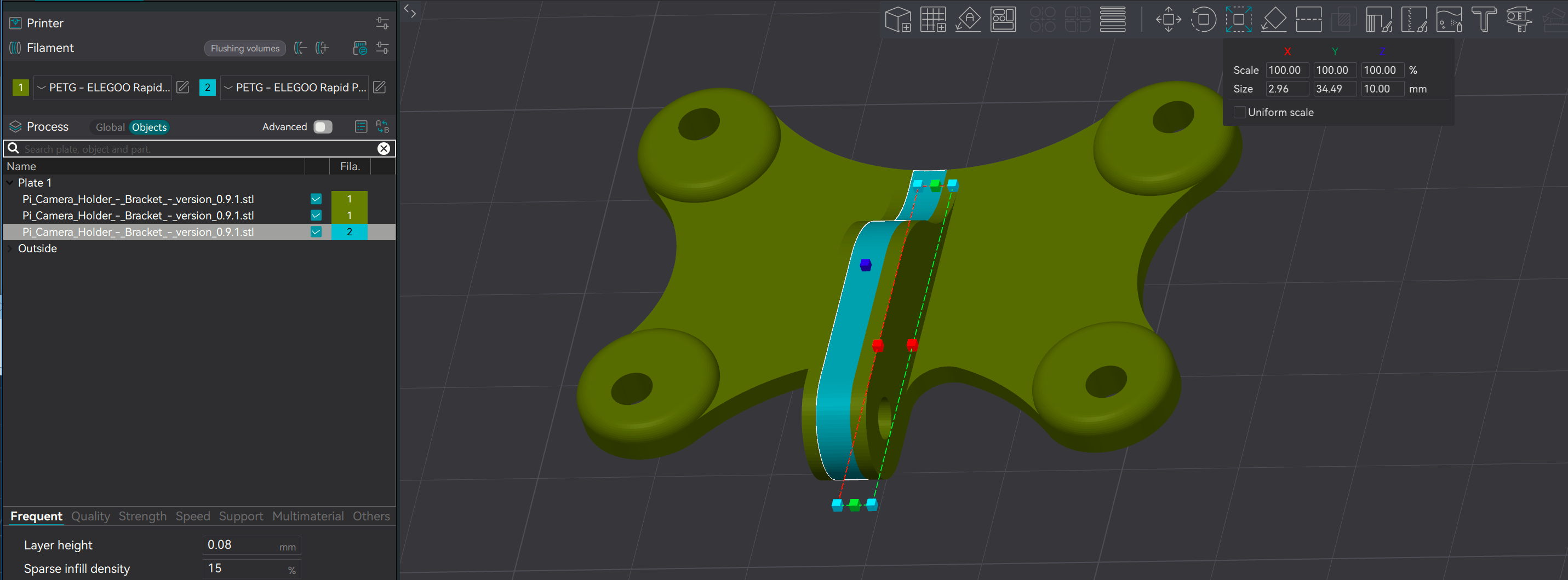

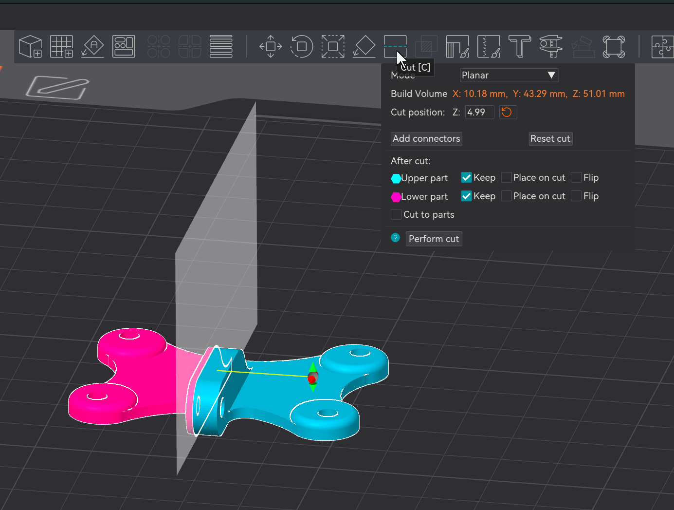

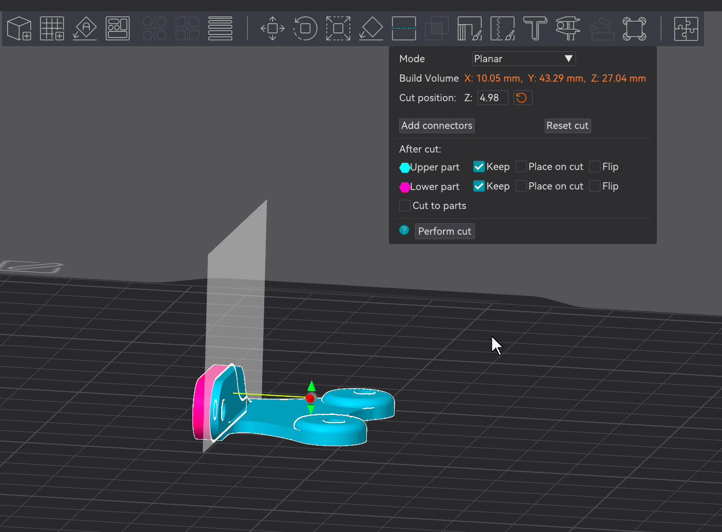

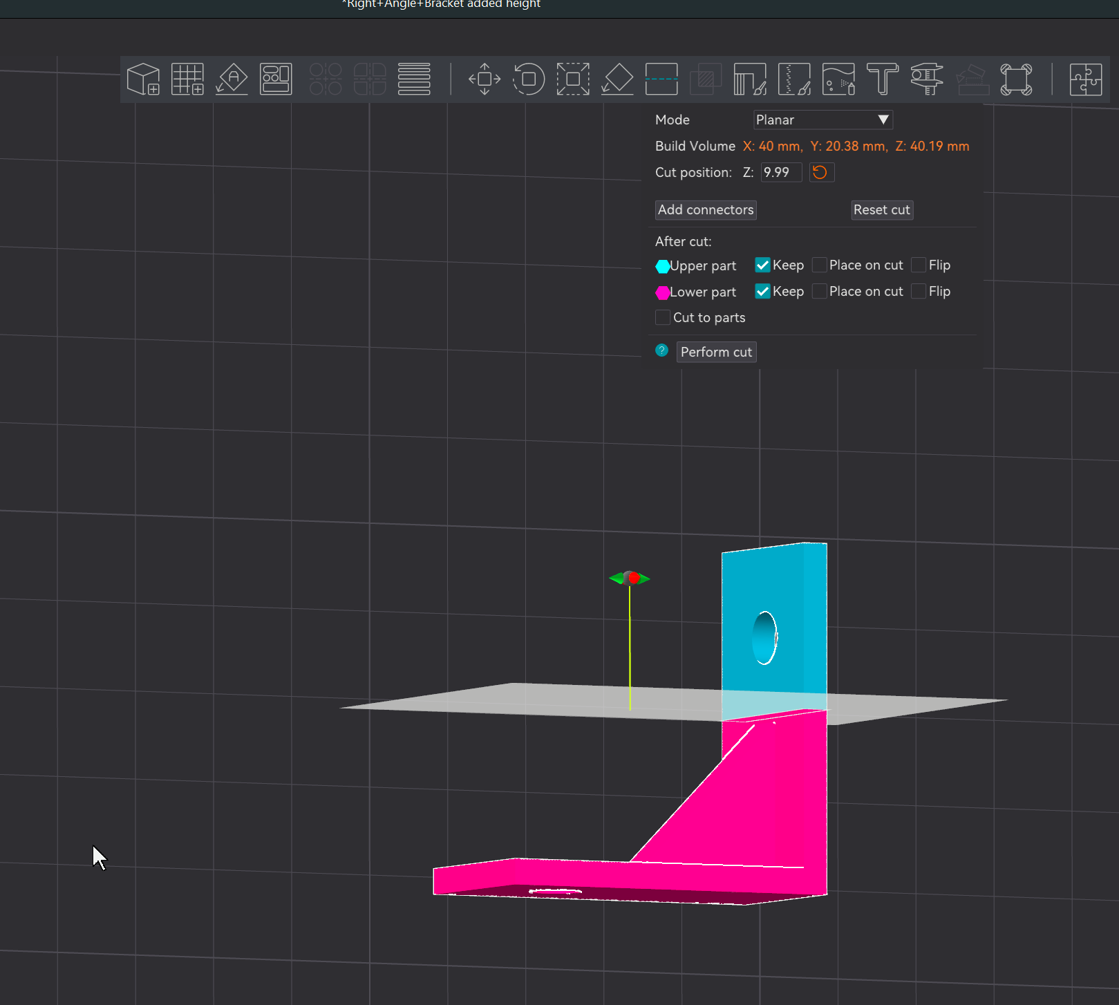

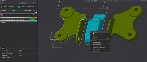

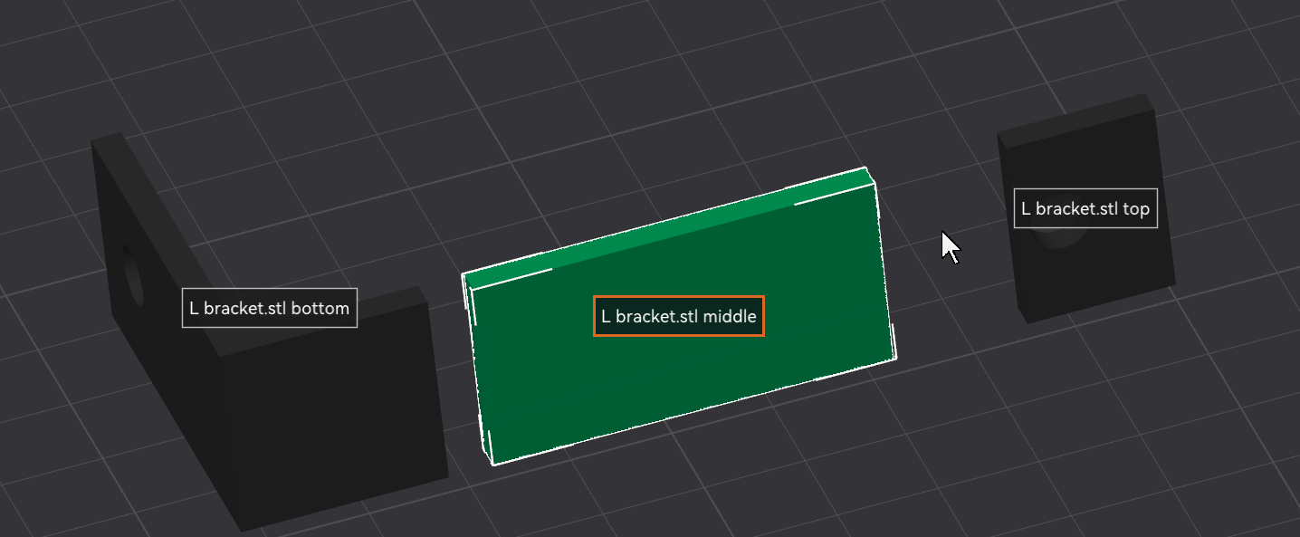

Step 1 - Cut the object twice along a solid boundary that can be lengthened without changing the geometry of the entire bracket.
Second cut

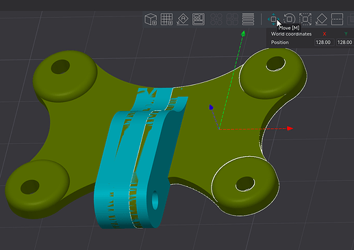

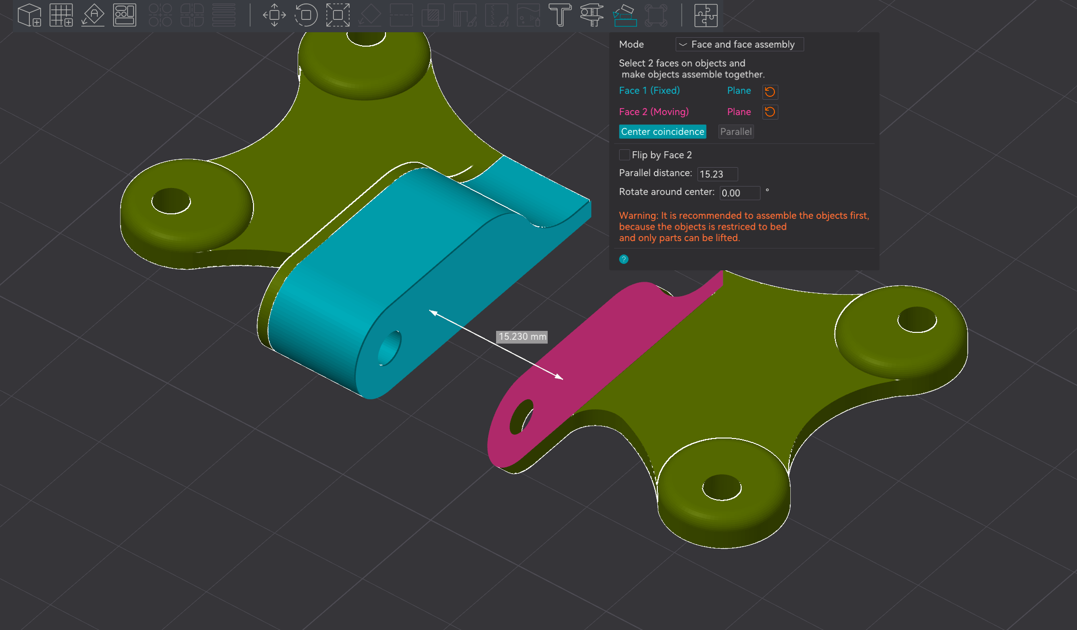

Step 2 - Orient the pieces using the move command

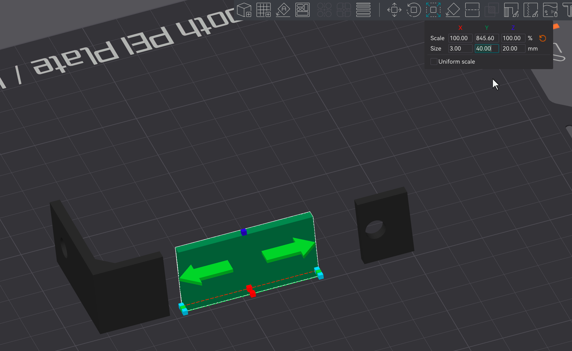

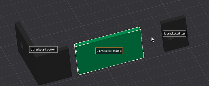

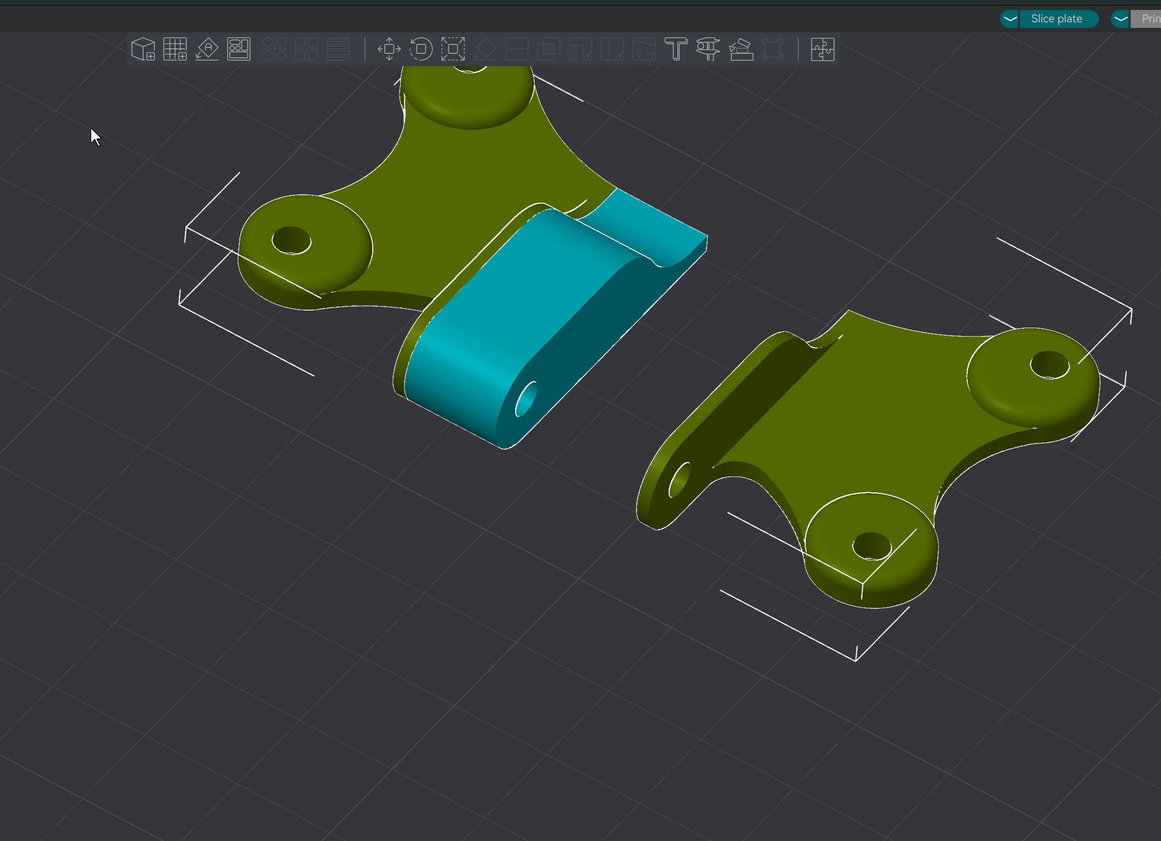

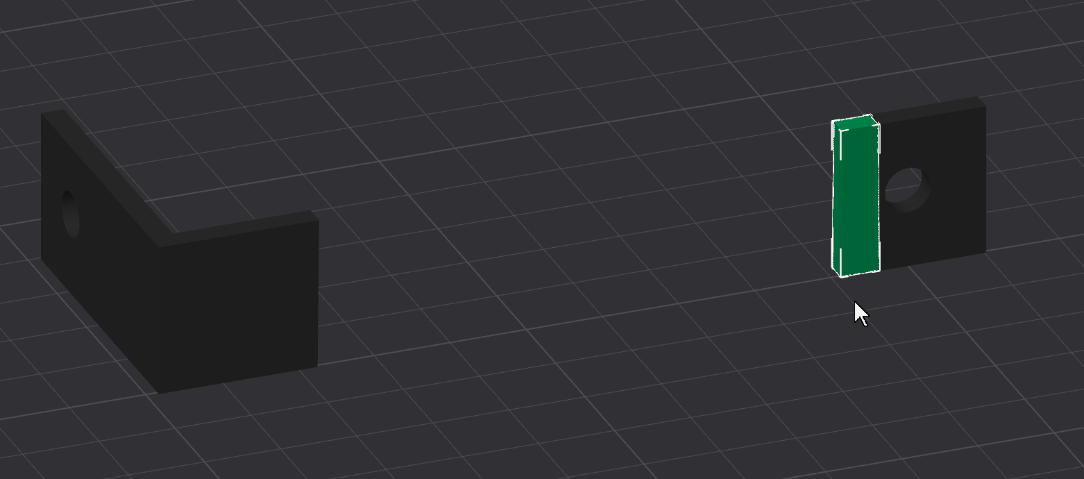

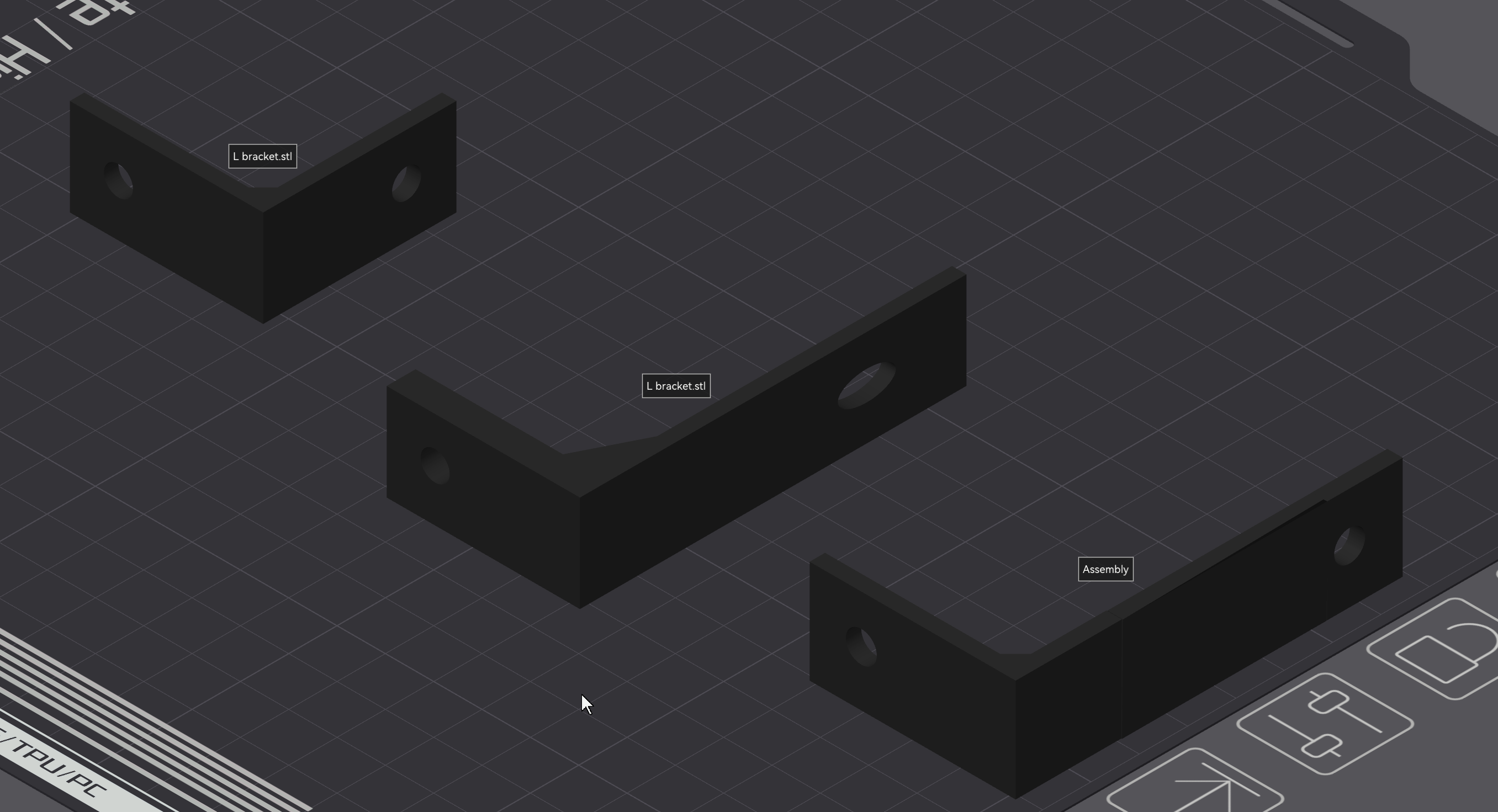

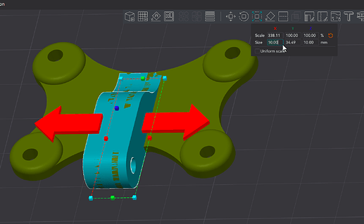

Now that you have the object into 3 pieces we can arrange them on the build plate and use the center section to lengthen it.

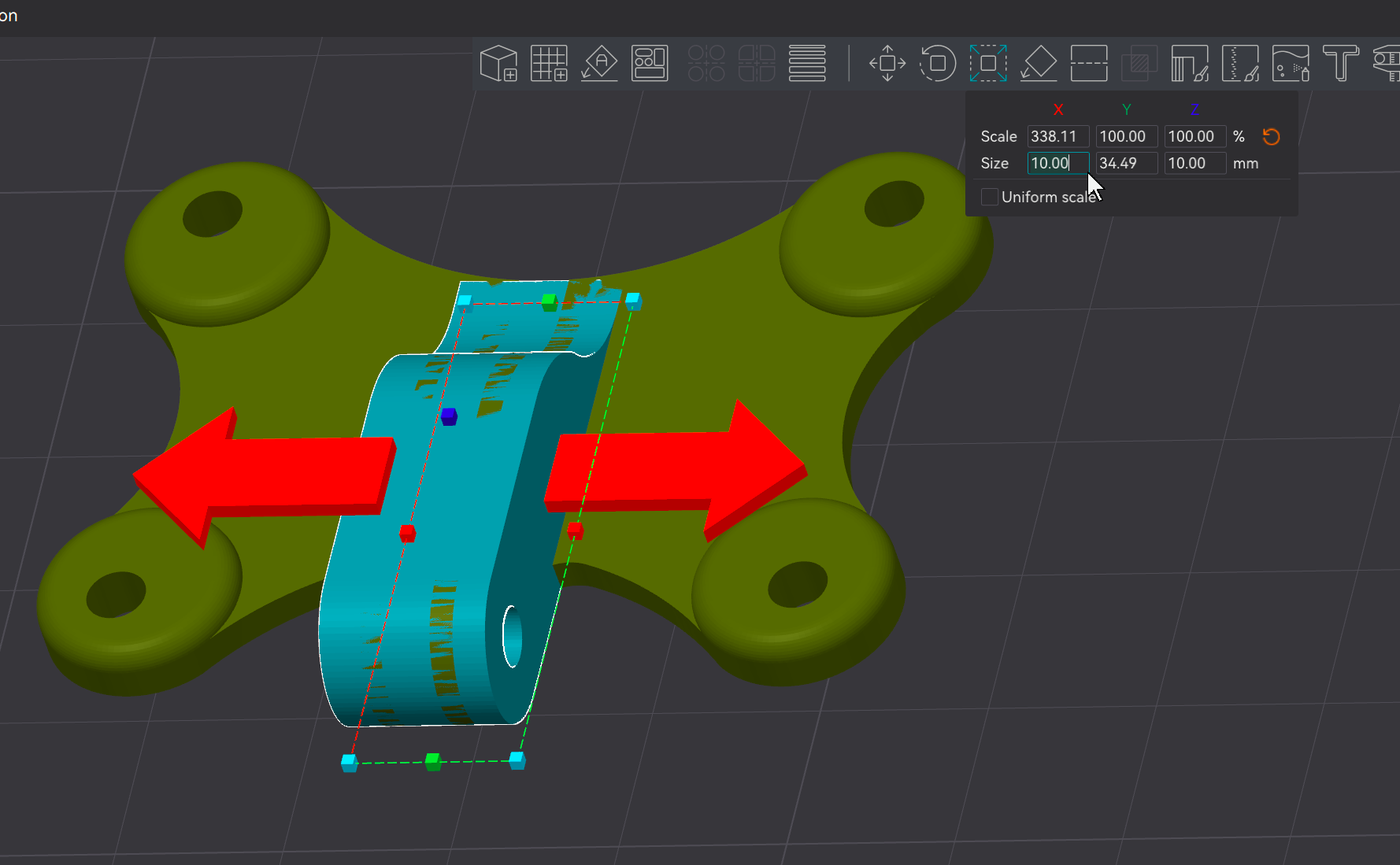

Note: I’ve added a false color for visual distinction, this is only to make the example easier to see.

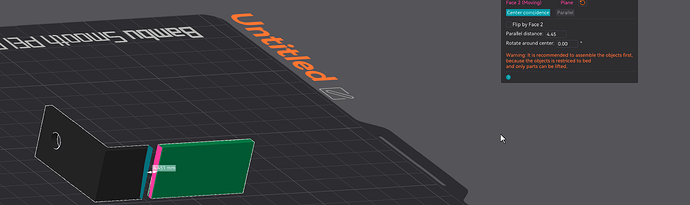

Lengthen the middle using the scale command
Separate the pieces so that there is a gap. It is easier if you simply extend them along either the X or Y axis to maintain alignment

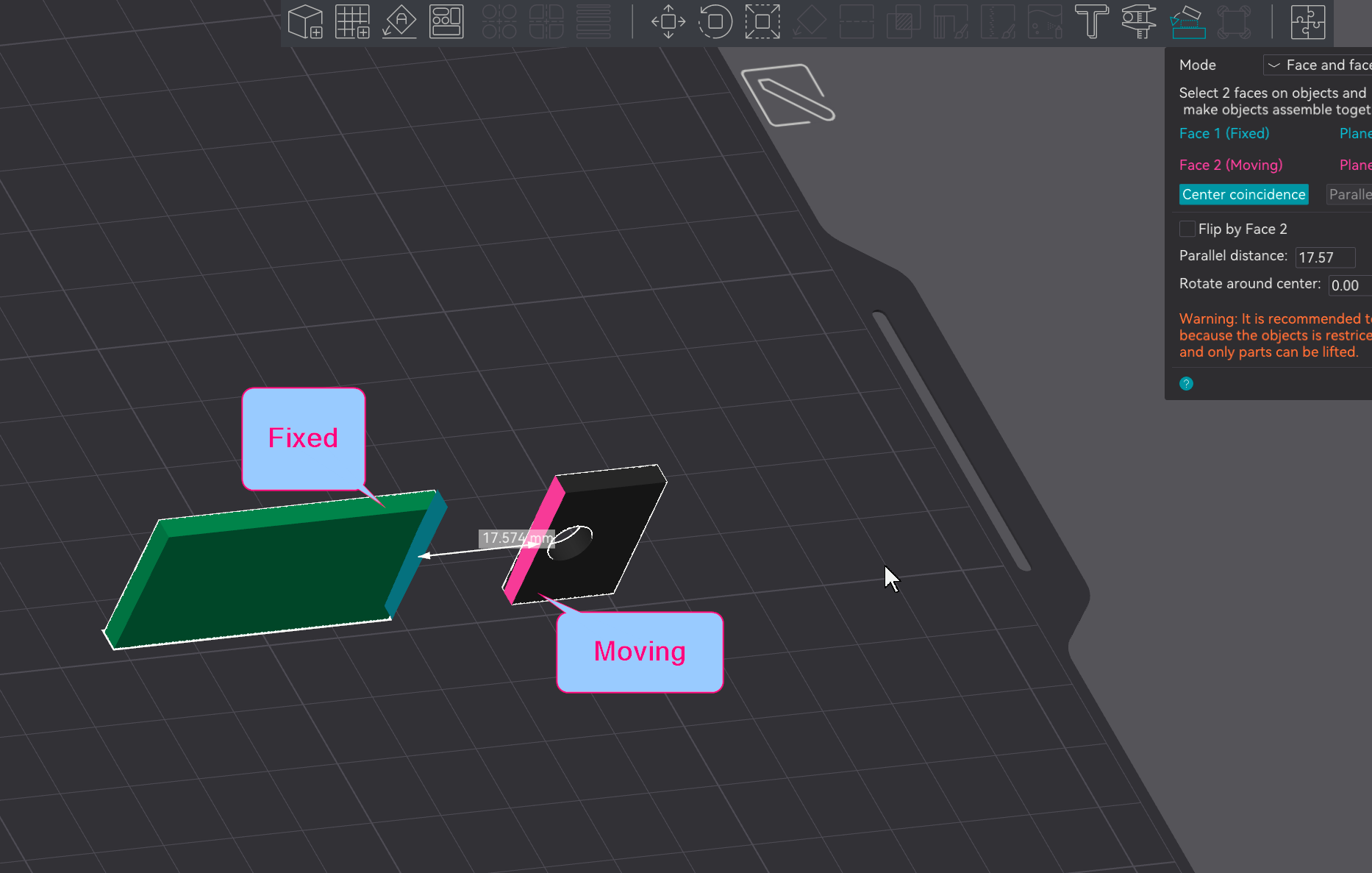

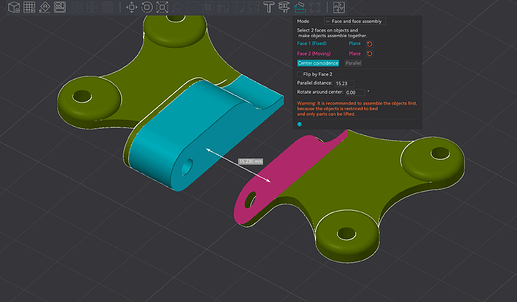

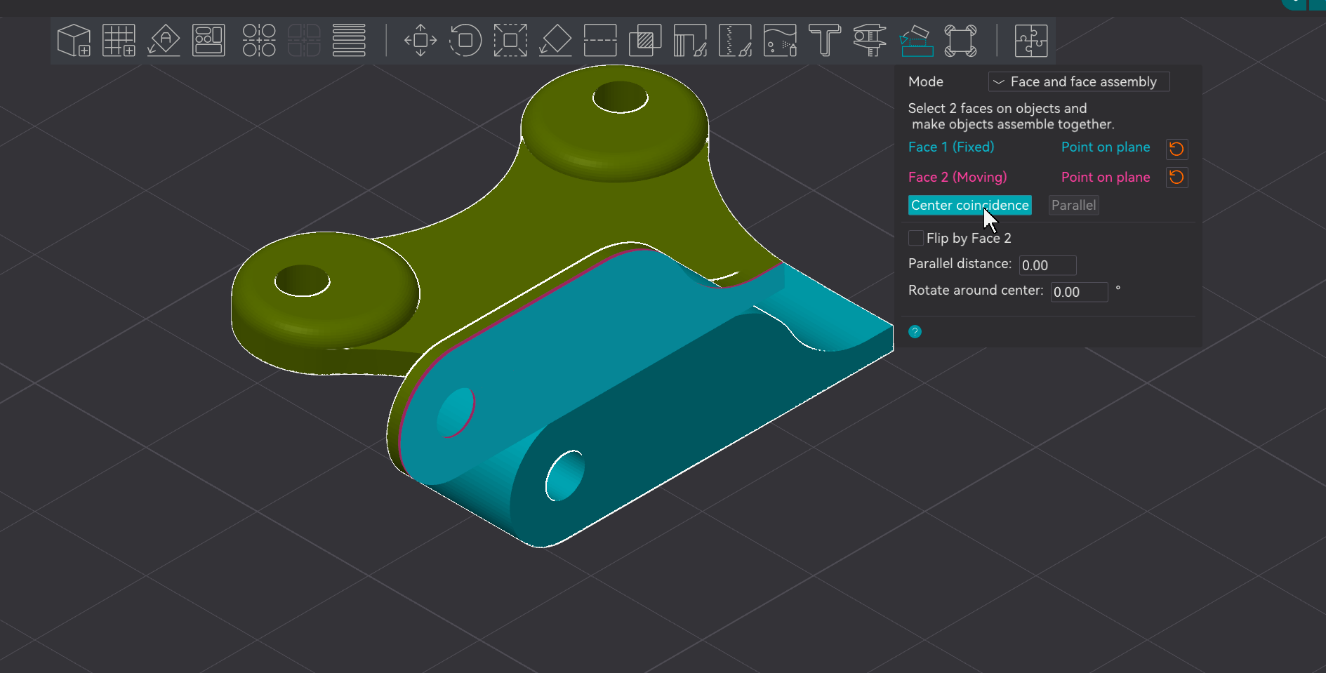

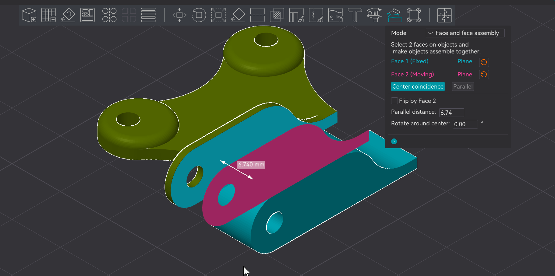

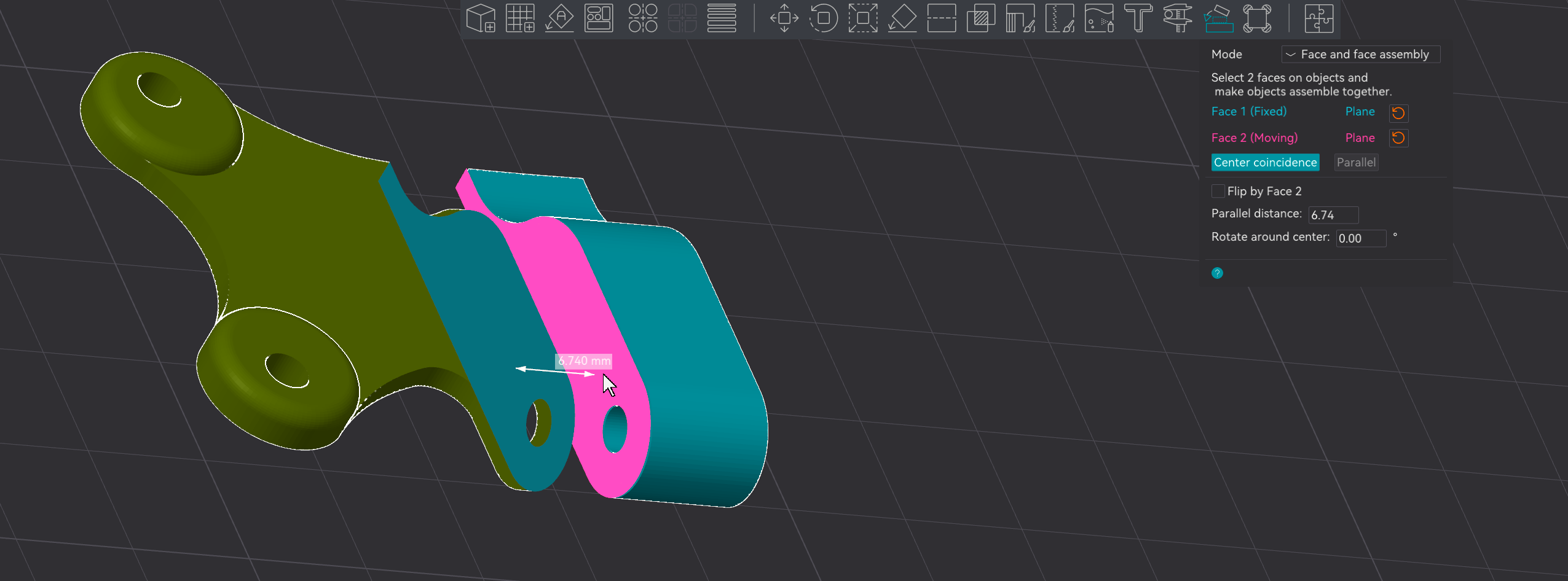

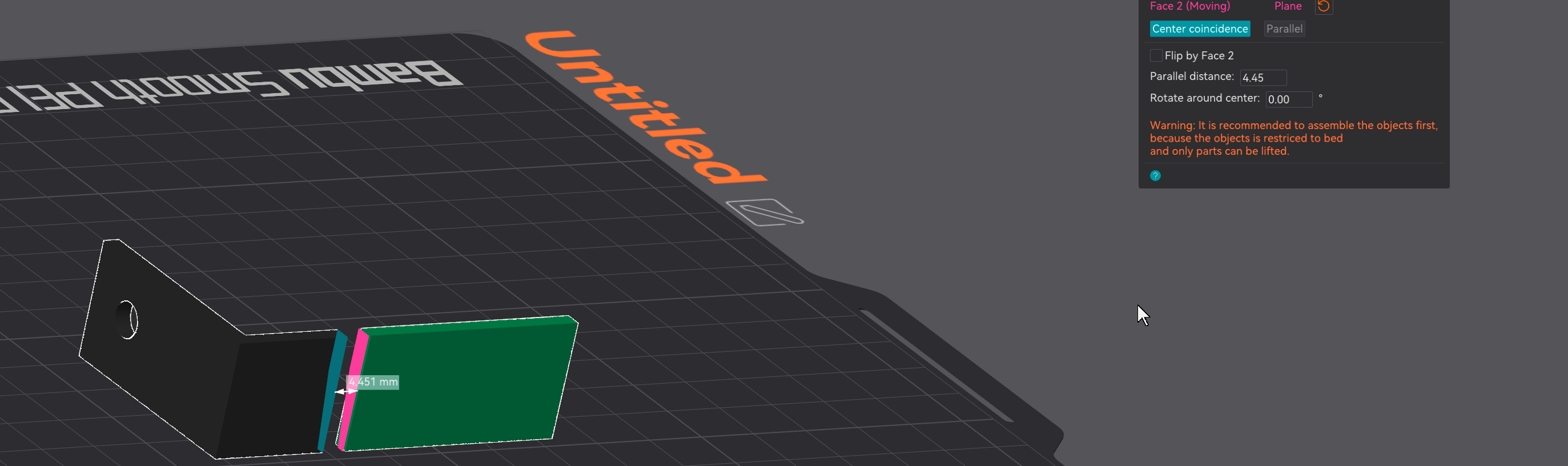

Step 3

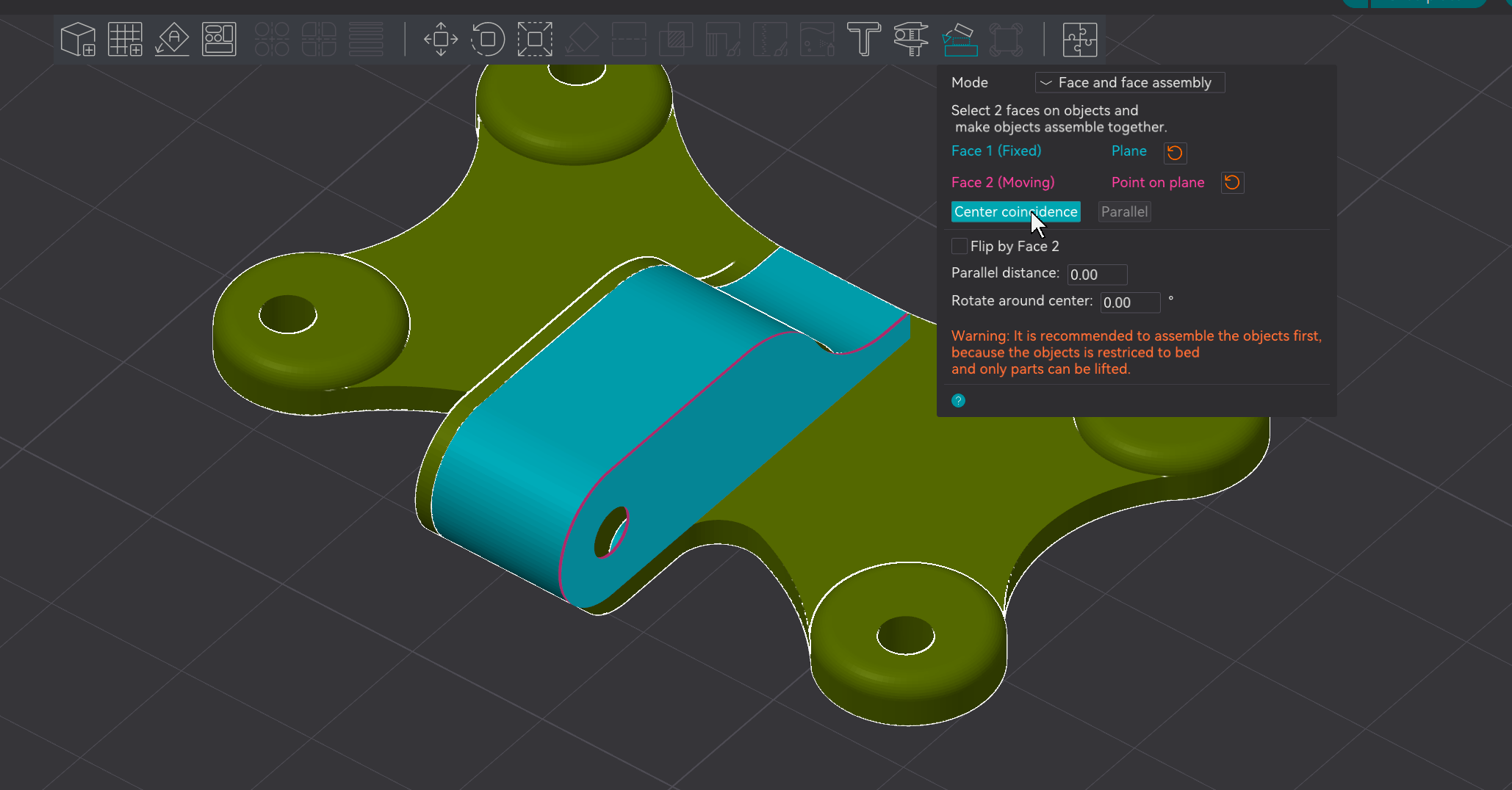

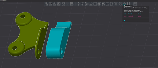

Assemble the left hand side with the middle and fasten the faces using the face assembly tool.
The assembly tool will mate two faces to each other. If you have only moved the pieces in one axis, it’s easier to join them.
Repeat this for the other side.

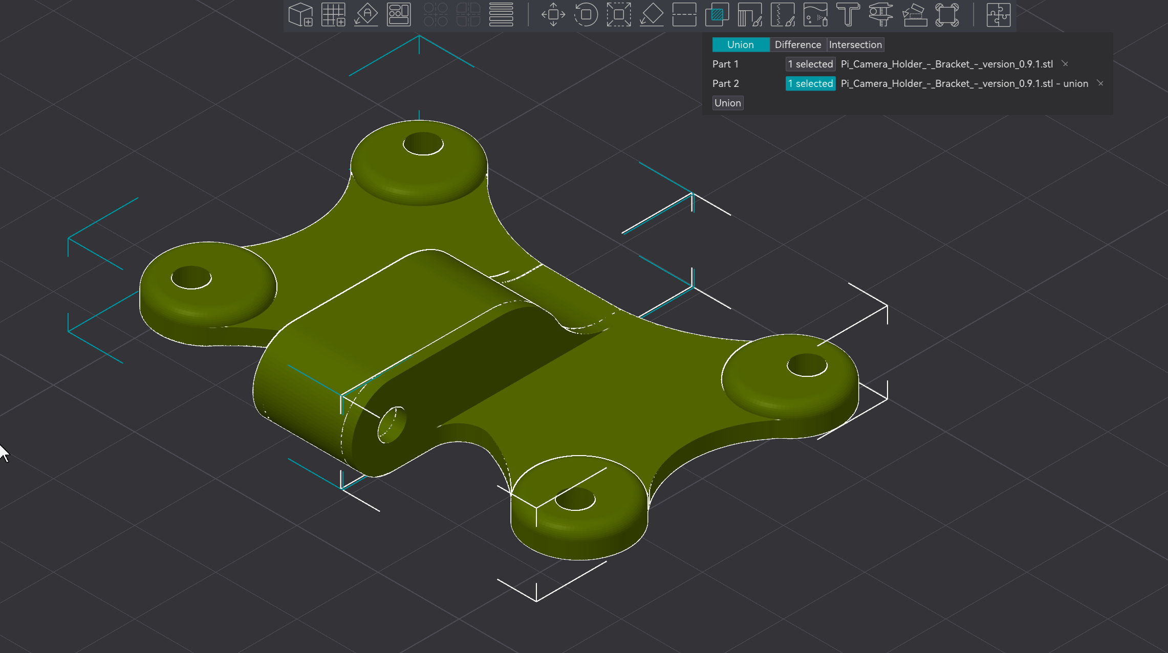

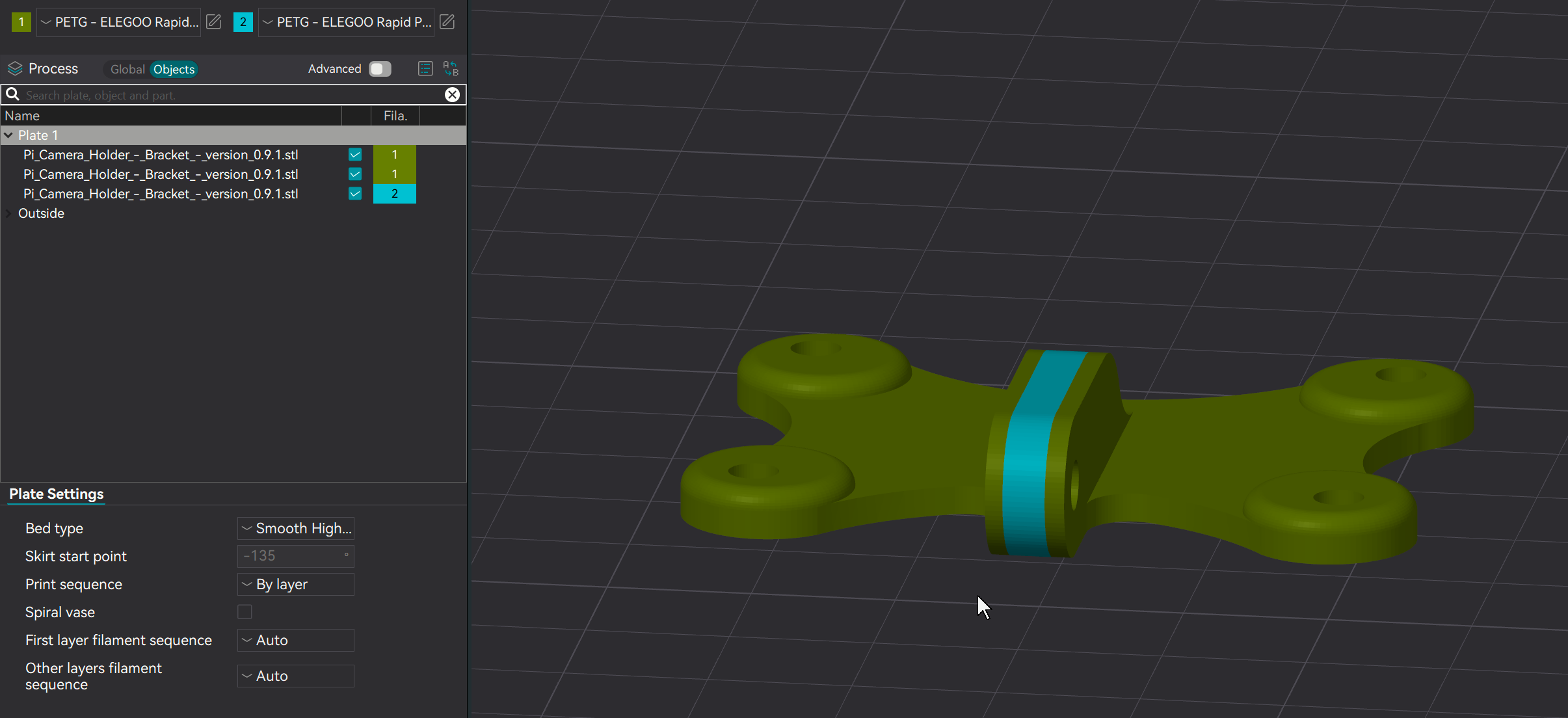

Step 4 - Boolean merge these objects to make one model.
You’re not done yet.
Before and After

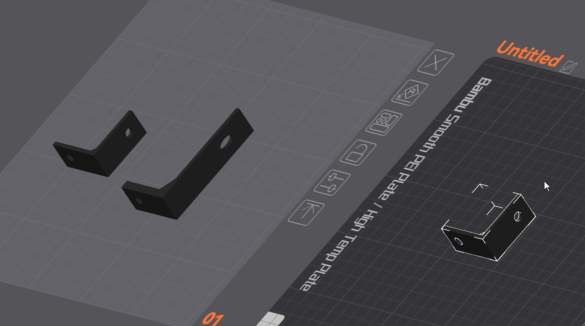

Huge thank you for the very detailed reply and instructions @Olias , very much appreciated… wow, that is a ton of work as you say using the slicer. Any time I spend on this should be getting more proficient at CAD based software.

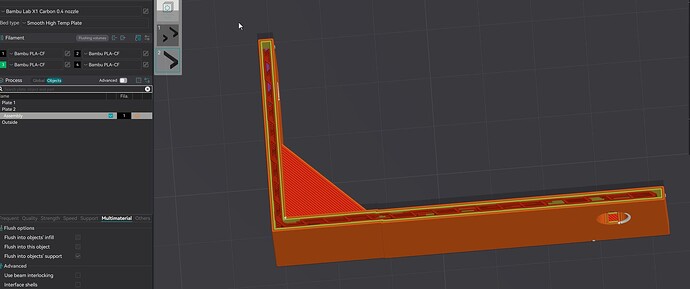

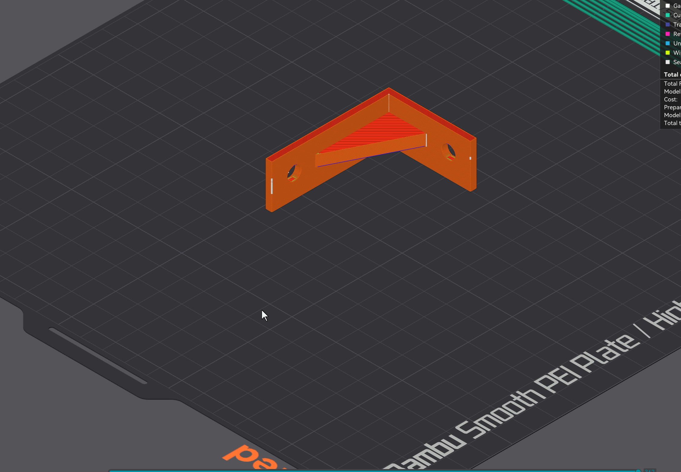

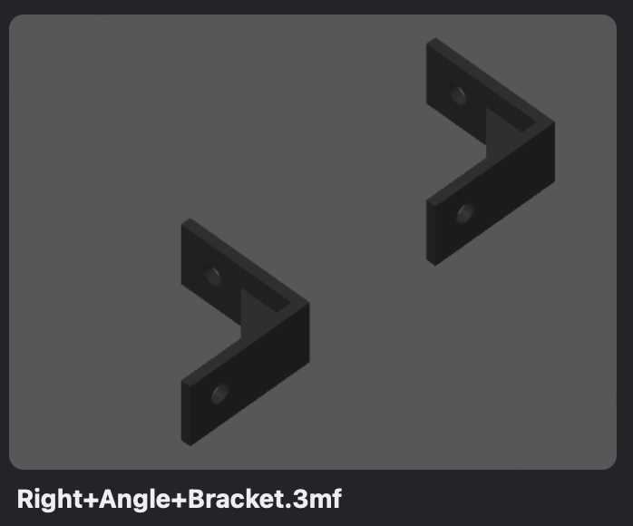

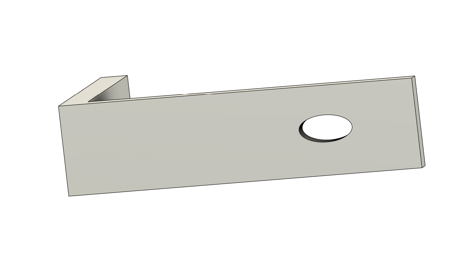

PS: This was the file I was trying to change and of course the oval hole result:
Right+Angle+Bracket added height.3mf (383.3 KB)

To show you how it can be done, here is the file. Admittedly, this has some rough edges but this is what I can do in 10 minutes. In CAD it would be seconds.
Right+Angle+Bracket added height modified.3mf (455.5 KB)

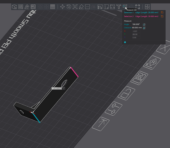

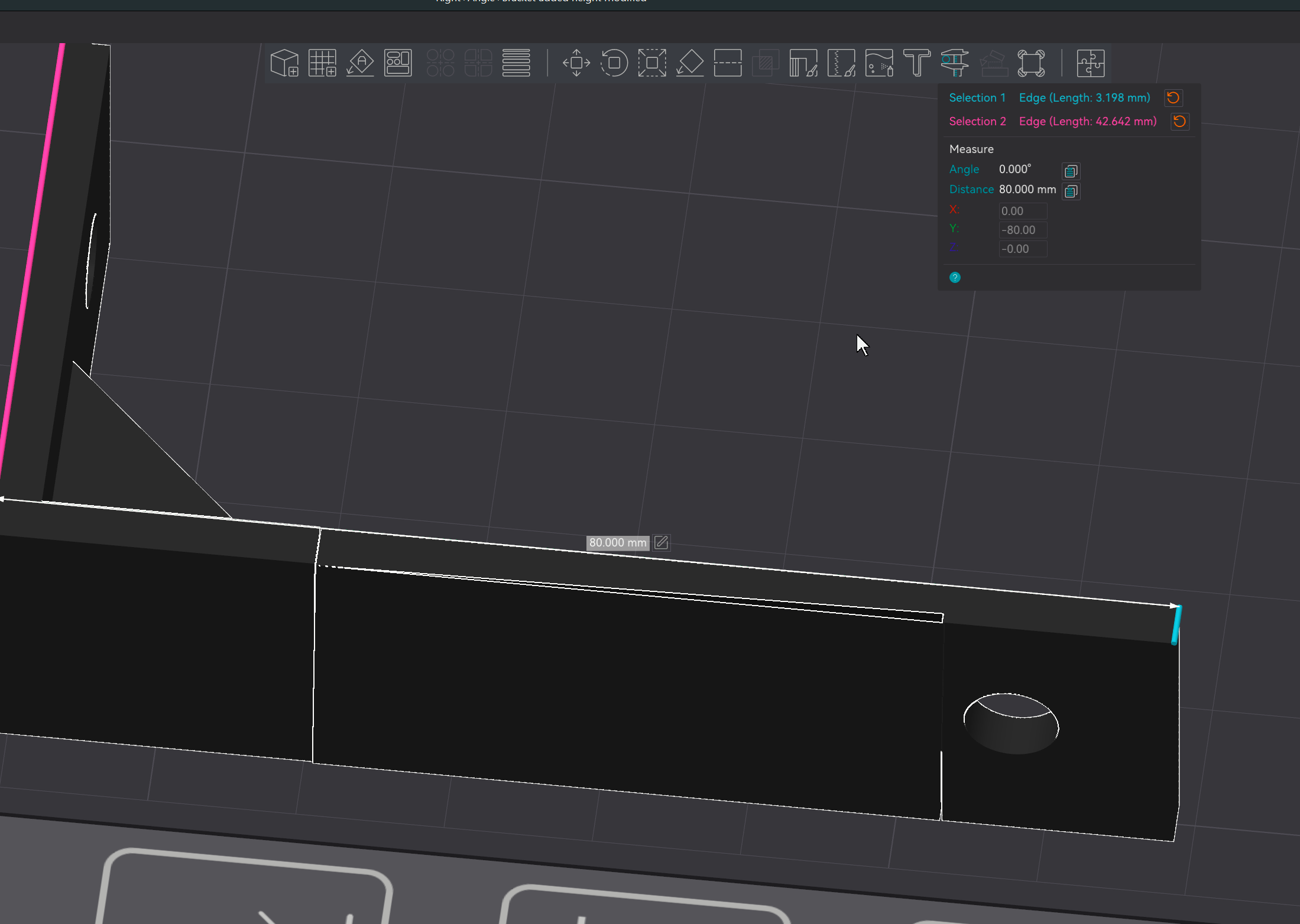

Since your dimensions were conveniently 40mm and you wanted to grow it to 80 mm. These are the steps to do it. Just cut out a middle section and lengthen it to desired dimension then glue the pieces back together. The bug drawback in this approach which CAD would remedy is that your angle brace didn’t scale in this example. I supposed one could just stretch it and it would scale accordingly like this:
Right+Angle+Bracket added height modified long angle.3mf (483.0 KB)
steps to recreate. “This is a rushed example”
In this last image, you can see that the holes are intact.

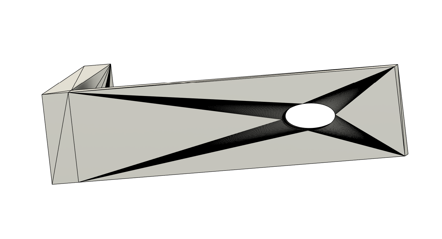

So my question is whether you know of any CAD suites that actually actually make a hole resize as quick as you suggest, when given the STL files that dominate MakerWorld? I’m not aware of any that can convert meshes without making a zillion-triangle mess. Even when provided a generic STEP file, it’s still somewhat of a process IME, since you don’t have the original sketches to update. I would love if you’ve found a program that can do either of these with any efficiency, though. (That said, AI-enabled mesh-to-solid converters are surely right around the corner!)

If you only want to make a hole parametric, a “zillion-triangle mess” shouldn’t be a hindrance, make a new sketch on a parralel plane (best planar with a triangle) and fill the hole (by drawing a shape bigger than the hole and extruding it). Then simply reuse the sketch to create a new parametric hole that you cut out with a new extrusion.
In fusion you also can click on a triangle to remove it and it will usually completely clean the whole surface around as well. It can even clean the whole model if you are lucky.
Splitting the model with a plane cut can also sometimes have the same effect.
And all of this is done in the free version (outside of the free trial).
Otherwise the paid version can generate a pretty clean model from the stl to begin with but the fusion licence is a bit expensive (you can always use a new free-trial when you really need it).
Here is the file with the whole process, from the oval hole to the parametric one (passing through the cleanup) that took me about a minute.
