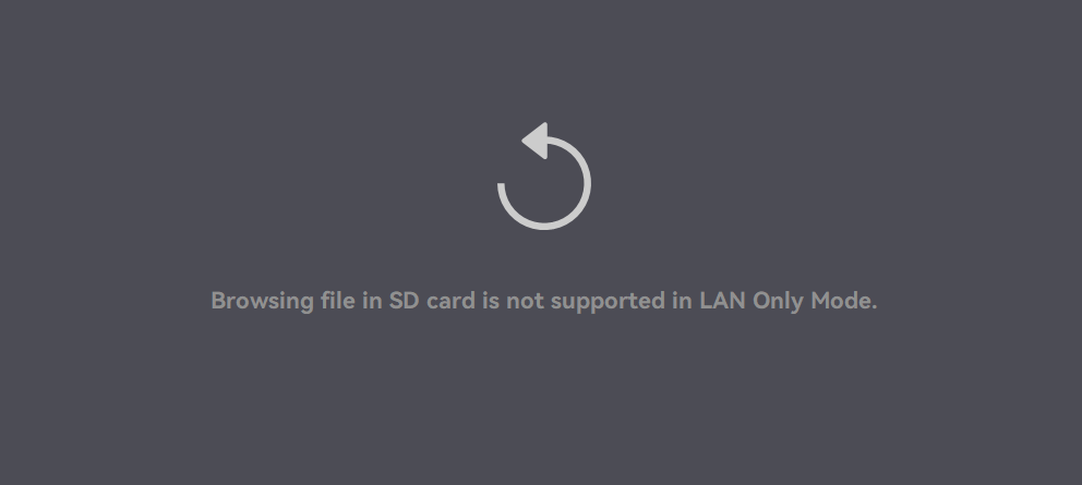

Why is this a thing? I can browse my files in LAN mode if I connect via SFTP so this seems like a purposeful limitation to force me into using the cloud service. Today was a prime example of why I never want to connect up to the cloud and rely on Bambu.
Bambu can you please enable this feature. Having to open WinSCP just to look at something that should be an option in Bambu Studio is kind of annoying.
For anyone that uses LAN mode that does want to see their files:
Download WinSCP
Connect via SFTP using port 990 and the username bblp
Password is your LAN only access code on the printer.
Encryption should be already set to TLS /SSL Implicit encryption by default, if not set it.
