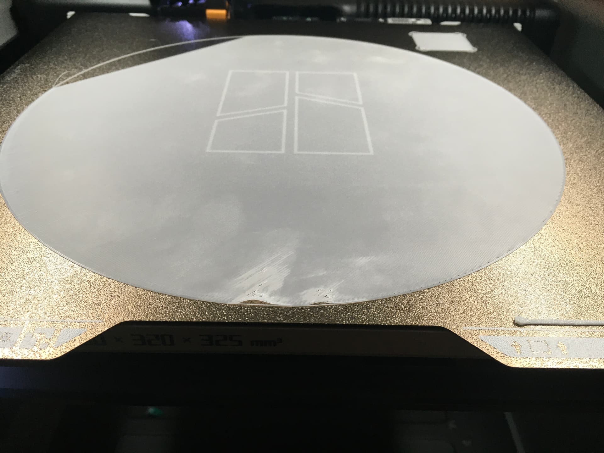

Printing PLA on the PEI print bed. I am seeing bad printing on the first layer of the front edge of a large print. It happened once and I thought it might be a glitch so I stopped it and started over. Exact same issue. Ideas?
Clean the build plate.
It is most likely some contamination, finger prints given the location or previous prints.
Actually I forgot to say that I washed the build plate with soap and water before printing the second time. Perhaps I didn’t do a good enough job… so I will try again.

Yup, that was it. I followed the cleaning described in the guide and the problem went away. Thanks for your help!
