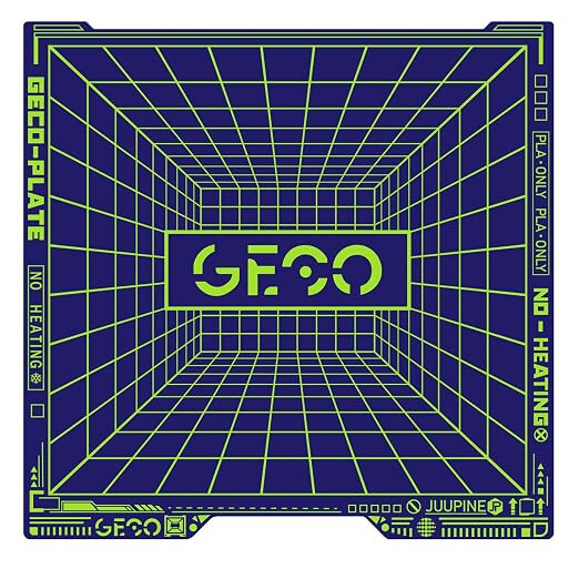

Get a GECO plate, has grid lines as part of the design.
