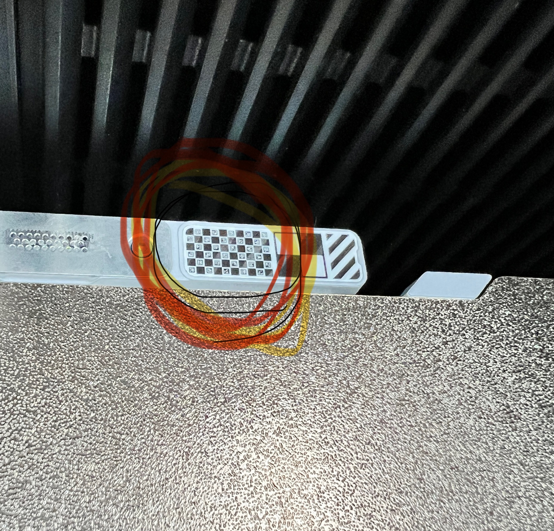

Today I received my h2d and tried to initiate the laser. Every time I tried to calibrate laser with micro LiDAR it fails. Cleaning sticker and so on don’t helped.
Then I saw that the sticker for calibrating the micro LiDAR was sticked on the head and because that the laser don’t recognise the sticker.
I put the sticker off and turned it for 180 degree and voila laser calibration with micro LiDAR works and I’ve started lasering different stuff. Hope I can help anyone who get the same problem. I don’t find other topics with the same problem…

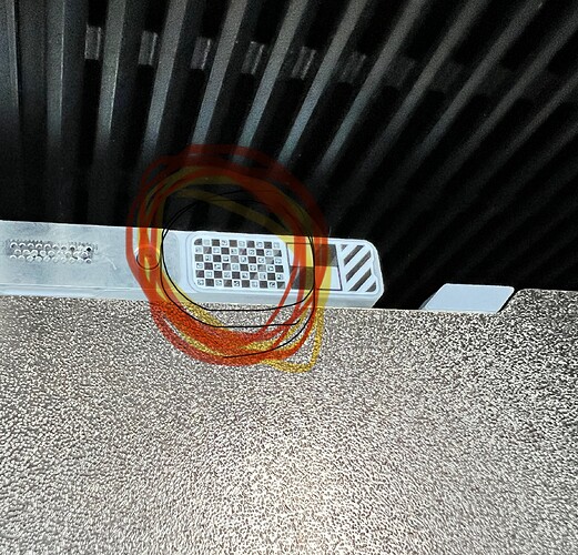

can you provide a mor detailed explanation of what you mean by sticked to the head and turned 180 our laser is not marking anywhere near the pictures on bbu suite
Hello,
The sticker here is right, after I rotate it 180 degree.
