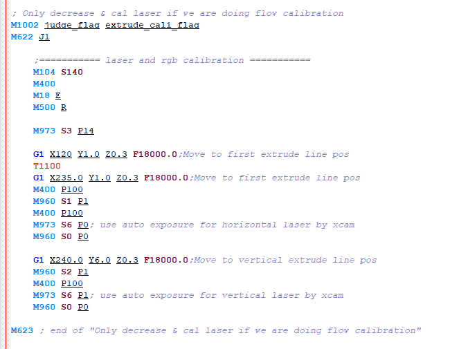

I’ve been playing around with the start g-code to try and optimize the prime line(s). I made a few comments on one of the GitHub issues regarding this.
My main issue is the fact that after printing the “nozzle load line” at the front, the printer issues an M104 S140 command to reduce the temperature, even if you aren’t doing flow calibration. Since the “handeye calibration” section is skipped, it pretty quickly runs M109 to reset the temperature. But there’s a small pause where plastic oozes out and almost invariably ends up stuck to the nozzle when it starts printing again.
The solution there is easy, wrap the M104 S140 in the if-check for calibration:
; Only decrease the temperature if we are doing flow calibration
M1002 judge_flag extrude_cali_flag
M622 J1
    M104 S140
M623 ; end of "Only decrease"
However, there’s a section later that does “laser and rgb calibration” and that seems to happen regardless of whether you choose flow calibration (extrude_cali_flag = true).

This section executes very quickly so the temperature is usually only reduced by 20 degrees or so by the time it’s done. I can’t imagine it relies on the lower temperature to be effective. If so, you’d think they would’ve used M109 to wait for a specific temp.
For people that just completely remove the nozzle load line at the front, I’m assuming this section has nothing to scan? Does that cause any problems?
Just sort of thinking out loud and trying to work through a more optimal startup.
I too am doing the exact same thing and would love to know. What if we just disable the laser and rgb altogether? Is it vital for printing or just for flow cali which I never use
I came searching for this exact thing. Have you guys tested more?
I wrapped the whole laser/RGB cal in the conditional bracket as well. Seemed to work just fine on my first non-calibration print:
I tested the same thing and everything seems to work fine as well. The only unknown gcode purpose gcode here are M18 E and M500 R, but they most likely do nothing and are just leftover from earlier in development.
M500 R is confirmed to do nothing Skew compensation in the Bambu X1C Firmware - #79 by EdStreet
M18 E would disable the extruder motor in marlin, but here the extruder motor power doesn’t seem to be controllable through gcode.
Besides PA calibration, the LIDAR is also used for first layer scan, but that doesn’t seem to require the calibration here.
