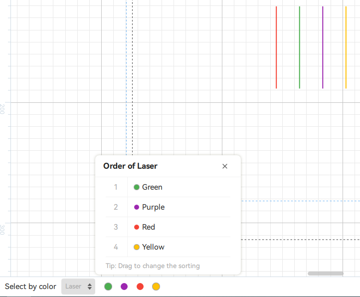

I am creating a project where the cut sequence is vital to not have semi-finished pieces drop through before the last cut is made. Luckily Suite seems to have integrated a new feature where you can (seemingly) set the laser sequence:
This is just a sample project to more clearly see the issue, but the sequence should be set to line: 2 - 3 - 1 - 4 according to the colors

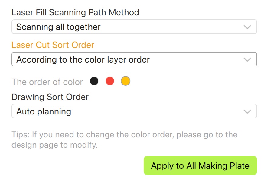

I realise this is an older thread, but it does work, it just defaults to auto order, which is wrong, you need to change it under the preview tab, then click the cog wheel next to the batch
then change laser cut order from ‘Auto Planning’ to ‘According to the colour layer order’
this will then process your coloured layers in order as per the chart
