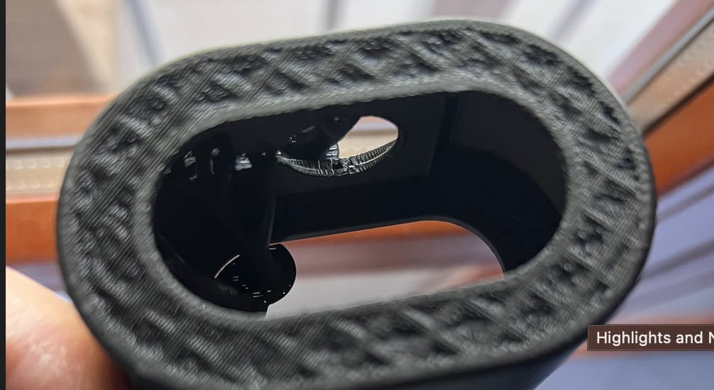

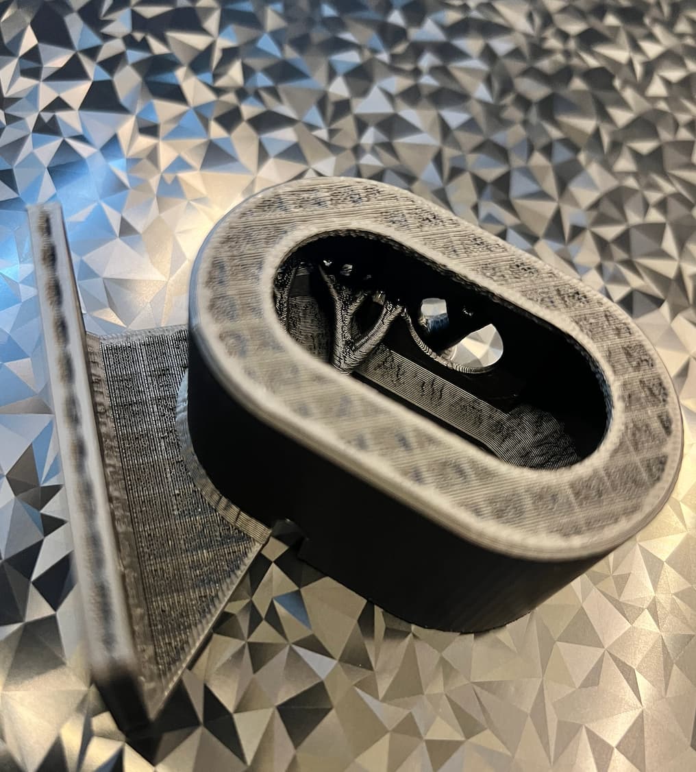

HI everyone,
i have a strange problem with my P1S the printing are coming out with las layer very thing that you can see the infill anyone understands what could be the problem ?
I have changed my hot end with a new one few weeks ago and now this…
this is with Bambu original PLA, and any model does the same thing.
I slice with Bambu Studio.
thank you appreciate any help !!

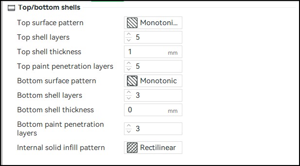

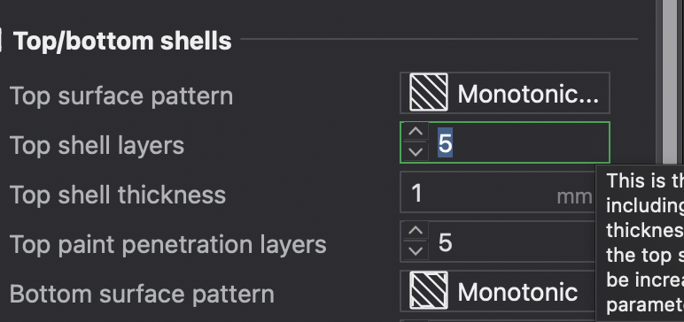

Ok, so how many top layers you choose when slicing. That could be the problem, only one top layer by default.
Just so you know I have only an A1 mini, so all my answers are based on my experience with it. I also use bambu studio for slicing.
I use standard value and is set to 5 I have never touched the setting I normally don’t play around and I had always flawless results…
Hmm, how old is the printer.
Could you also show me the whole section of the config panel for this tab of the bambu studio. The one with wall thickness and stuff.

Here is my P1S top shell setting.
It kind of looks like you aren’t getting the top laid down properly.
You can use the Preview tab to go down layer by layer and see each layer. I just threw a cube on plate, sliced it and counted each layer and there were five, just like the setting says, before the infill starts.
ok my bed guys sorry to waste your time, I was getting crazy on this but then I just realized I had the 02 mounted and I the 04 set. the printer is perfectly fine… thank all of you for helping …
