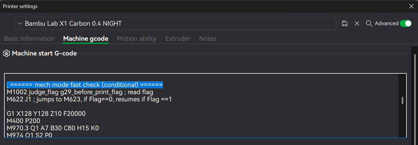

Hi Guys, i think i found a pretty neat work around!
So The Bambulabs checks a Flag befor bed leveling. You can toggle that flag before every Print. I Adjusted the Starting Gcode, so the Printer checks the same Flag before the vibration-check and skips it, if you have bed leveling turned off.
If you just comment the Vibration Check you need to resclice everything for night/Day-mode. With my workaround you can just slice your stuff and worry about the noise, when you start the print. This is especially useful, when you reuse Gcode.

where does this g-code go, I’ll probably find this useful
Just Up load the start G-code to Grok and describe the changes you would like it to make. Grok will generate new modified G-code.
-Uman
In your Printer-Settings, go to “Machine gcode”, the first Box “Machine start G-code”. Scroll down till you reach the comments
;===== mech mode fast check============================
----- gcode here
And grab the gcode from @Froduen and just replace yours.
Everything with a semicolon is just a comment. The important gcode is between those two comments. And the last line from Froduen with just M623 is also important, dont forget that.
YES. It works. Thanks Dude! :slight_smile:
