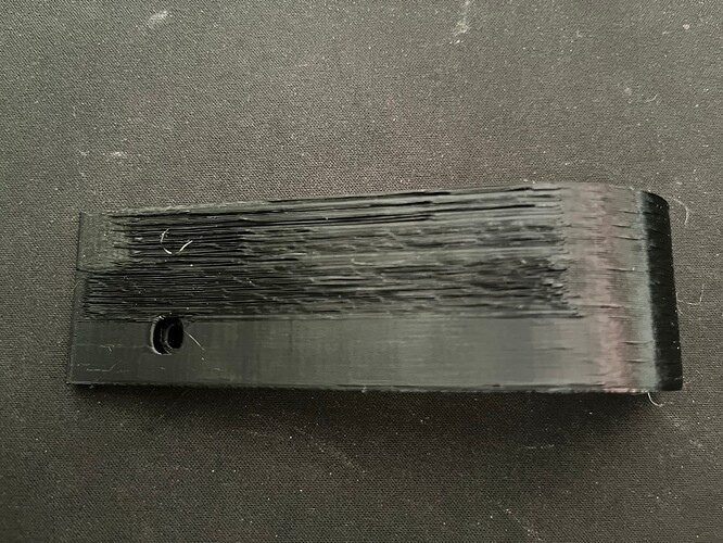

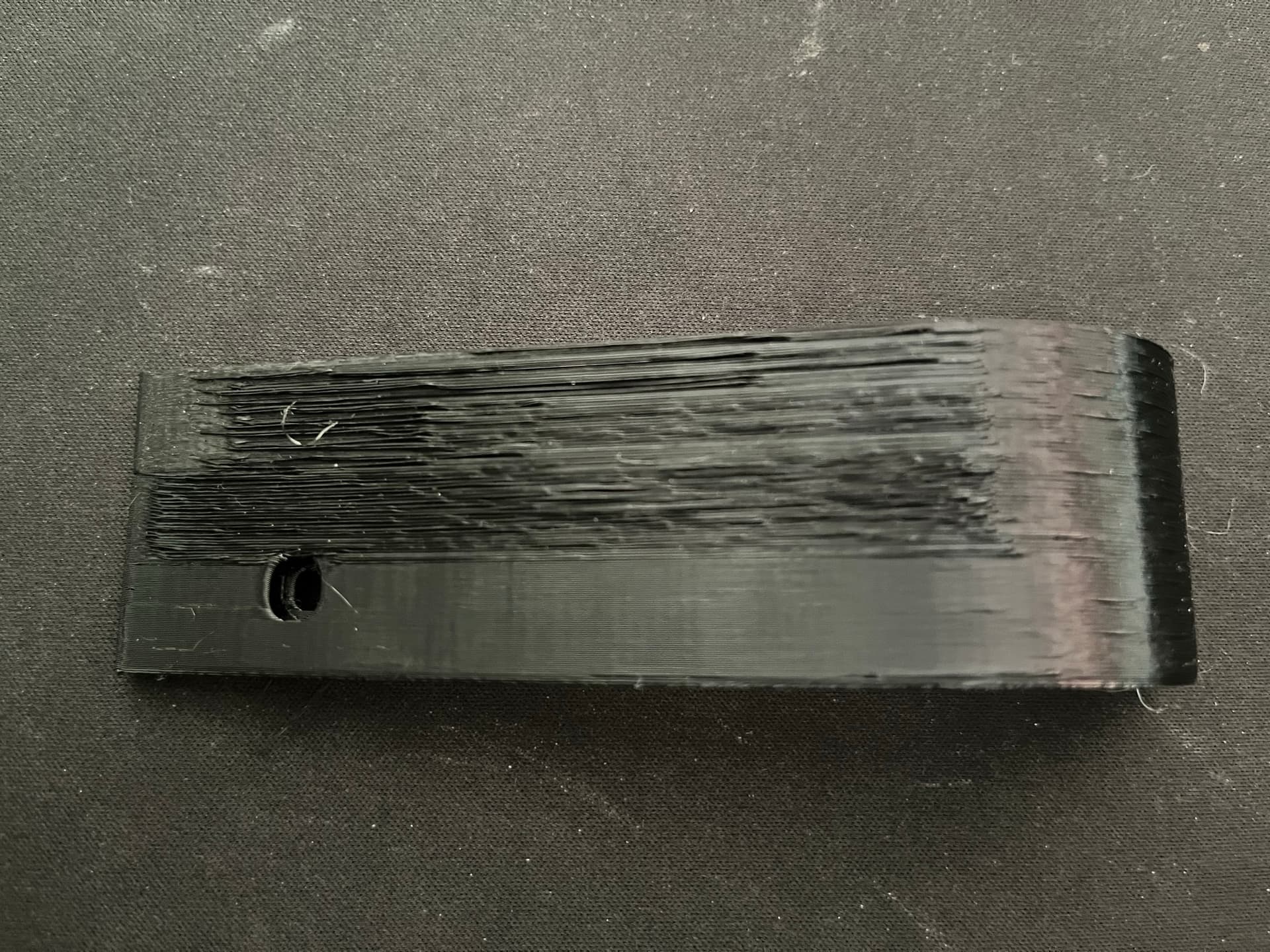

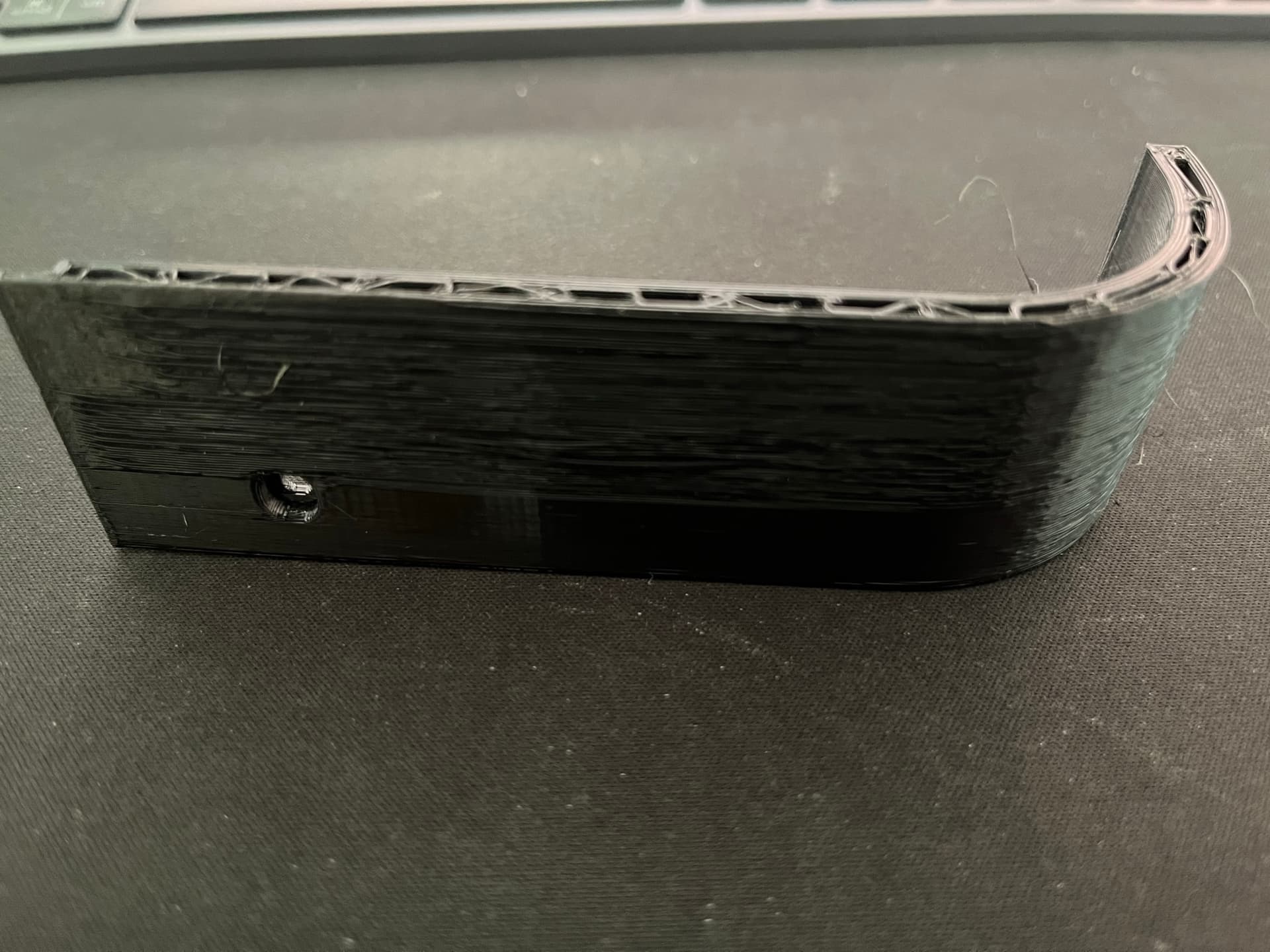

after assambling, my P1P did a very good performance and I was very happy with the print quality. But only for about 30 hours printing time. Since than, the results are horrible.
Does any body know what the issue of this could be? For me it looks like a total failure of motion system but I’m new in core xy systems. It is independent on the filament and slicer profile.
I would be very happy for any kind of advise what to be checked.

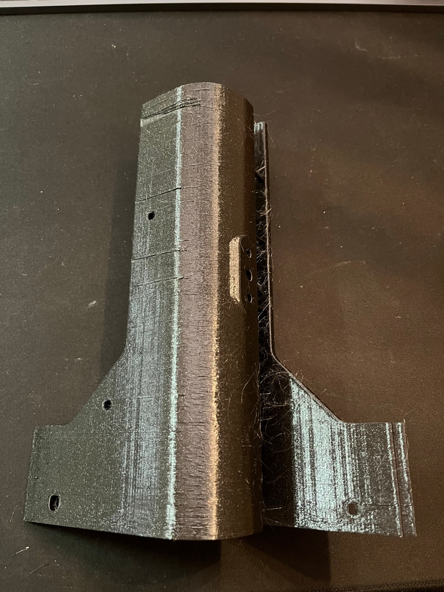

Same Part as before different angle:
Large Part: printed with Prusament PETG Galaxy Black

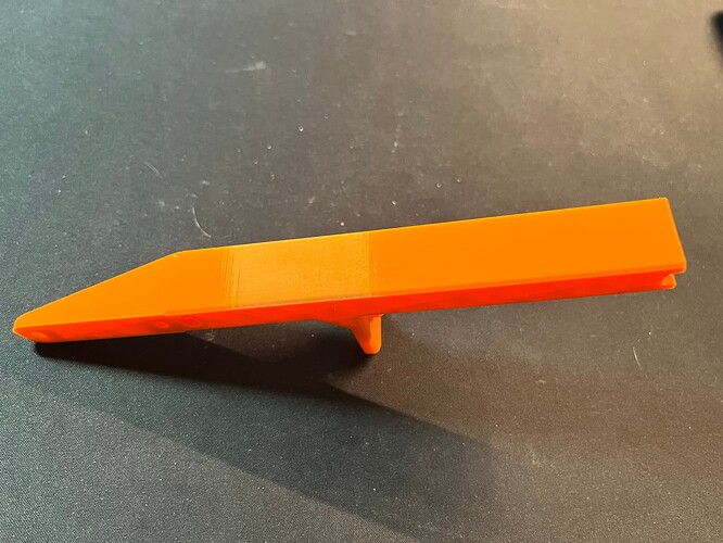

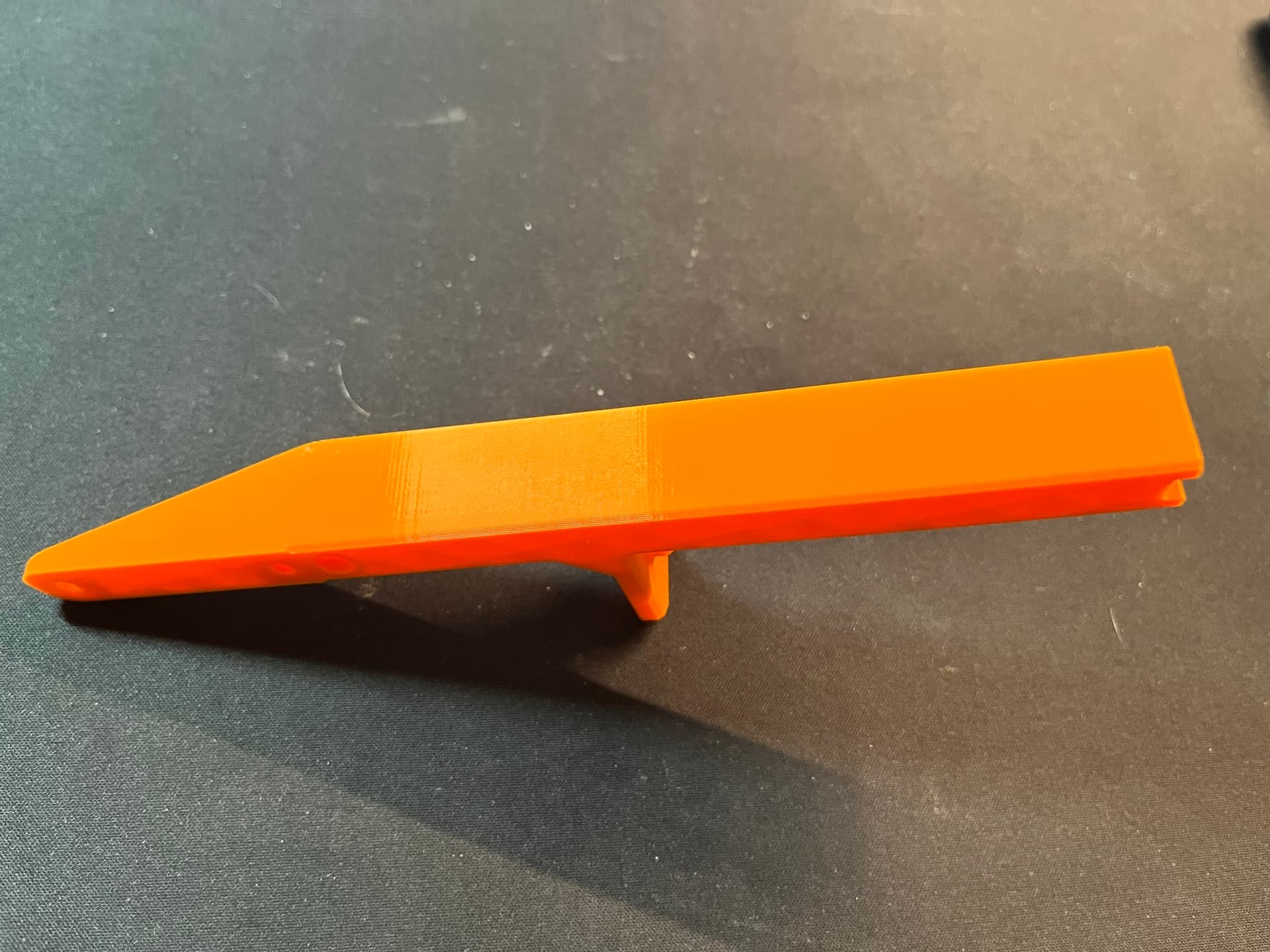

Orange Part: Before the issue from my perspective perfect. Material4Print PETG

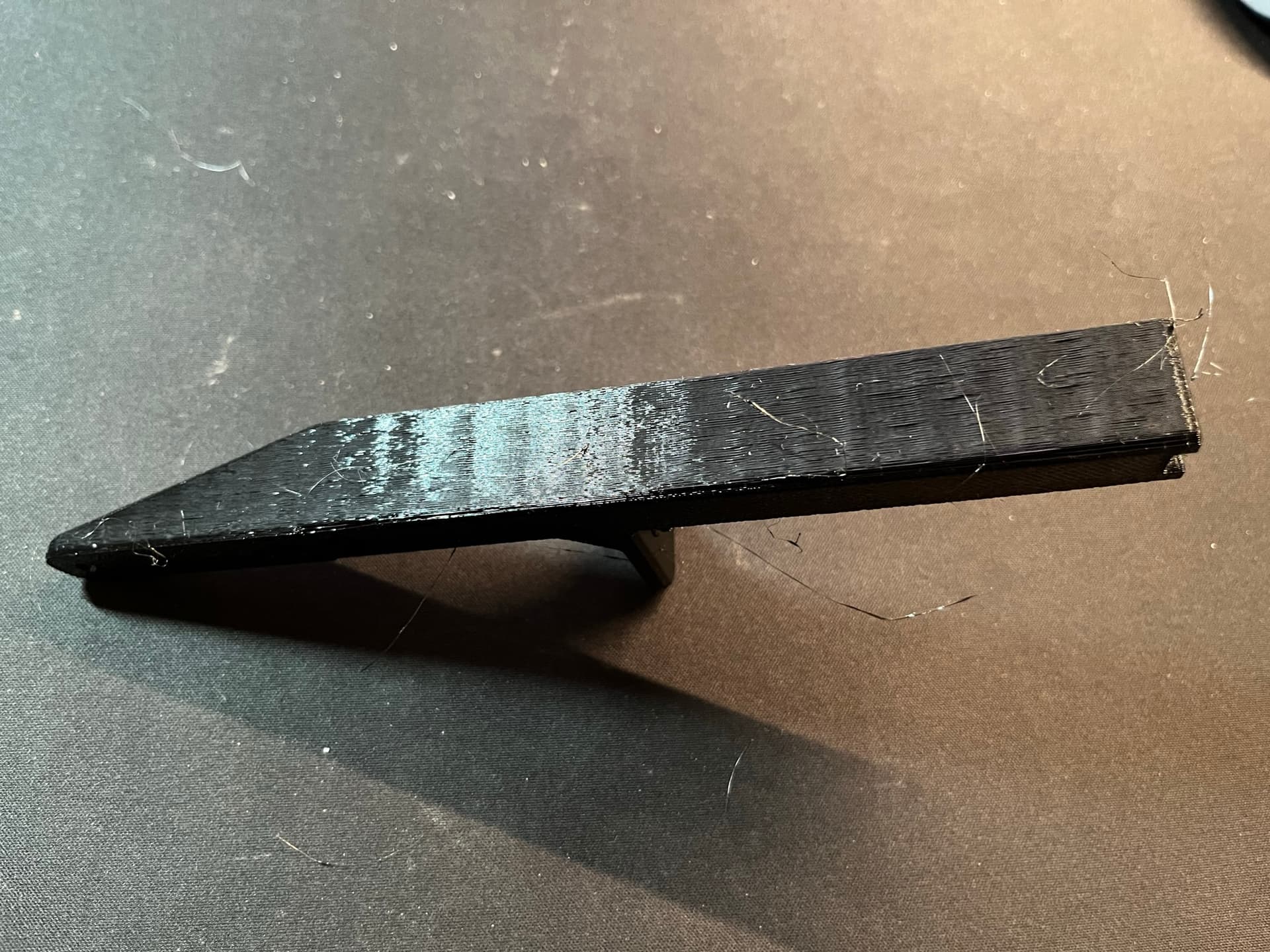

Same as orange but poor quality. Same Settings as Organge Part. Material4Print PETG
I most likly found the reason of why the walls did randomly looks horrible.
It seemed to be that the nozzle was bent a very little bit.
